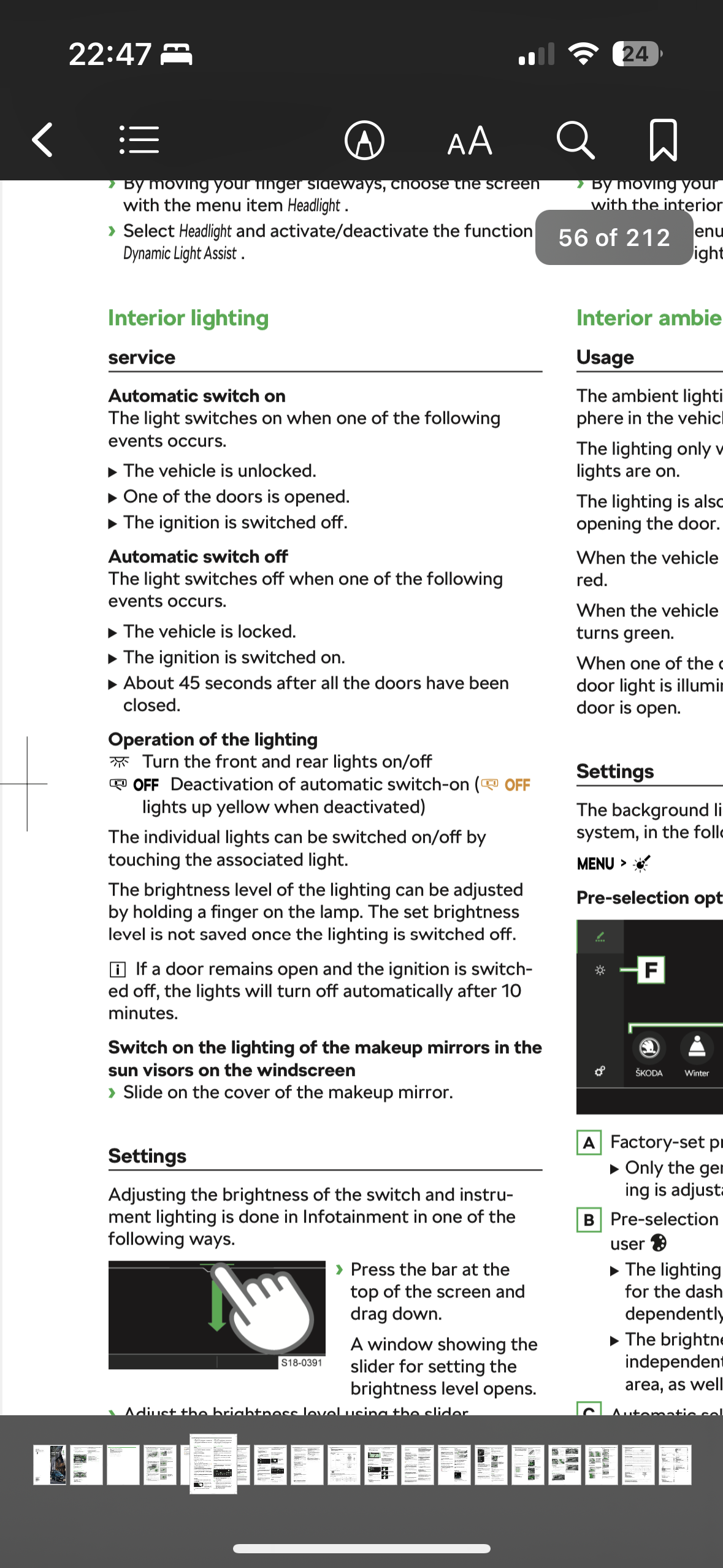

The interior lights won't turn on when I open the door, that's the overhead ones. The light by the mirror is on, saying they are off, how do I turn them.on. tried.most things... they do.work when I touch them..

This should help…
Thanks for the manual info, I have tried that... are you saying touch the lit up icon and they should work, as I tried that and nothing happened. Do I have a broken touch panel? It's under warranty, but don't want to look stupid going to a dealer for them to say you just do this.
Sorry for late reply.
Yes, the 'Car/open door' is a touch button. Should toggle between being illuminated orange (lights don't come on when opening a door) and not illuminated (lights do come on when opening the door). By the sound of it, could be that yours is faulty.
