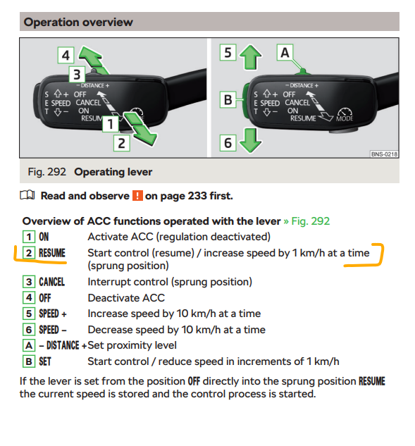

Like this using the resume pull (at least on my 2018 Superb)

Brettikivi. The rocker switch on the end of the ACC stalk permits changes of 1mph specifica;lly  I use it for speed reduction.
Ok, TIL. I will have to test this, don't usually touch the SET button after I hit it once.
I was wondering if the switch is somehow getting confused between the pull towards and the flick upwards. That could explain something, but not a jump from 63mph to 70mph. Would explain a jump from 63km/h to 70km/h, with the 10km/h detents.
I sometimes do flick "wrongly", I noticed that because it shows a x1 or xx1 target speed.
But yes, such large surge of speed unrequested sounds like a glitch.
