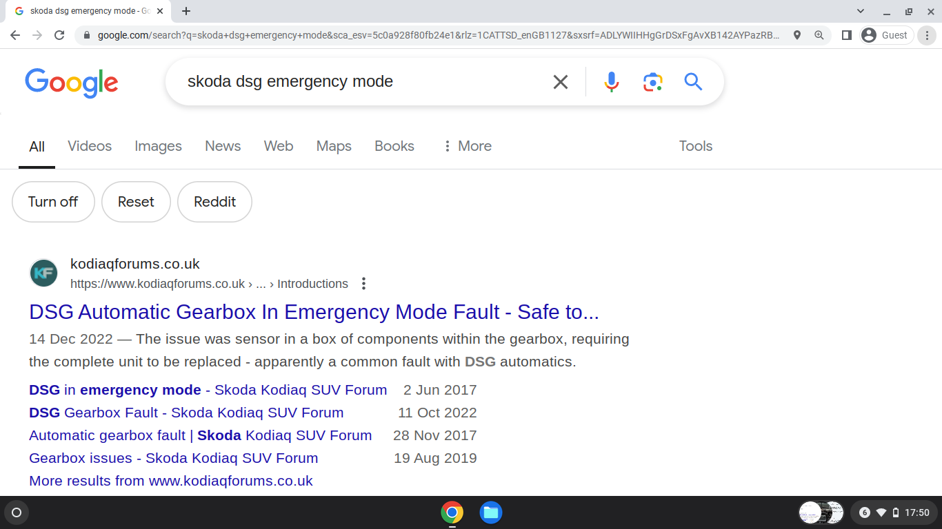

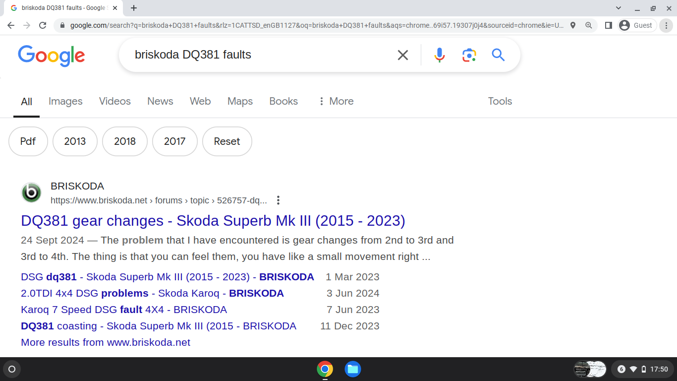

The failing MCU,s is getting more and more common with DQ381 DSG,s if that is what you have.
