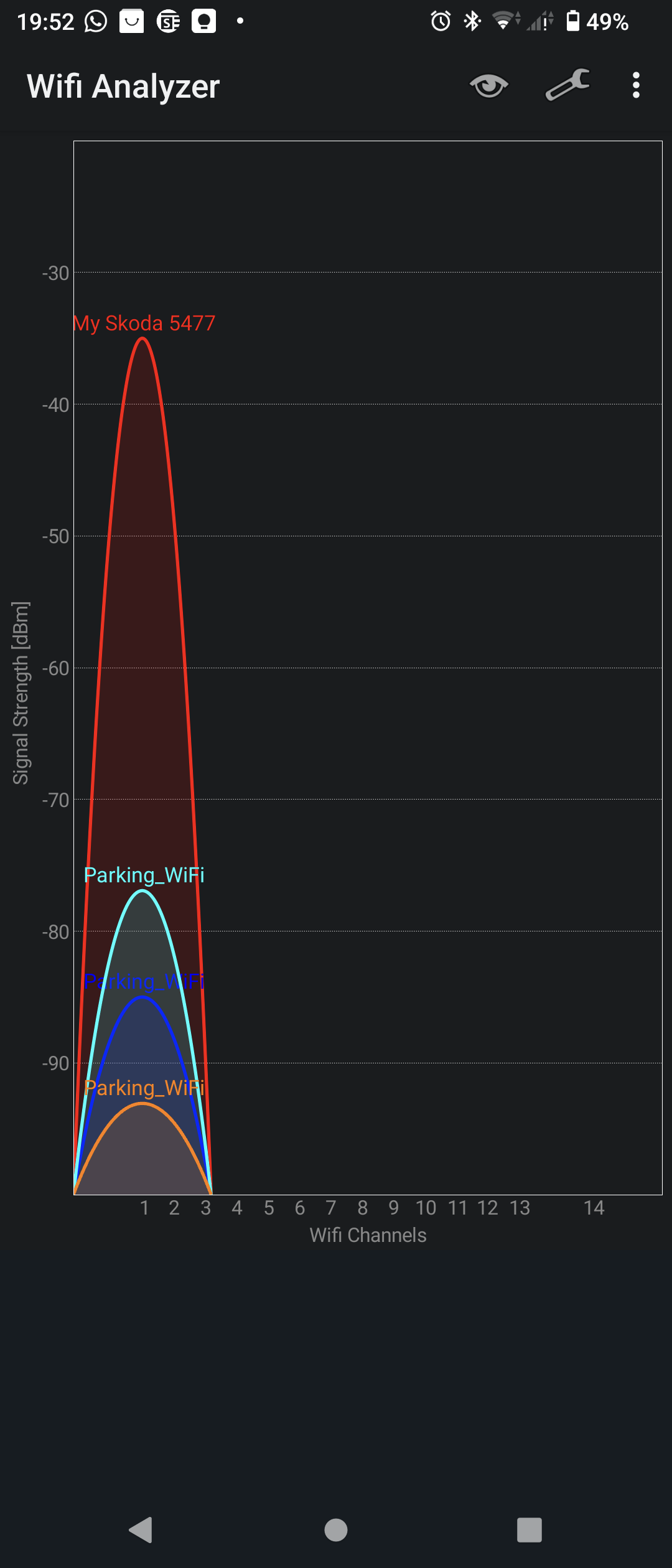

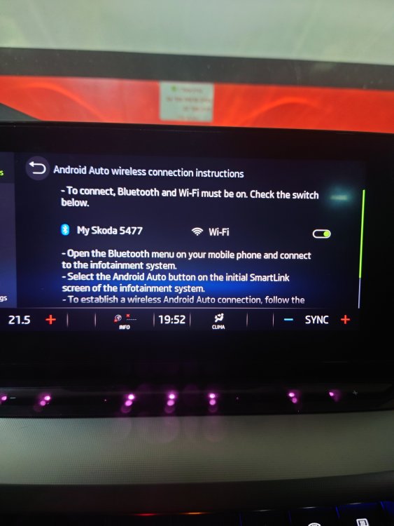

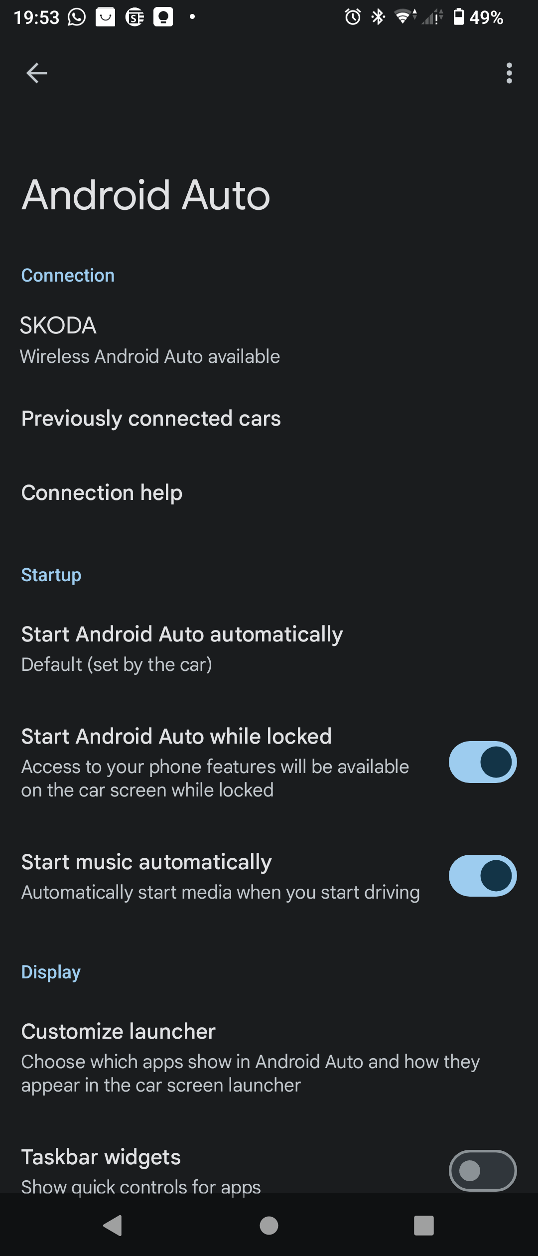

recently i bought secondhand Octavia 2021, with Amundsen MIB3 PR 8AR. For some reason, the system shows active hotspot, but only 2.4GHz, my mobile phone sees that wireless AA supported, but it doesn't work I don't see anywhere that somebody compalins on the issue, but here (https://eshop.skoda-auto.cz/en_CZ/smartlink-wlan/p/6VA054830B) specifically mentioned, that Smartlink WLAN is not intended for this specific part number 8AR.
So i'm wondering if may be somebody has Amundsen MIB3 with this specific PR, and managed to use wireless AA?
