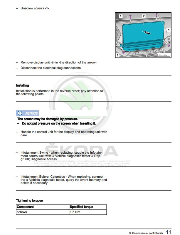

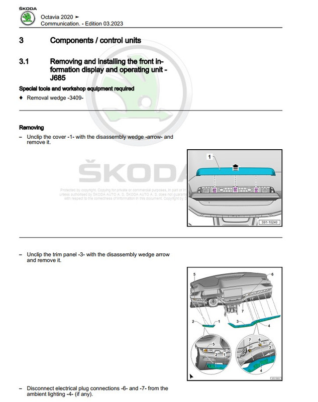

Dash trim removal
I've bought a replacement Columbus MIB3 unit and need to replace a broken one. How do I remove the trim below it so I can access the unit?
