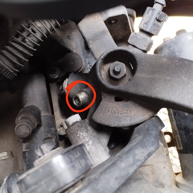

I see this on top of gear box should I top up with gear oil to see if helps or would I be causing more issues
Edited by DonkeyDick1992
You are going to make a mess if you try topping the gearbox up through that! Never top up something unless you know how to judge the correct level.

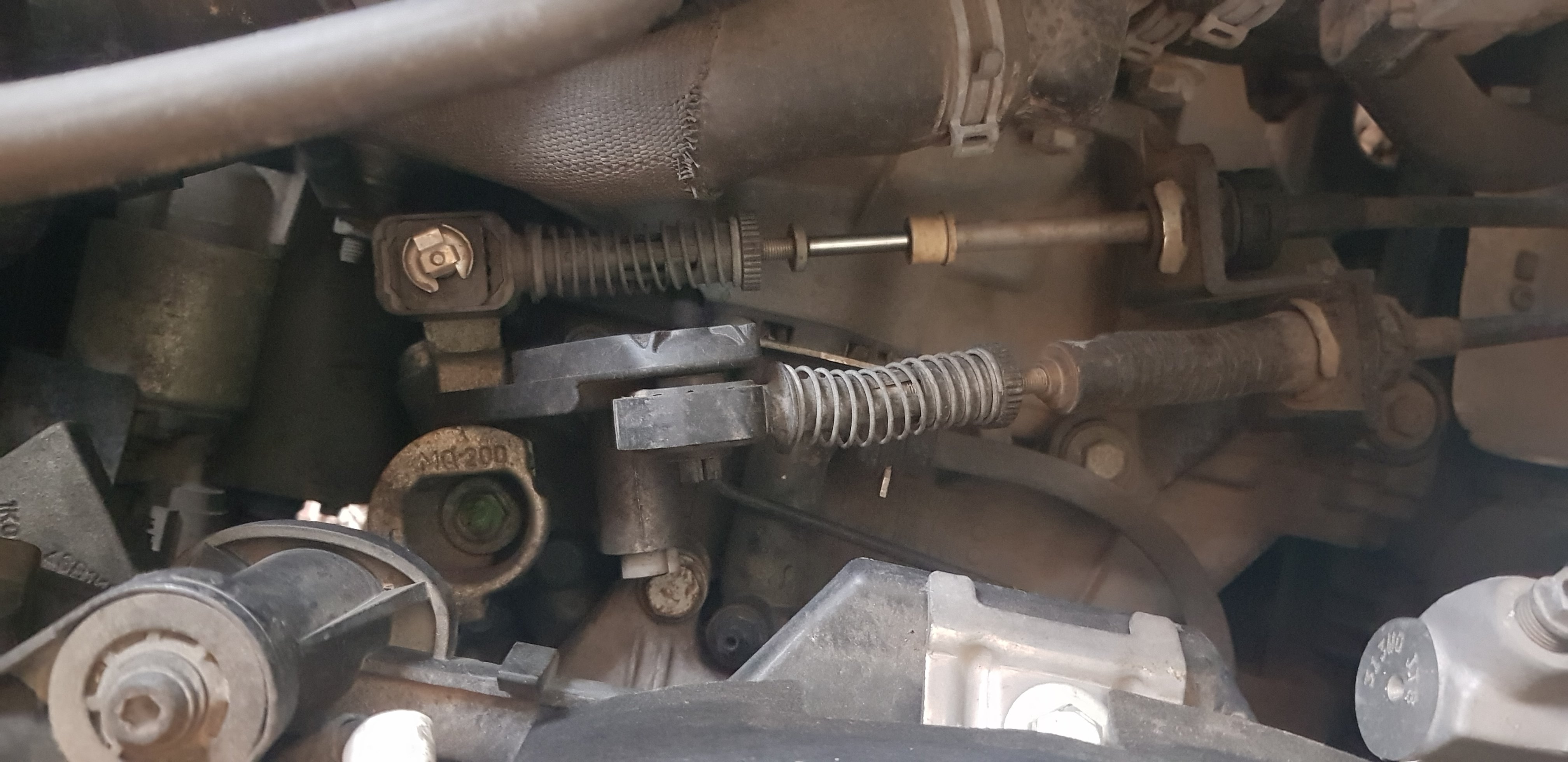

If it helps at all this is a photo of the linkages on my car, in neutral of course.

My linkage was always sloppy, it felt like a very old car, it was only when I removed the gearbox to replace the clutch slave cylinder that I found someone had been there before me, someone who threw away fixings when he could not immediately see where they had removed them from and left others finger tight.....................
When I came to remove the weighted quadrant shown in the first photo the nut was only hanging on by a thread and the quadrant was flopping around all over the place, after refitting the gearbox and tightening the nut correctly I initially found it harder to select gears, I had to be much more precise now the linkage had no play.
Something else to check on yours but from the photo it looks OK, some lubrication would not go amiss though.
