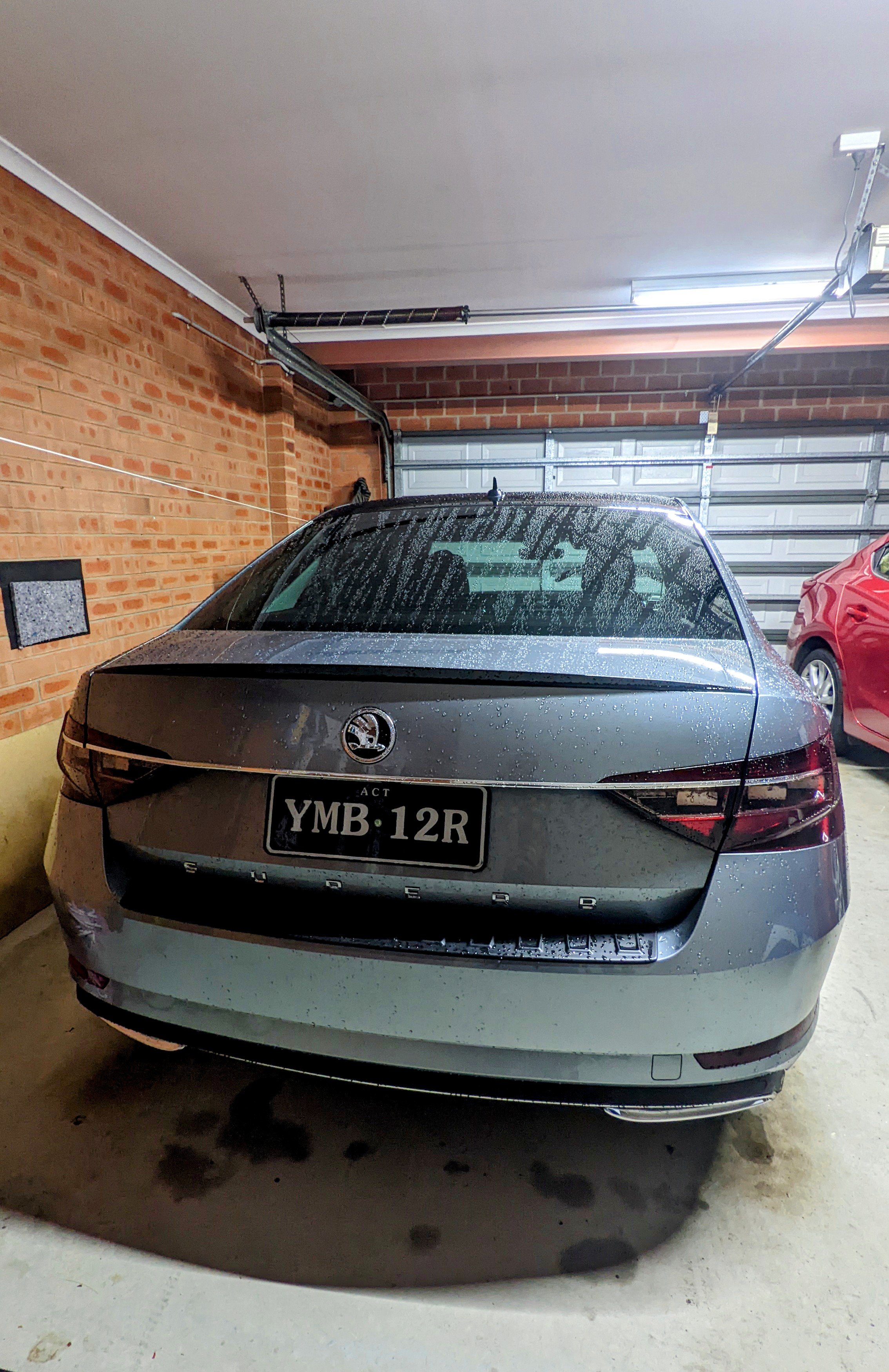

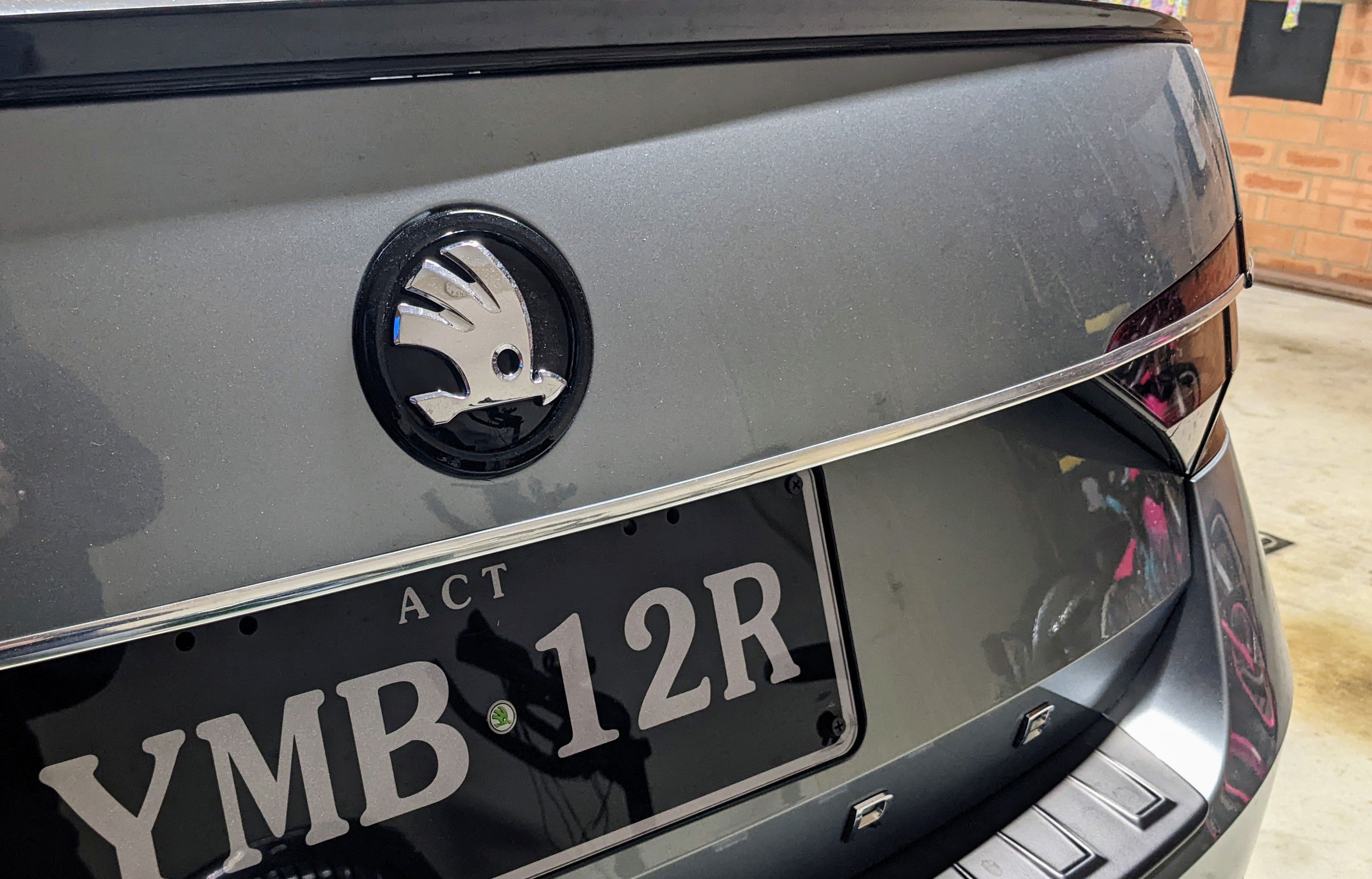

I wanted the chrome strip, but it was too expensive of an exercise, so I improvised and made my own chrome strip, using an L-shaped chrome strip trim from AliExpress.
It's been years since I did - still going strong and holding up well.

@JR RSi just wanna say you've built such an awesome looking superb it honestly looks amazing! and yes i would like to try the ali express one but i was just doubting wether i can put the strip on the tailight or not but now i know thx so much.

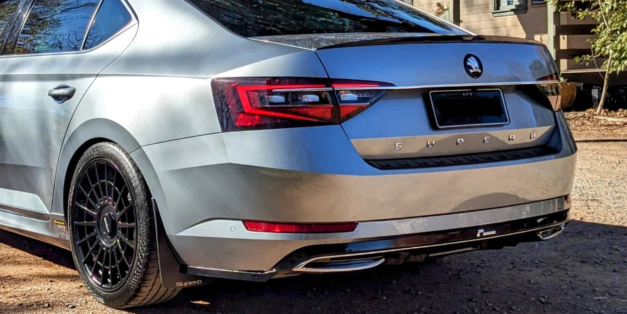

@JR RSwhat did you do to the bottom black plastic bit? Doesn't look stock and i kinda like it
it is the Sportline diffusor, which i vinyl wrapped in gloss black.
in the centre i have a gloss black diffusor "fins", from Kopacek.  Maxton also have similar designs.
nothing dramatic - just subtle changes, which is wat Gandalf is all about 🙂

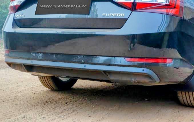

Hmm.. is it a sportline originally? If not, did it just clip into the original bumper?

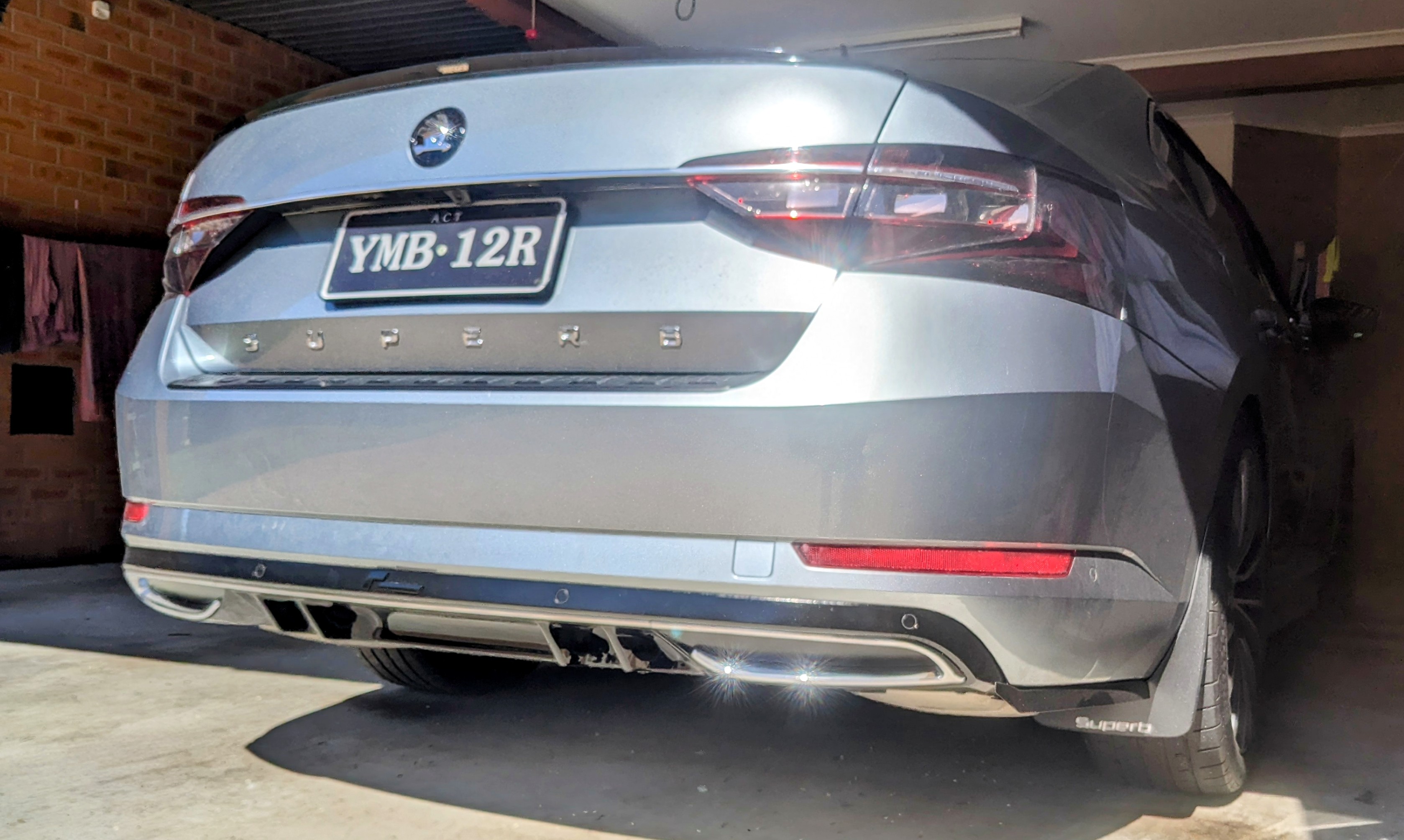

No, mine is not a Sportline.  It's basically a 220 L&K like.
It came with the boring black no frills lower diffusor - like the pic below.
Hence why I changed it straightaway for a Sportline version.

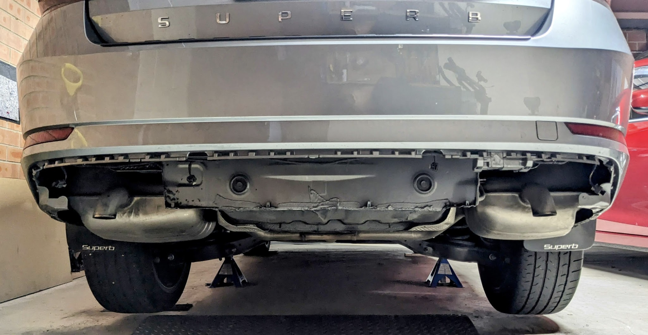

The whole rear black needs to be replaced.  It separates (unclips) from the bumper itself, which 4 torx screws at the bottom.
The rear parking sensors r located on the black diffuser bit - so these need to be moved.  Likewise if u have the virtual pedal.

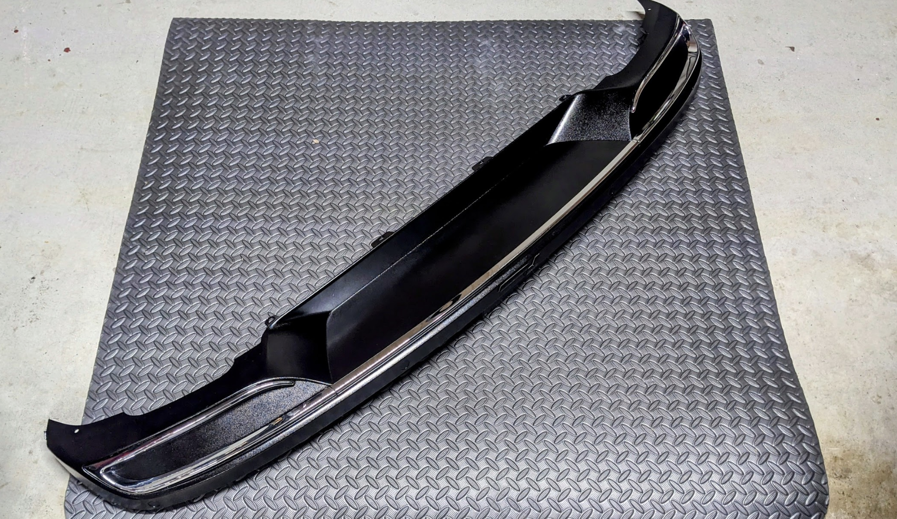

Pic of the rear Sportline diffuser seperated.
