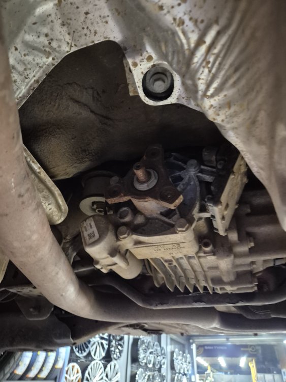

I've attached a photo of the rear diff - it looks like the connection for the prop is there, sooo should be ok?
That's not just the rear diff - that's the rear diff AND Haldex clutch.
Do some reading up - they use different oils and it's strongly advised that you also clean the Haldex filter.
Oho
So they're two separate units, and are serviced separately - I'll look into that
But assuming the diff is ok, it should just be a case of putting the shaft back on? How can I check the clutch, or are they generally reliable
