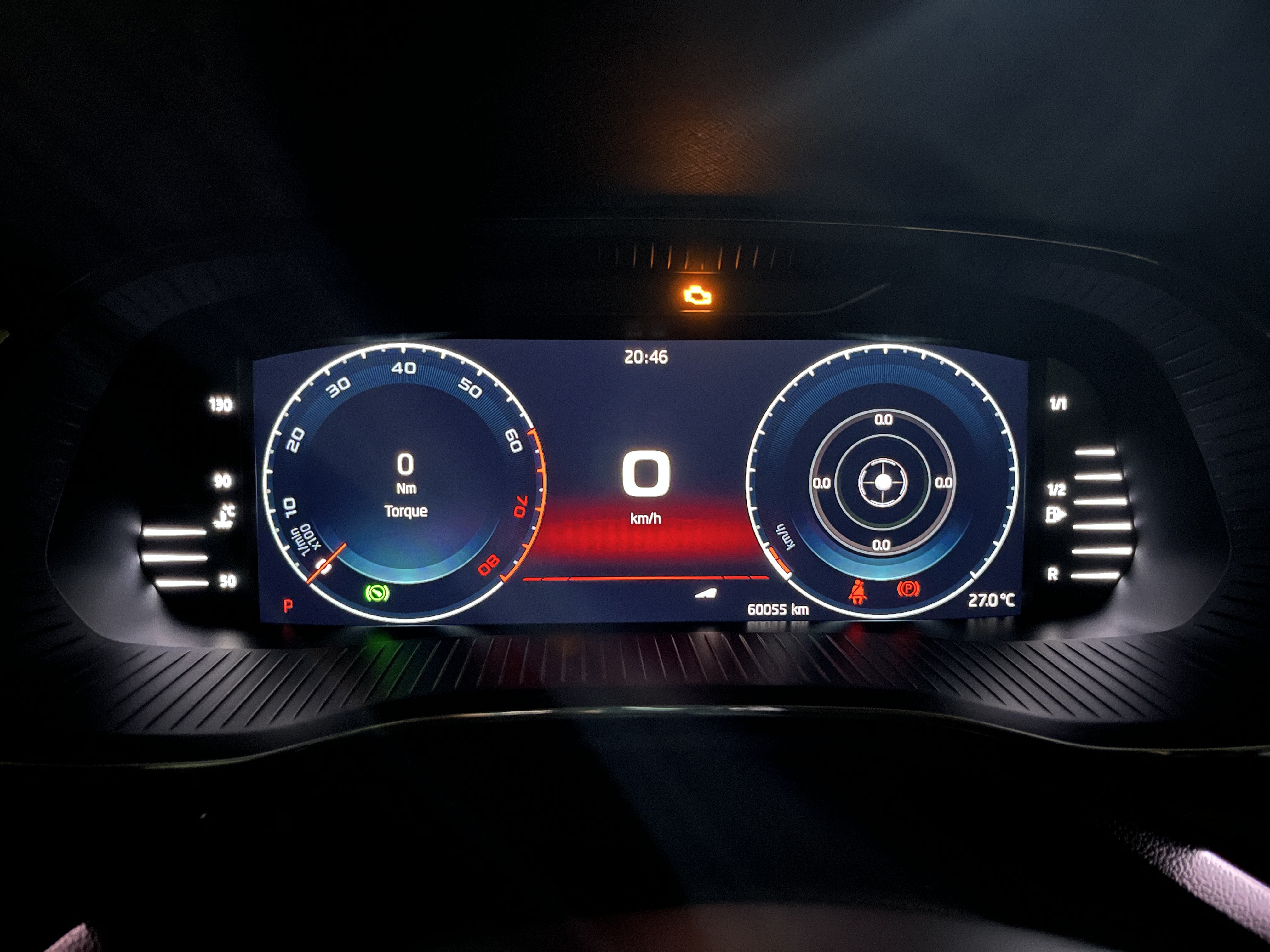

Instrument cluster does not show metrics
Hello all, my speedometer does not the metrics on the dial, is there a way to reenable it ?
What happened to disable them?
I did not, i bought the car like this
Numbers are gone only in this view?
Yes
I believe an update will be needed for the instrument cluster.
Looks like someone has had a play with coding before you bought the car as you have the G meter showing which can only be enabled via OBD11 etc…… So I’d say someone has coded the speedo to be plain.
Is there any way via ODB11 or VCDS to code it back ?
I think in...
Control unit 17
displayCoding:
Tachometer_extended_scale_division
Or:
Tachometer end values
Can look tomorrow what it is called exactly.
