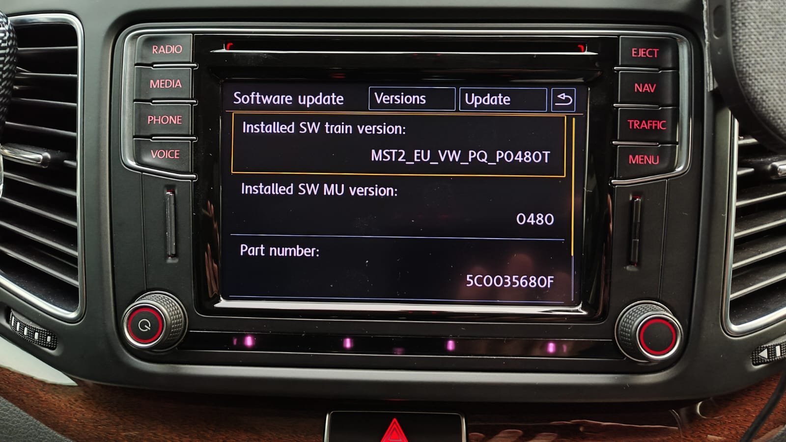

I made a mistake while activating FEC/SWaP code on my 5C0035680F, MST_EU_VW_PQ_P0480T using Car Scanner Pro.

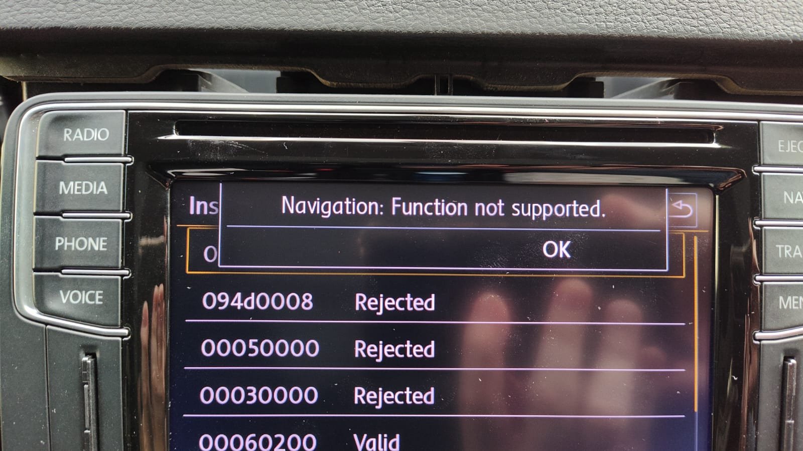

I mistakenly clicked on "Confirmation of installation changes" & after restarting the head unit (HU), I encountered an error:
Navigation: Function not supported.
I also notice the 4 FEC codes changed from Valid to Rejected.

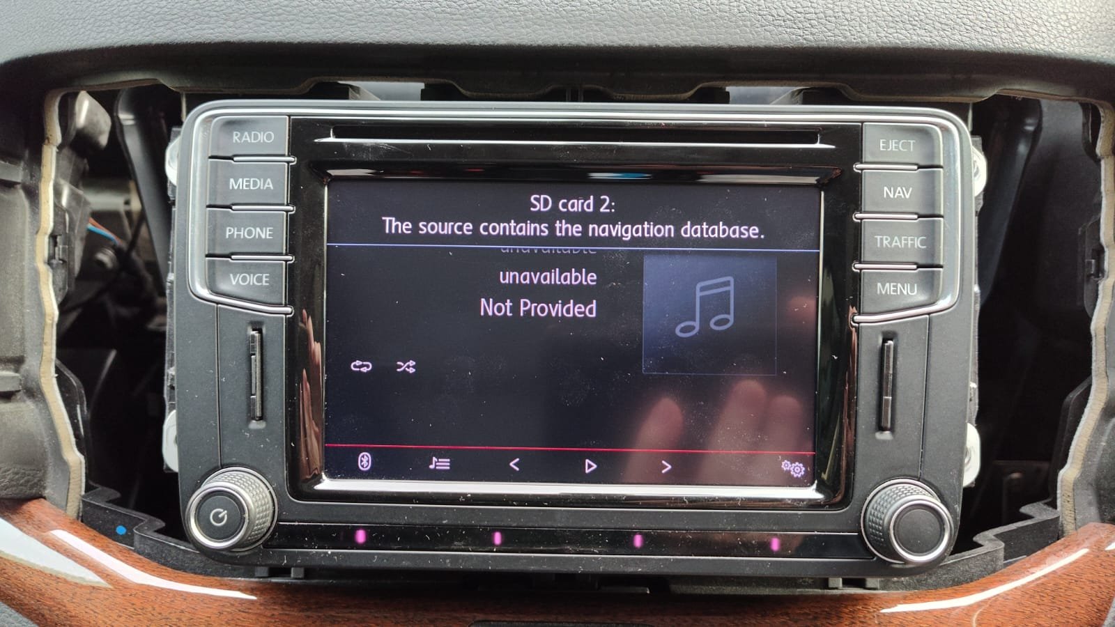

When I insert the navigation SD card, the HU recognizes it and confirms with a pop-up message:
SD card 2: The source contains the navigation database.

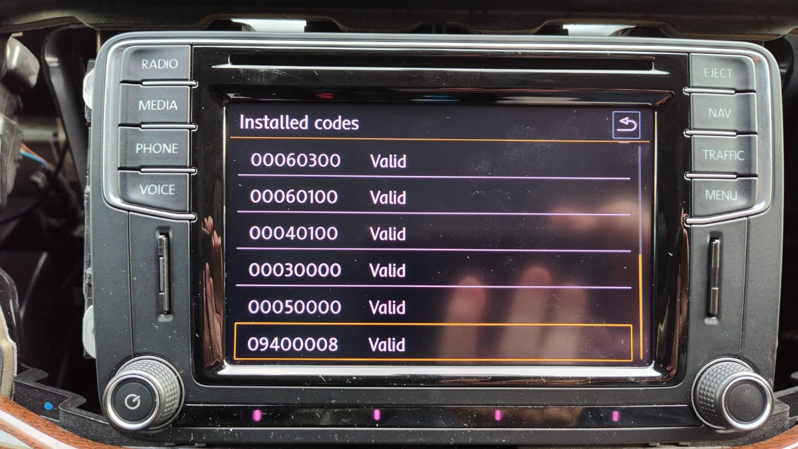

Thinking that the Rejected/Invalid codes are causing problems, I removed all Invalid & Rejected FECs but the problem persists.
The only thing I'm unsure about is the Navigation FEC.
My unit was preloaded with 094d0008 but I cannot find the respective decoded FEC in activate so I activated 09400008 instead.
Can someone help me generate the FEC/SWaP code for 094d0008?
