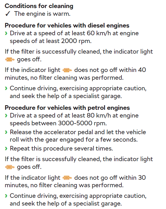

GPF. Gasoline Particular Filter.
AFAIK GPF regens are (unlike lower temp DPF) passive. From memory, GPF's only regen at high temperature, so surely this wouldn't affect the idle on startup?

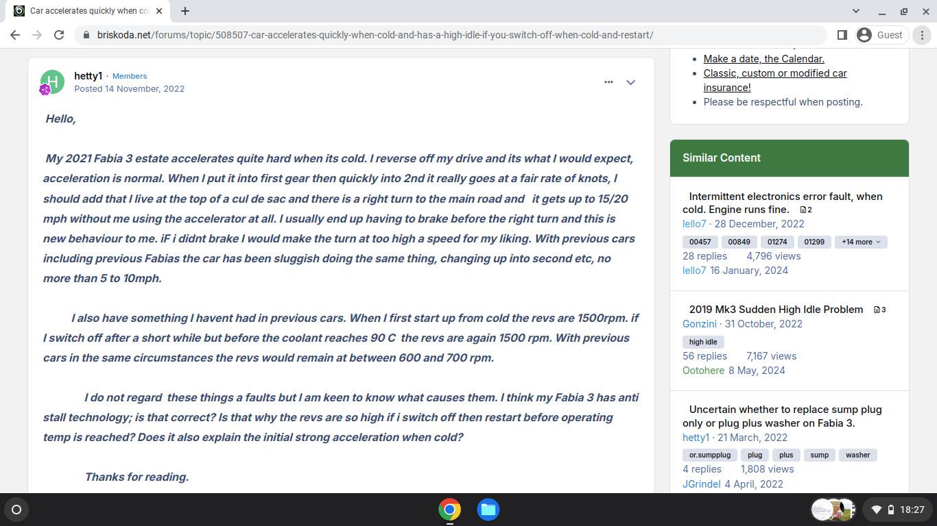

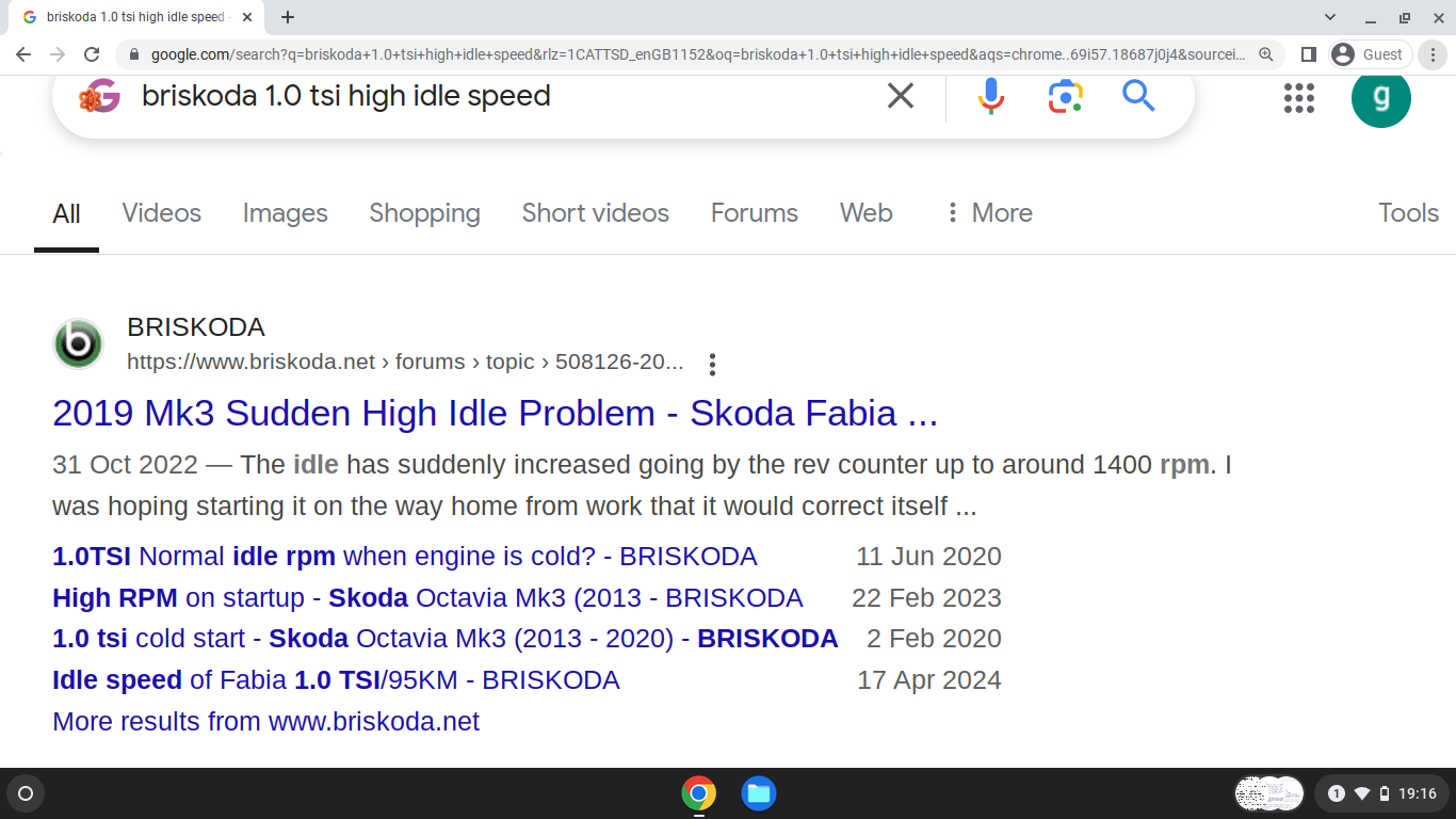

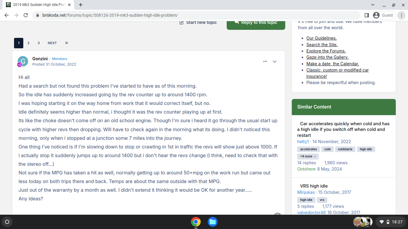

Generally, you'll start with an idle speed of 1200-1300rpm, before it drops to 900ish. Has the car been into Skoda at all? I know there was a software issue with a higher idle being used (at cold start) to help with the kangarooing issue.
I'd also take a visit underneath the steering wheel to the OBD port and see what the car is saying - could be PCV/O2 sensor/vacuum leak/etc, some of which might not show up on the dash, as the engine might not think anything is wrong. What is the MPG like @Sensayuma? If you have an issue that is causing a high idle (beyond GPF, etc) then it would likely also result in lower efficency.

But it is as well reading the threads of those that had the 1.0 TSI,s with GPF,s doing high idle speeds.
No GPF light on or anything. but the High Idle speed and car running away from them.
Not a regen which is done with high temp and lifting off the accelerator and during deceleration.
