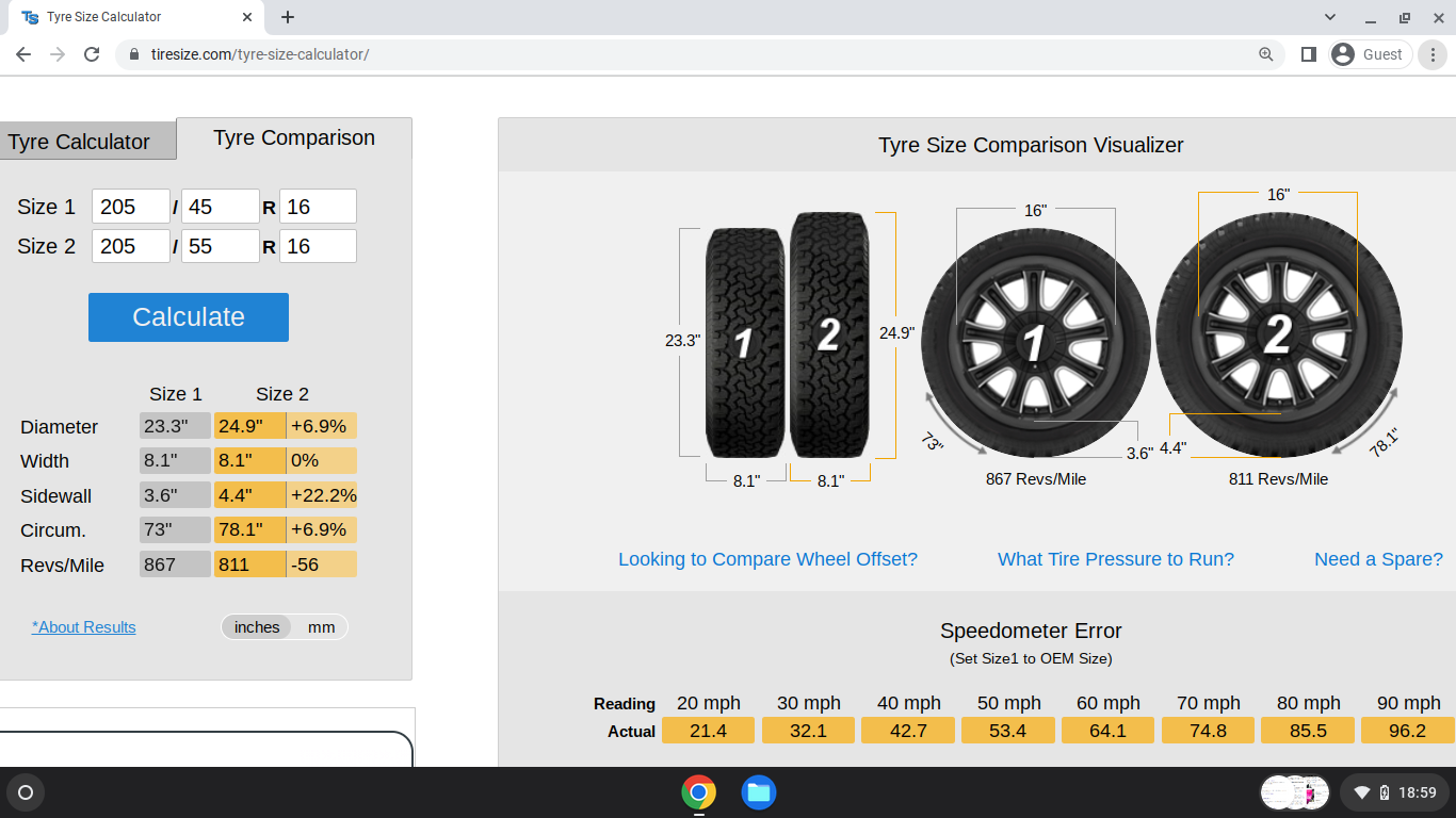

20 minutes ago, Bellagio940 said:
Evening! Simple question I hope. My car is shod with the recommended 205/45-16 tyres. I’ve the chance of a set of 4 205/55-16 tyres, would these slightly higher profile be ok safety wise and would they pass an MOT please?
Thanks in advance 😊
The outside diameter of 205/55R16 is far too big for the Fabia MK2. The gearing will be too high, it is likely to rub, and the speedo will under-read.
Outside diameter of tyre
205/45R16 590.9mm
205/55R16 631.9mm (6.9% bigger outside diameter compared to 205/45R16)
