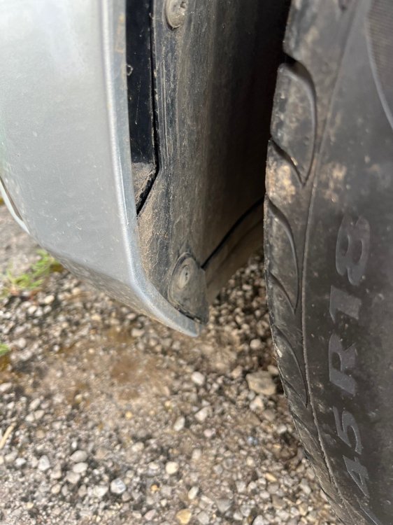

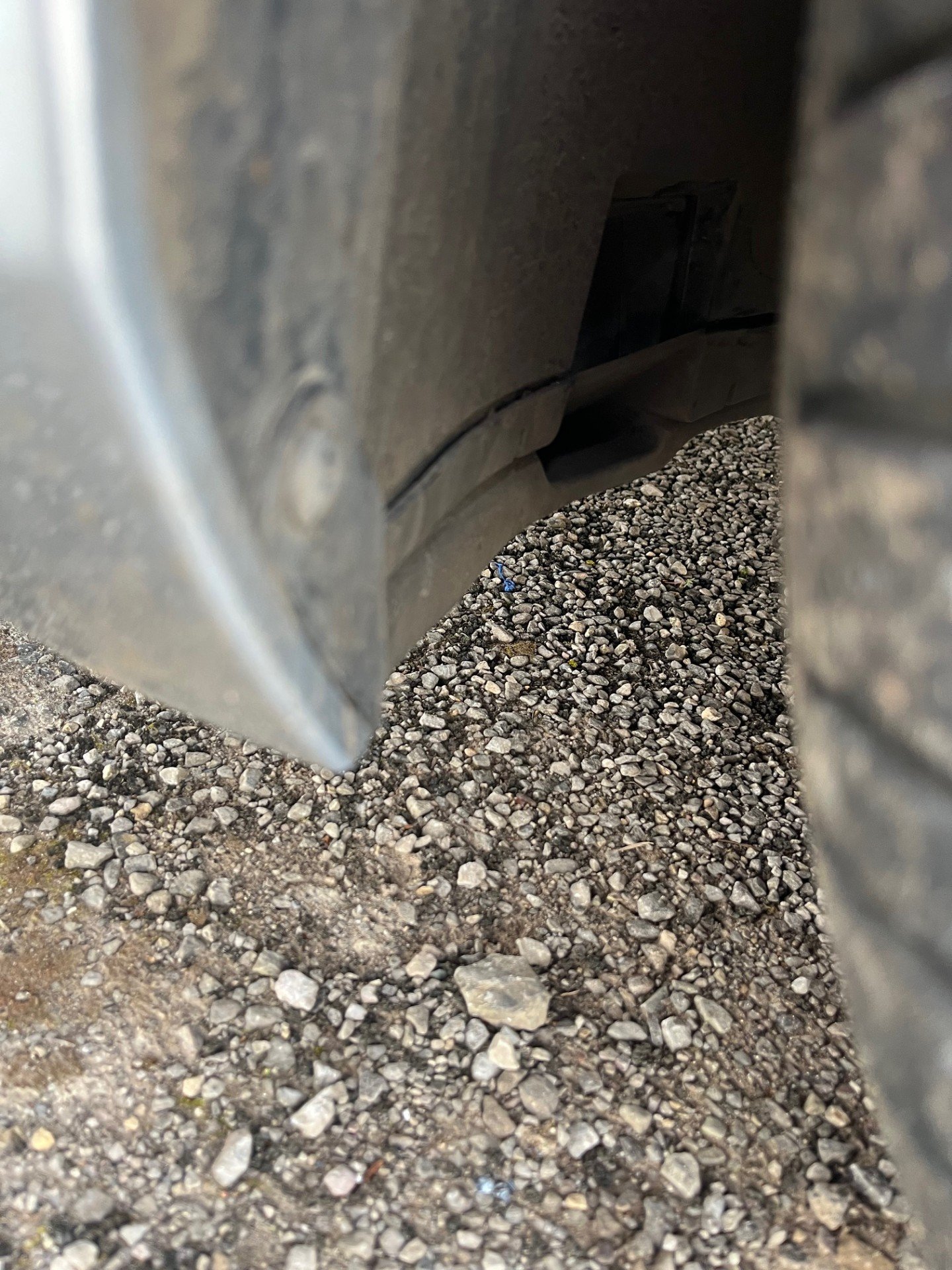

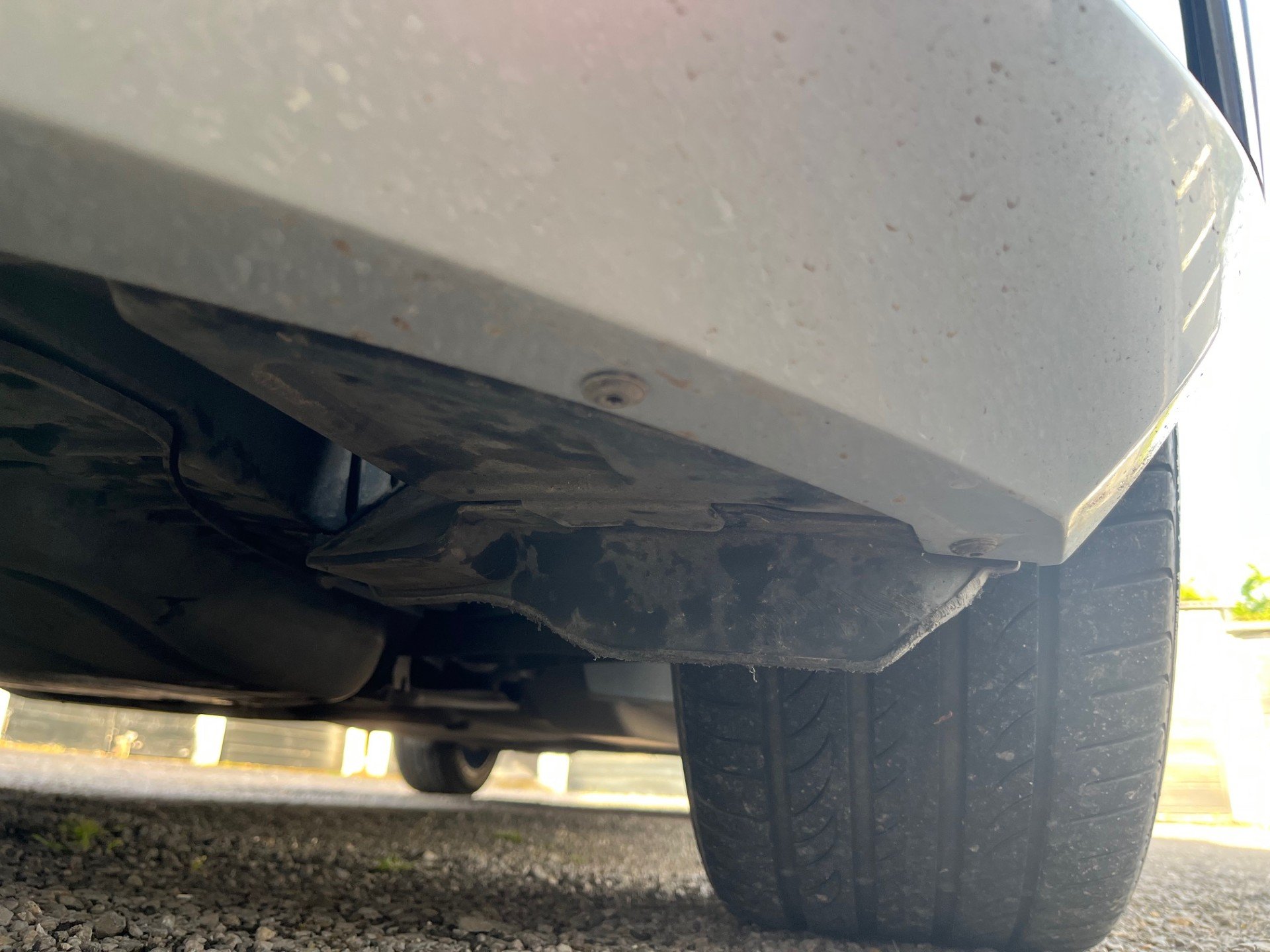

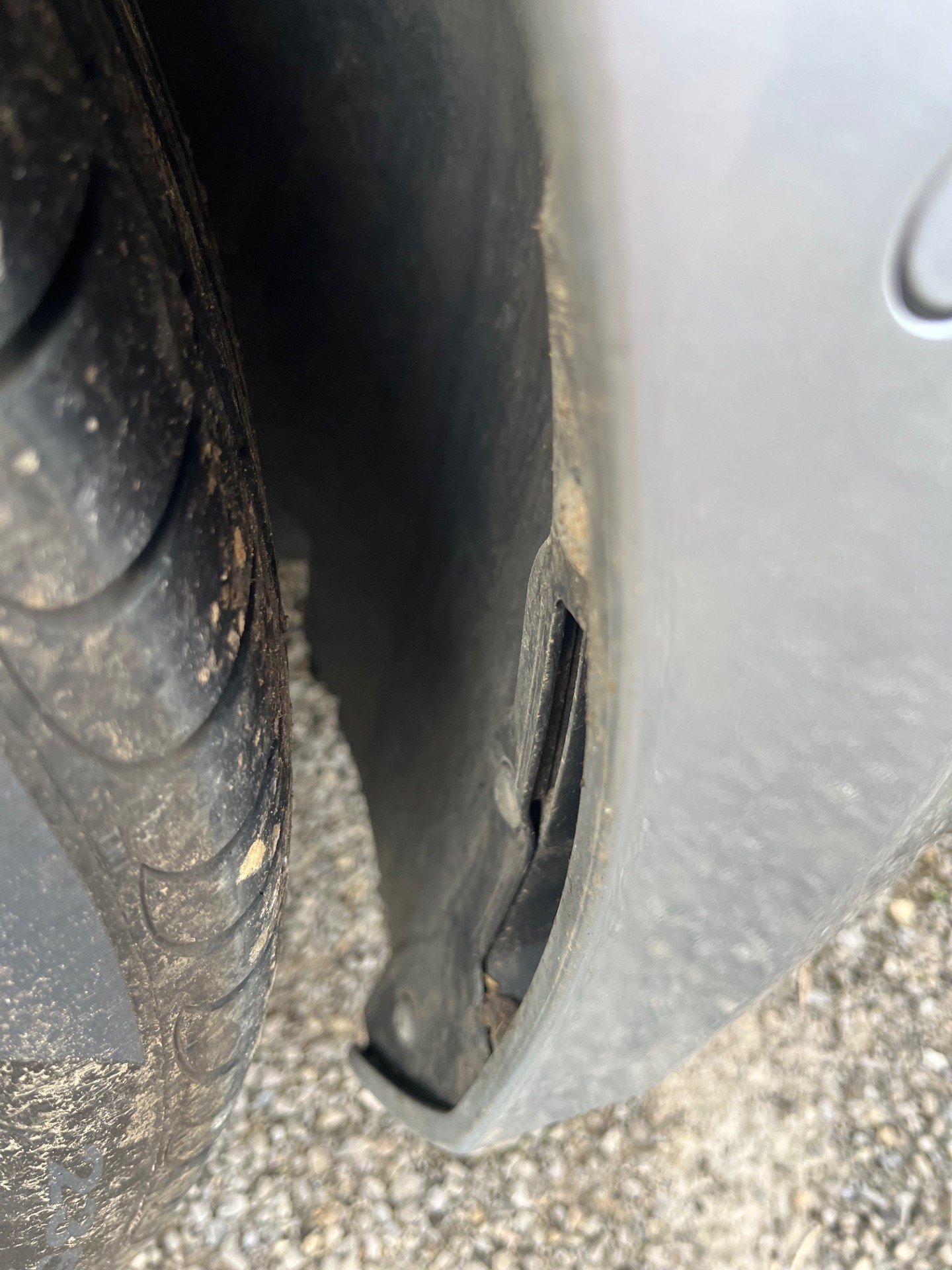

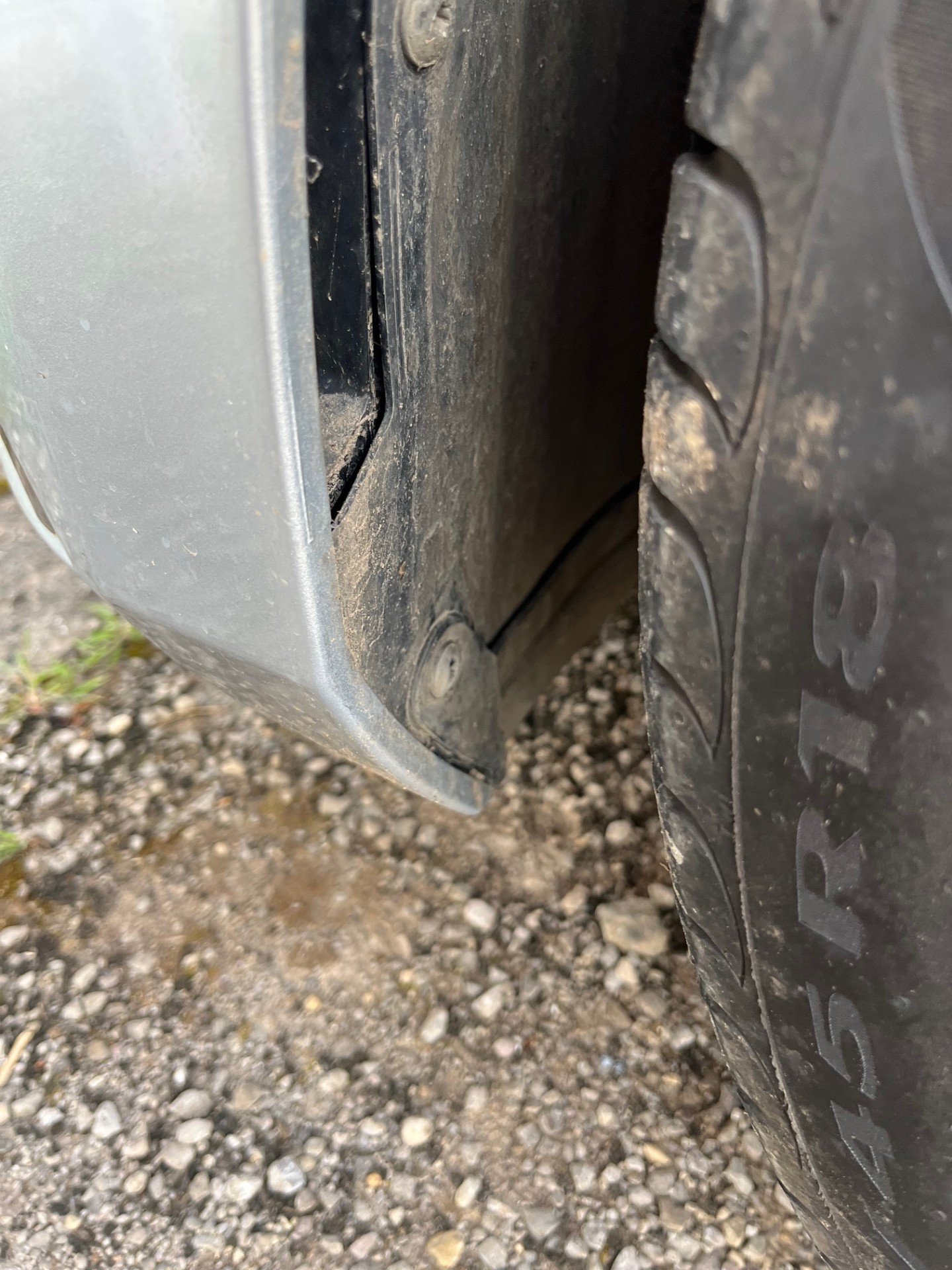

I am trying to identify what the trim is on the bottom of the front bumper, in front of the front wheel? I ask, because I notice I have it on the passenger side, but not on the drivers side. I'm assuming it is something to do with brake air flow, but that would also lead to the assumption that I am missing one! The missing side doesnt have a snapped fitting or anything, its just totally absent. Any help identifying what it is called and/or a part number (If its meant to be there of course) would be really appreciated. If I am meant to have one....... how urgent is it to replace?
First 3 pictures below are the of the one that I DO have, last two are on the side without.
Yeah, ur definitely missing it.
It's a front "spoiler".

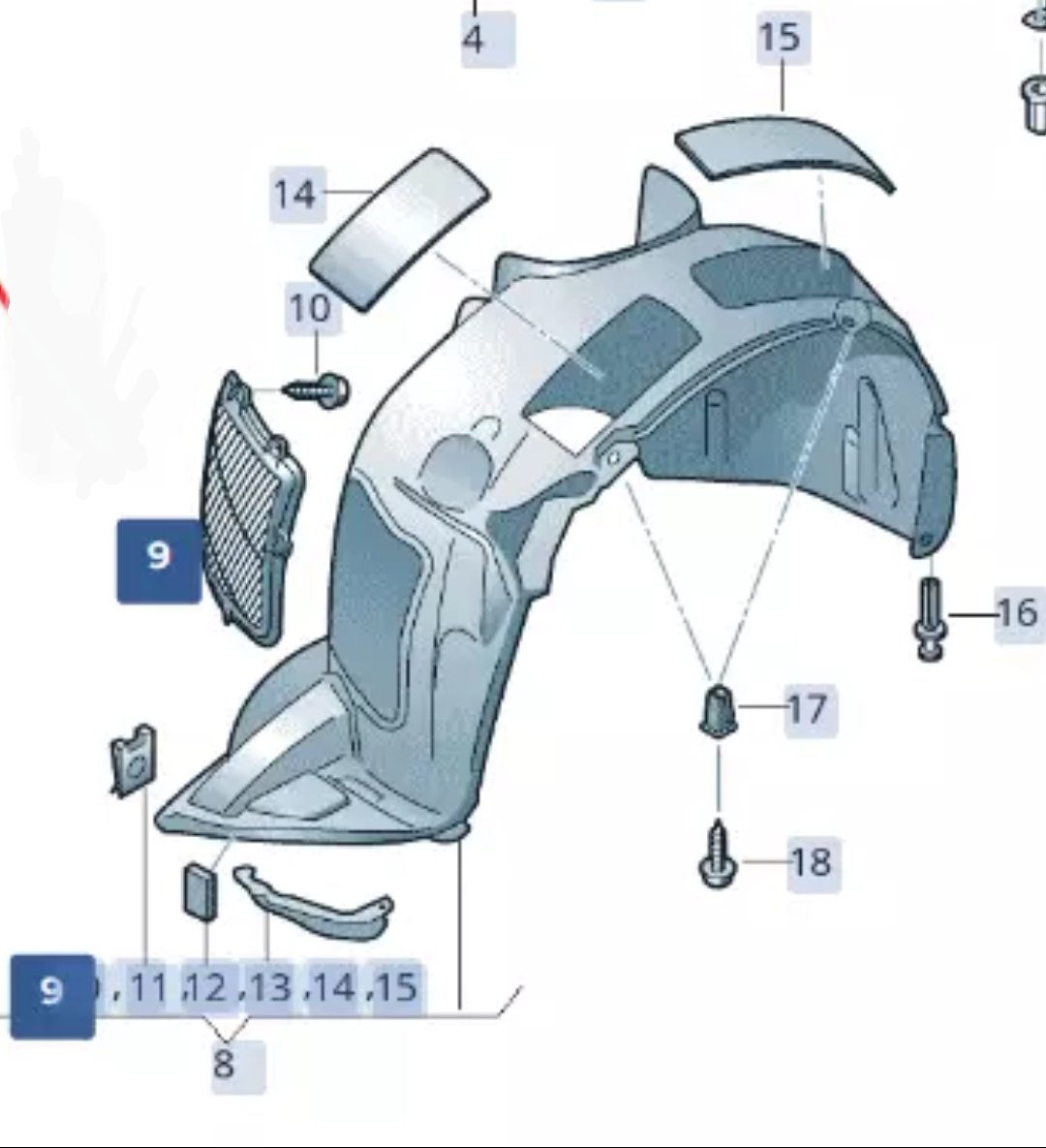

It's part of the front wheel arch liner - Item #13 in the image below.
Part number is 3V0 853 887 B
Looks like urs went missing when the front wheel arch liner, or front bumper, was removed.
Ah brilliant. Thanks @JR RS ! I kept using words like "vent" when searching and didn't think to use spoiler.
Just ordered the part. Will hopefully be a straight forward process to install when it arrives.
It's very easy to install - simply slides into the wheel arch lining groves.
