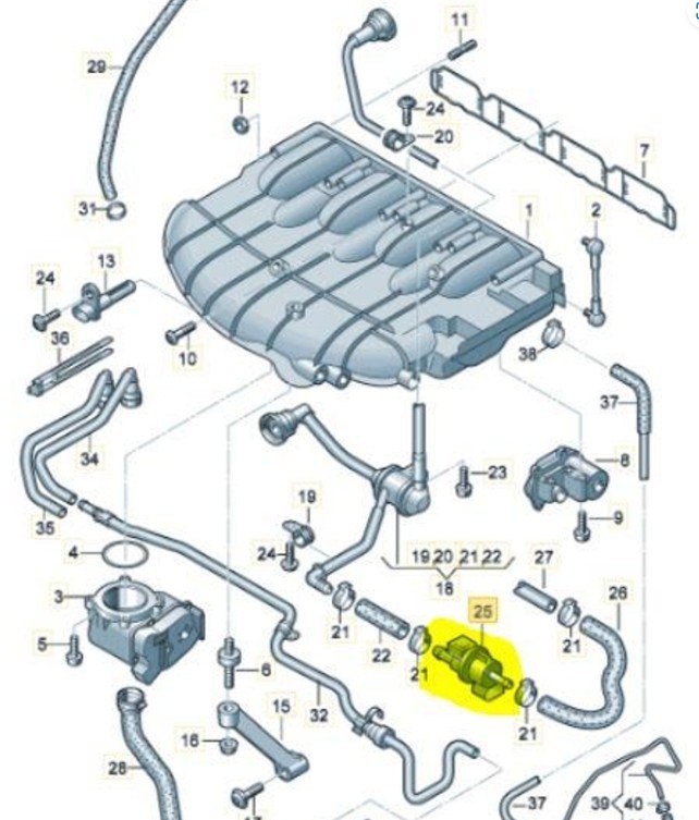

Would you know where the purge valve is on the 1.0 engine. I had a look and tbh I couldn't see it , it's the wife's car and I've had a quick look, thanks for responding
Sorry, I drive a 1.5 but the valve will be somewhere in the inlet tract. The intent is to suck the fumes out of the carbon cannister.
Pic below might help.
