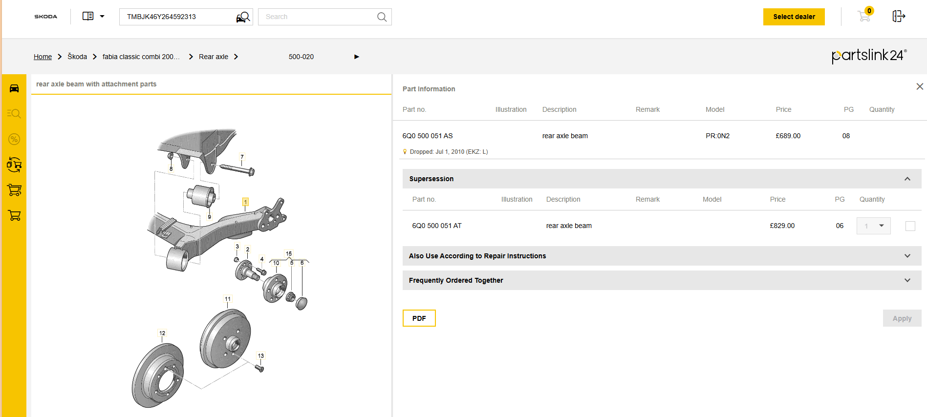

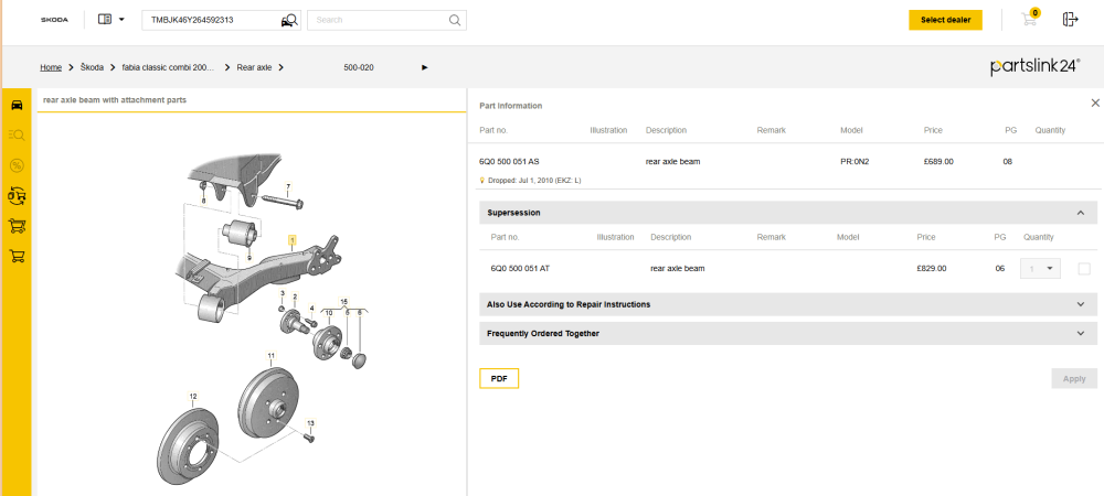

Understood, part of the issue will be that I can't read the part number on my existing axle due to the corrosion. Is it possible to find it from the VIN do you know?
Yes. Or reg number.
Tomorrow though.
If you are able to find it, that would be super helpful. It's TMBJK46Y264592313. Thank you!
Here you go.
