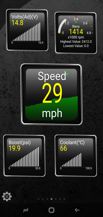

May be worth looking at real time data reading. I have used Torque app on an Android phone which allowed me to review boost pressure. You must remember that the car should be pulling when reading boost rather than just revving while stationary.
