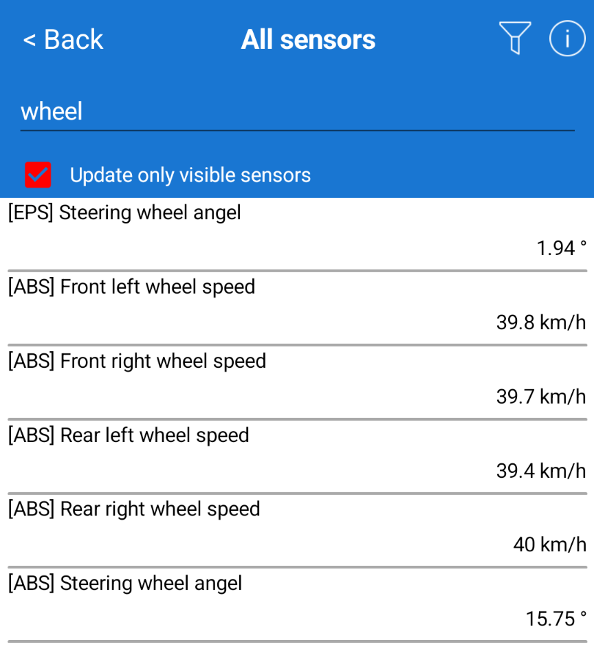

After fitting and reconnection, the ABS light & Tyre Warning Light were still illuminated.
However, after driving above 30kph both lights disappeared & there are now no faulty at all displayed in the infotainment.
I checked with Car Scanner & the Right Rear Vehicle Speed is now correctly displayed (before it was reading intermittently but mostly 0kph.
Another simple(ish) correction saving me a fair few hundred francs...!
