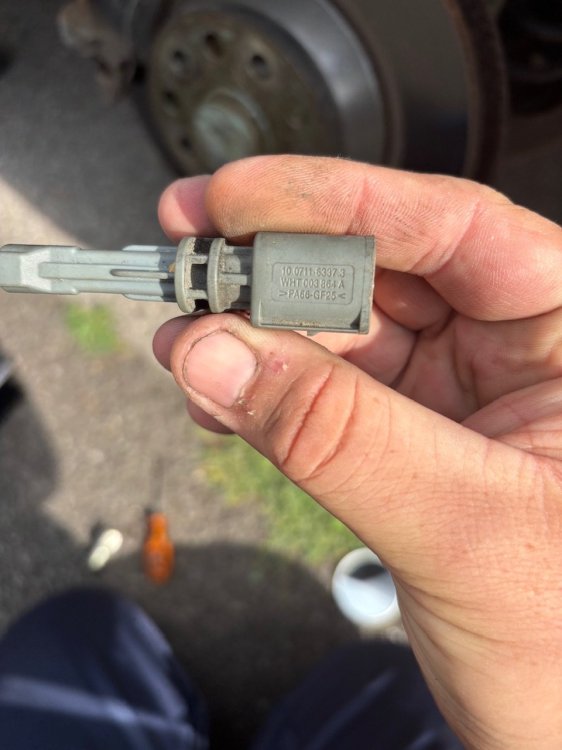

I had it up on axle stands and pulled the working rear left one, and its an 'ATE 10.0711-6438.3' and had the code 'WHT 003 864 B' on it also.
I tried autodoc.ie and the WHT code does come back with results - it appears the Bosch one I havent been successful with is a WHT 003 864 (no 'B'). But my search previously, it looked like the 'B' was specifically for vehicles with park assist, which I dont have... have regular cruise control, but not adaptive cc - maybe Im wrong there
What do people think? If the WHT code matches whats there in the working left one, the below link should be ok? Going to go for another ATE, just to keep the two on the back axle consistent..

I'll message you to request your VIN. From that I will be able to look up the correct part number.
  • Sponsor
46 minutes ago, woss said:
WHT 003 864 B
That's shown as correct for your VIN, but superseded by WHT 003 864 C.
Ordered another one there (previously linked) - will let you know how we go once it arrives, thanks again Pete
That’s my original on a 2016 and the part I replaced it with
Thanks Dan, yes so you’ve a rev ‘a’ one, and I’ve a rev ‘b’, which I think makes sense given the years

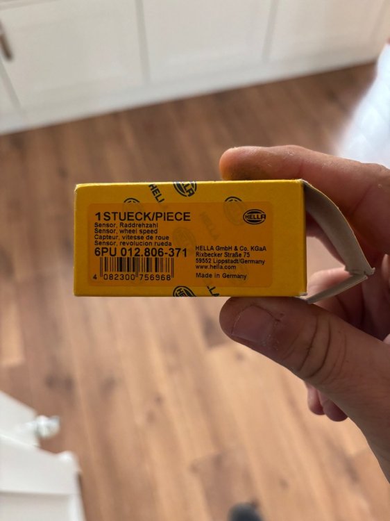

What’s caught me out here I think, is that when I looked for a main brand (Bosch in this instance) for the no name my mech fitted I was given two options - one with no mentioned ‘vehicle options’ and another mentioning cruise control and park assist.
I’ve since mapped those two Bosch options to the oem part numbers and turns out the wrong one I went for last time (that mentioned no ‘vehicle options’) is WHT 003 864 (with no rev number)
The one I think I should have gone for is the other one, that did mention cruise control & park assist. Notably I don’t have park assist, but do have cruise control (regular, not adaptive), so I could be wrong here, but suspect this is the case
