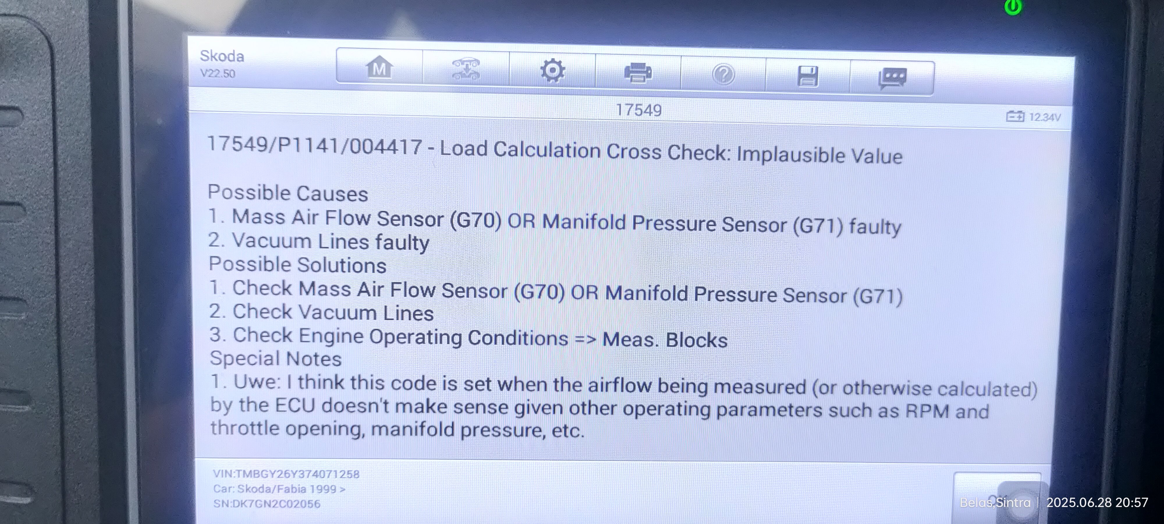

Hi all. New here, and looking to understand why the check engine light keeps on. Skoda Fabia II break HTP 1.2
Just bought it, second hand. Ran the diag too twice, cleared the light and it keeps lighting up.
Oxygen sensor? These attached? I am not sure where to start. ThanksIMG20250628205702.jpg
I would check vaccum lines first to see if there are any splits or visible damage. Check the brake servo hose as well. My sons 1.2 pinged up EML and it was due to it being split and losing vaccum.
Thanks 🙏 🙏
I taped the servo hose up on a temp measure and the EML light hasn't come on again since then. His pinged up codes for MAF and EVAP system and another I cant remember but so far it turned out to be servo hose.
