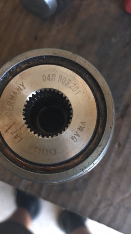

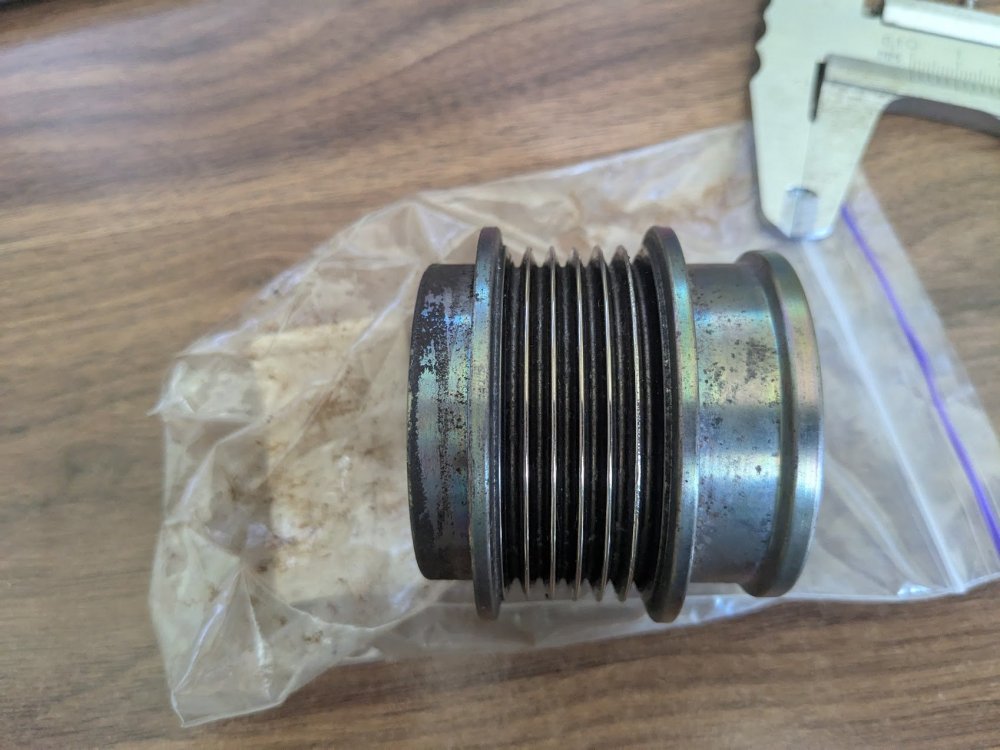

Hi everyone,
I'm looking for a freewheel clutch with the original part number 04B90320. Unfortunately, I can't find either the original part or an aftermarket equivalent in my local market.

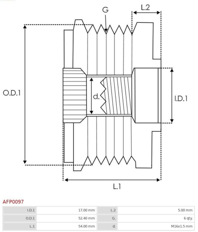

I'd also appreciate any advice on how to properly measure clutch dimensions—especially the L1 and L2 parameters.
For example, Autodoc suggests clutches under this number, but based on the dimensions, they clearly won’t fit. So I’ll likely need to find a compatible part manually. Any help is much appreciated!
