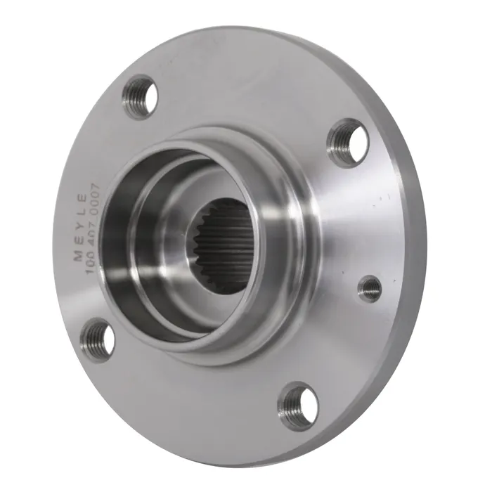

B) the mark on the hub face and disc are so that it's quick to put the disc back on when removing. Can you see all the holes in the brake disc hub/bell? The five large ones are for the wheel bolts, the three partial ones are part of the manufacturing process and then the little one with the bolt in it is just that - a disc retaining bolt. The disc only attaches to the hub one way (I.E. there is only one hole on the hub for the retaining bolt to go into. The lines make it nice and easy to just whack it on and do it up, without having to rotate the disc all the way around until the little bolt finds the little hole. See the picture below of the hub (bit behind the disc) and you'll see what I mean - you have the hub, followed by the brake disc, followed by the wheel. The wheel bolts pass through the disc, and screw into the hub. All that holds the brake disc on when the wheel and bolts are off is the retaining bolt, plus whatever rust/brake dust/magic stuff has built up over the years. On a newer car they should come off with a tap, on an older car you might need to break out the mallet, or worse.
