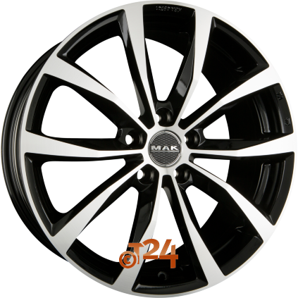

@PWDSCOTT There are very nice after-market 7jx17 wheels with ET 45 - 49 available. Combined with 215/50R17, that would fit, look nice and reduce the speedometer offset to about zero.
Only disadvantage: The tires are more expensive than the more common 205/55r16 or 225/45R17.
For example the Mak Wolf in 7Jx17 ET48:
