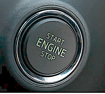

I note that, earlier, you said "Our Fabia 4 mc has no ignition switch". I assume your car (like mine) has 'keyless engine starting' with the push-button on its steering column shown in the photo below.
This replaces the traditional 2-stage key-operated ignition switch, with (Stage 1) a simple press turning on the Fabia's ignition, while (Stage 2) pressing the button with (depending on whether the car has manual or automatic transmission) the clutch or brake pedal being simultaneously depressed, causing the engine to start. It's definitely the case that some setting menus need the car's ignition to be turned on (Stage 1) but going to Stage 2 should really not be required.
