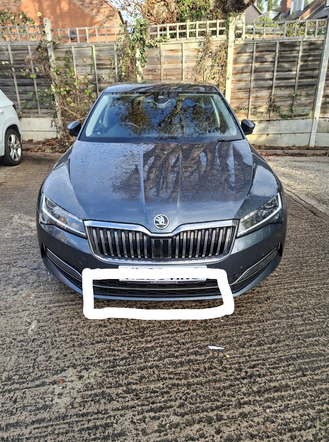

Has anyone replaced the middle section of the front grille?
I’ve just swapped out the left and right chrome trims they snapped off easily but I’m not sure if the middle section comes off the same way.
Does it just clip out, or is there a different method?

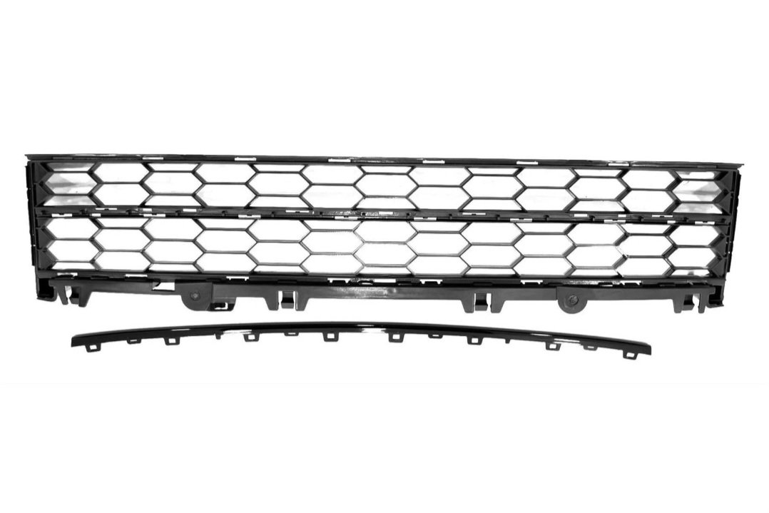

Front bumper needs to come off in order to remove the lower centre grille.
I've removed it myself. Pic below of it.
There r lots n lots of clips holding it in.
Edited by JR RS
I've also managed to swap it out, but like @JR RS I removed the front bumper.
I found getting the centre clips out first was the easiest way to do it, and then work towards to each end. The 2 end clips where particular stubborn though.
