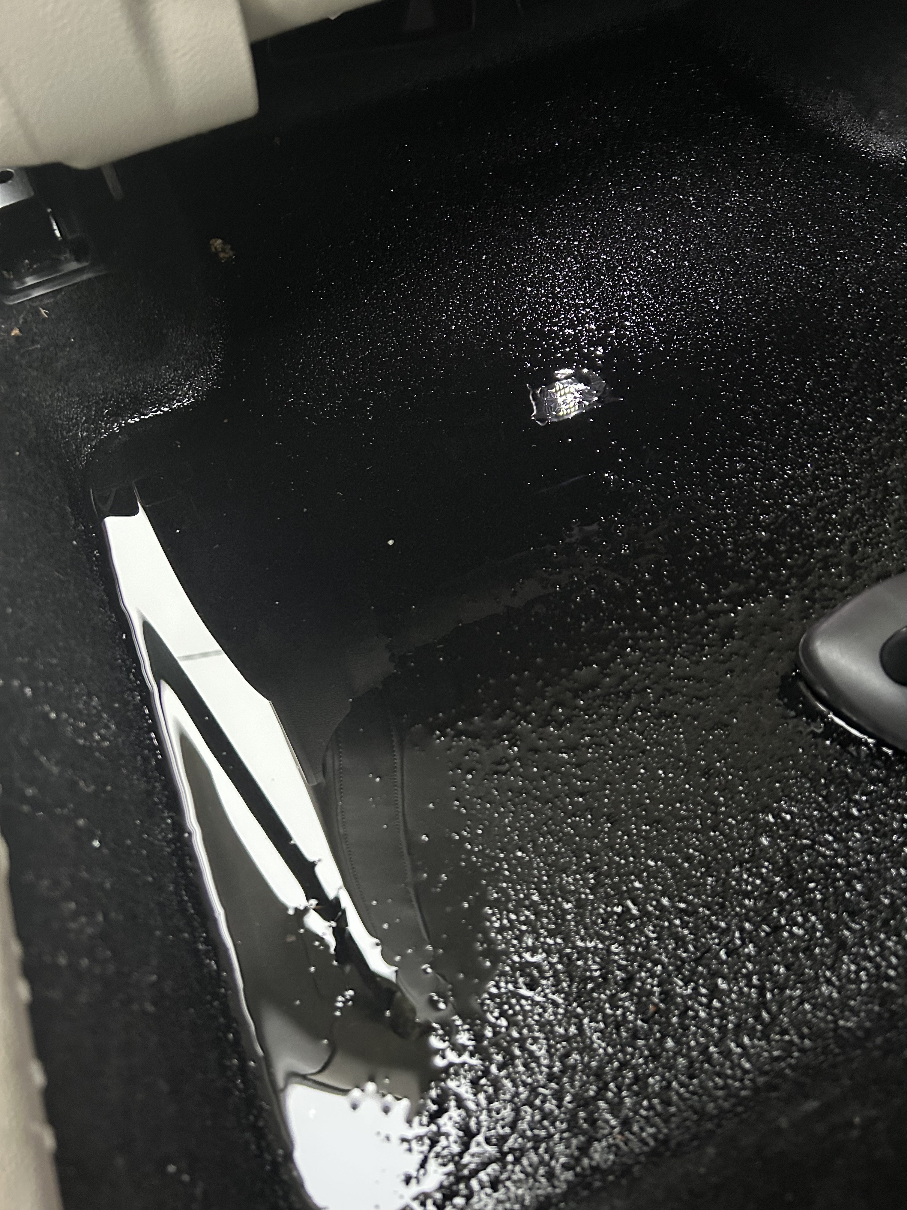

Hello- I have a 2023 superb since January of this year. Just coming up on 58k. Last week noticed a puddle of water in passenger rear footwell, wet in the front passenger footwell also.
Brought car to local skoda dealer where I purchased & was given a temporary car in the meantime while they did a water test. Got a phonecall today that they cant find the source of any leak & need my car for another week to perform another water test.

Can't help you with your main question though but I would have thought at if you car is letting in water to the extent shown in the picture then its not fit for purpose. Perhaps that is an option you could explore if needed.
