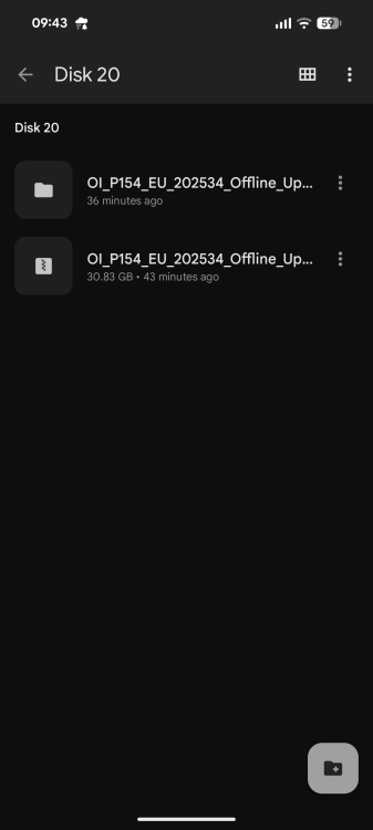

Hi. Hoping someone can help. I'm having trouble updating the map on my 2021 IV.
I've downloaded the file, copied it to a 128gb drive, extracted the file, and it now looks like this. Have left disk in car's drive for 2 weeks, but nothing happened. Am I doing something wrong? Many thanks.Screenshot_20260123-094300.png
It needs to be on a freshly formatted USB stick with nothing else present, your screenshot suggests that it's in a partition of a USB HDD or SSD, which probably won't work due to power draw constraints.
