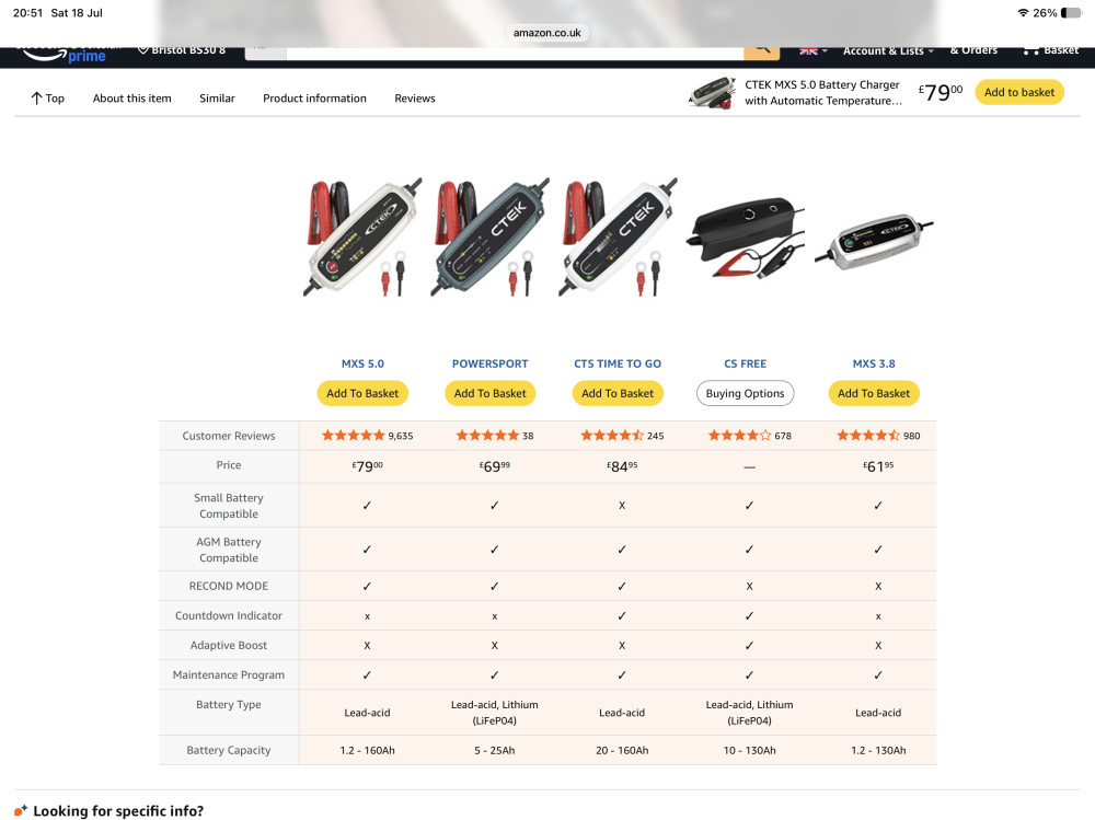

As a short term option might be to buy a batter charge/maintainer. This will monitor the battery and top up as required.
Not a cheap option sadly
These are some of them.I don’t need on for my diesel however see below (the link was very long so I’ve just dropped a phot in
