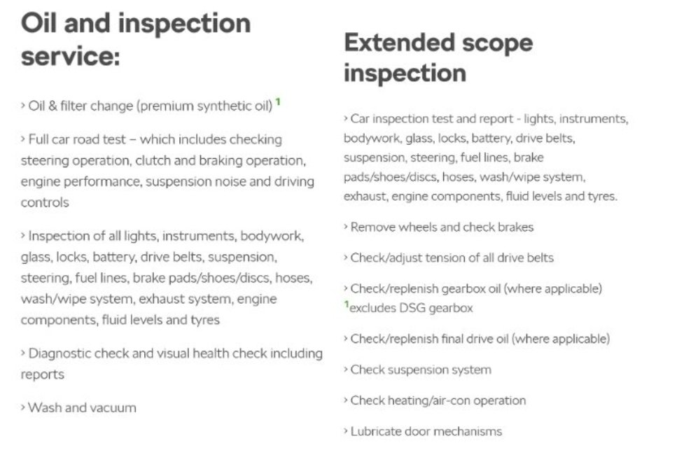

So was the Pollen filter changed in October? Has the brake fluid been replaced anytime? Interim / Minor & Major services were a thing of the past. Skoda UK went to Oil & Inspection Service & Extended scope at 3 years then each 2 years in 2019/20. Spark Plugs were at Major Services on the 2nd one years back. They should still be at 4 years / 40,000 miles, but only if the owners asks and pays and Spark Plugs at Main Dealers Services are a ridiculous price. They have air filters at 60,000 ,miles / 6 years which is nuts. They should be inspected annually, or at a service.
