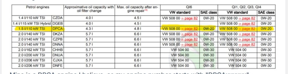

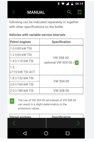

VW504 00 / 507 00 0w 30 FS III is just perfect for your 2.0 TSI. No need for the VW508 00 / 509 000 0w 20 FS IV that VW Group / Skoda went with for the WLTP Results (RDE2) in the EU / Europe regardless of it being the best for engines long long life. Australia has nothing to do with The World Wide Harmonised Testing that is not Real World Driving testing / emissions. Or even trusted around the whole world. 0w 30 FS better for the engine at higher temperatures than the 0w 20 FS.

Thanks for your response. Let me get this straight, correct me if I'm wrong. 0w-30 is perfect and no need for the 0w-20 as 0W-30 is best for high temperatures heavy loads and i believe i understand this, though to date my temps don't rise that high i don't overload the car, but what about the point that 0w-30 is too viscous and under high load, as it's thicker oil might not flow as quickly to critical turbocharger bearings as designed and that 0w-20 is better for that purpose.
Ok so for Australia 0w-20 isn't required as it based on WLTP Results (RDE2) in the EU / Europe and Australia isn't Europe so has nothing to do with this testing. So 0w-30 is best even though in the second table for my engine 2.0 I/180 kW TSI VW 508 which in the top table specifies to use the 0w-20

You turbo is getting lubricated perfectly well even if it is 5w 30 FS III. They were lubricated with that for many years, or even with 5w 40 FS when Long Life oil was not used.
