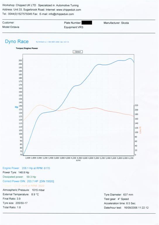

My Graph, Not sure what it all means though.
New spring ordered as i needed a Yellow spring and was running green one.
I was told i was loosing boost, If anyone can explain this to me please do.
Hi mluton glad to see you are all mapped up now:D stick with the green spring m8 coz its the correct one, i to thought this to but lots of people have this prob after a map, remapping can cause many problems that arise from running a higher boost compared to standard when your engine managed with the lower boost setting. check your pipes on your forge i take it its a 007p i do know from experience mapped cars can cause pipe leaks if you run a vagcom you will prob get 17705 i and plenty of others have had the same prob,in the end it was the small pipe on top of the dv needed to be tighter and that was all it was, change the spring by all means but there is no need as the green spring is plenty good enough for a remapped vrs.:thumbup: give your car a couple of days for your ecu to do its stuff then you will find your car will be even quicker.
17705 - Pressure Drop between Turbo and Throttle Valve (check D.V.!)

Cheers mate, will give it a few miles then give it a scan.:thumbup:
