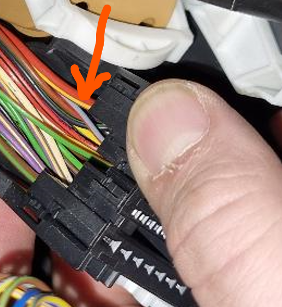

  1. Hmmm, I might take out the BCM and open it up and have a look at the relay see if that gives anything up. If the power went into it but the relay was toast and constant 'open circuit' would it not give that fault? I'm only guessing as electrics aren't really my strong point, I know basics but 😕
  2. Right, after a struggle, I've managed to test that pin and I do get 12v from it. So there is power going in.
  3. Thanks for your help so far, I'm gonna leave that till tomorrow now as contorting myself under the dash wasn't a pleasant experience.
  4. Bloody Hell!!! Access is virtually non-exsistant (well for me anyway at 6'5 & 18st) I managed to unclip the BCM from its housing but there isn't enough wiggle room to pull it down without disconnecting the black plug. Is the red arrowed wire the one you mean and if I test it unplugged cause I can't get around the back of it whilst it is plugged in, would cause me more probs or not please?
  5. Righty-ho, I'll have a go and report back
  6. Sorry Breezy Pete, I'm used to Land Rover diagnostics (having had 3 in the past) and not really delved into the Skoda, is the BCM the one under the drivers side behind the fuse box & can you get to it easy enough to test, having 3 herniated discs I'm struggling getting in tight spaces 🙄
  7. Nope, its not the fuse, been out & replaced it with a new one. theres current going through there as I've checked it with a multimeter?????

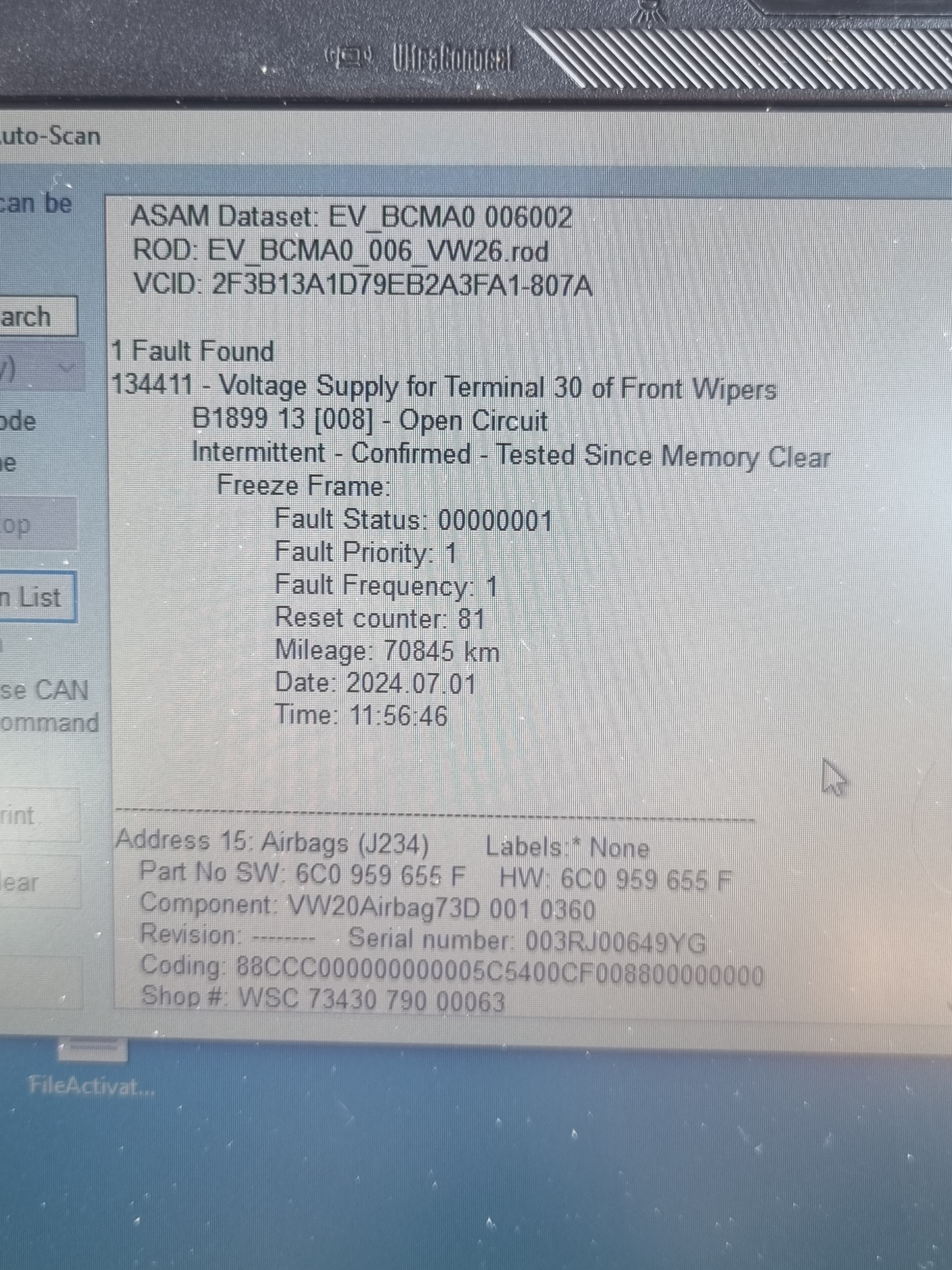

  9. I managed to plug it in today to read any codes and got this back...... Is this likely to be the relay that's at fault, the one that's soldered into the BCM????
  10. Hello, I'm looking for a bit of inspiration for the problem with the front wipers on my misses fabia. I went to work in it the other day it was fine no probs wipers worked. Then yesterday wifey used it and no wipers?!? Of course she blames me 🙄 but I dunno why they won't work? If you activate the stalk for 1 swipe, intermittent, speed 1 or 2 nothing happens, not front wash either. Back wiper works fine? I've checked the fuses all ok and am gonna be looking at the motor tomorrow, is there anything else I should look at???
