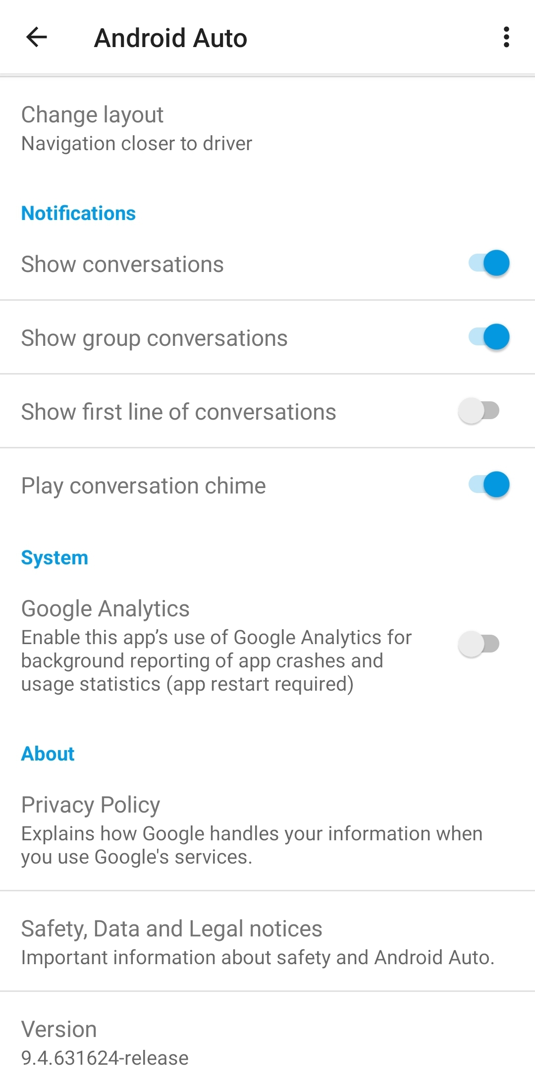

  6. @kreekeras far as I know it's the latest AA version, splitscreen option, version at bottom of screenshot below.
