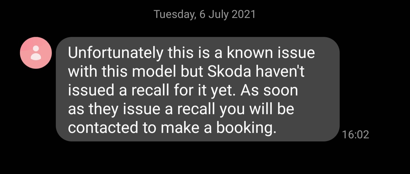

Just an update on the SOS system issue - tried to book in for a check via Driverline....
Ooh well, at least you may know what the issue is now. Hopefully clicking Boise's don't annoy you too much (I don't)!

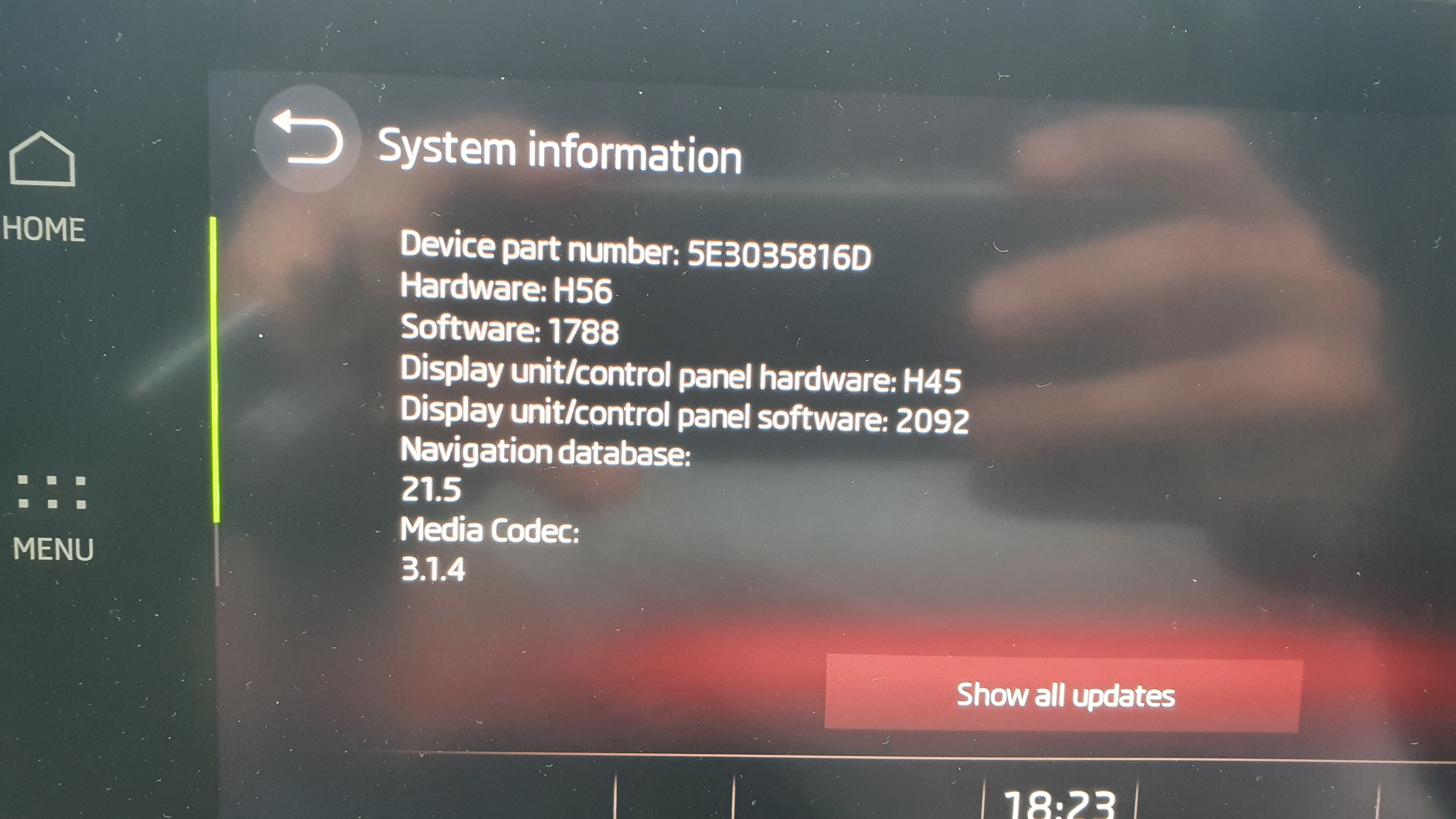

Anyways, so overall I did 471 miles and heard the popping sound only once. Straight away the SOS light started flashing red, but did not get the error on the screen. Probably a few seconds later, the light went solid green again. There was an software update available, which did not provide any info of what's included. Installed it on Sunday, when we came back home as the reception was better. No new version on the infotainment, though... the same as before:
