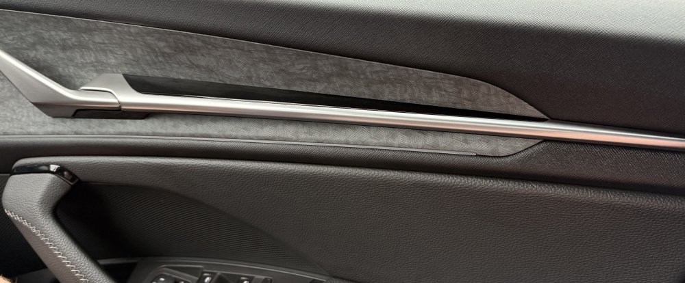

  1. No you are right, it should be. Just didn’t want the car door removing for them to fix it that’s all. Was a little worried that it could cause more noise that’s all.
  2. Hi all, Just wondering if this silver trim can be removed so i can pad it out? I have a buzzing noise coming from it. When I press on it, the buzz goes. I have seen other people having issues and apparently Skoda can fix it but rather look at it myself. Thanks IMG_9495 (1).heic
