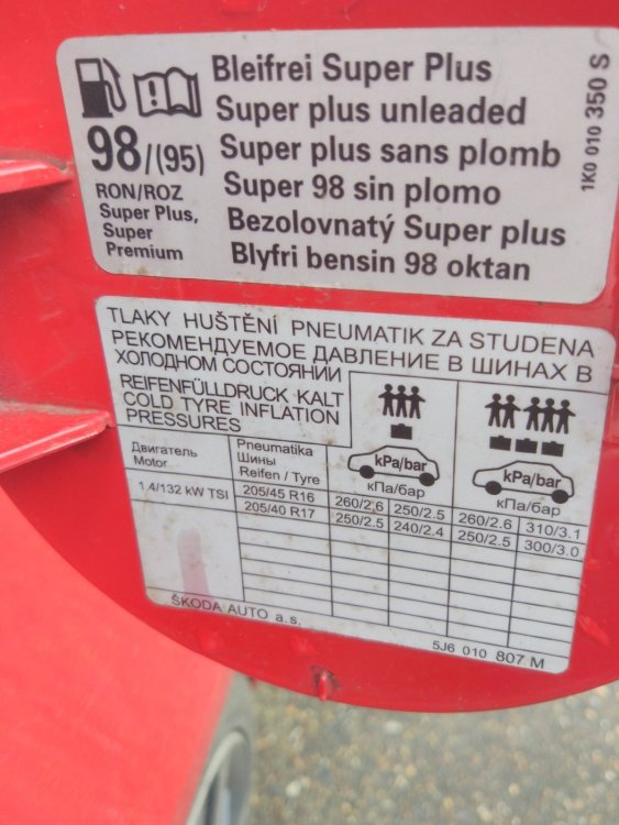

Do you have good spark plugs in, & running it on Super Unleaded E5 97 or 99 ron & not E10 95 Unleaded?

Fuel
http://briskoda.net/forums/topic/452407-best-fuel-for-mk2-fabia-vrs
