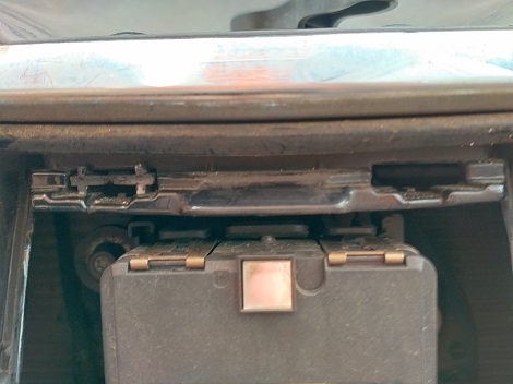

  3. And breeeeeathe. i've managed to finally get the stuck-in bit out. What I thought were two metal retainers or similar was part of the plastic from the old clip - a trick of the light made it look metallic and it was in exactly the right (or wrong) place. Thank you once again for all the advice and trouble you've gone to; I really appreciate it. You can also see if you didn't know already how totally illiterate I am when it comes to anything mechanical. Now, if you have any suggestions for an appropriate punishment should I ever come across the scrote who stole the original...
  4. Again, thanks for all the help - that's the part I have. My worry is that what looks like two screws in the bit that's left of the clip aren't on the replacement.
  5. Update - I've tried pliers but while it can move a bit, it still can't be removed.
  6. No, I can't see anything like that on the new one. All I have is the cover - does it need the extra lugs, or does the replacement not need them? Thanks for the prompt reply.
  7. Sorry to return to this, but the replacement cover arrived today and trying to fit it is problematic as there's something in the top left bracket causing an obstruction. If you can't see it properly, it's a piece of plastic with what looks like two screws but it's not being held in place. I can't see what's keeping it in there; it can move from side to side but not be taken out. I don't know whether it should be there and there should be others in the other brackets or it was part of the housing that was stolen and has to be taken out somehow, but either way I don't want to force it as I'm worried that the sensor itself will get damaged. I've tried removing the washers above but they don't seem to be doing anything other than covering two holes. I'd be very grateful if anyone has any ideas.

  11. It's still there and luckily seems fine.
