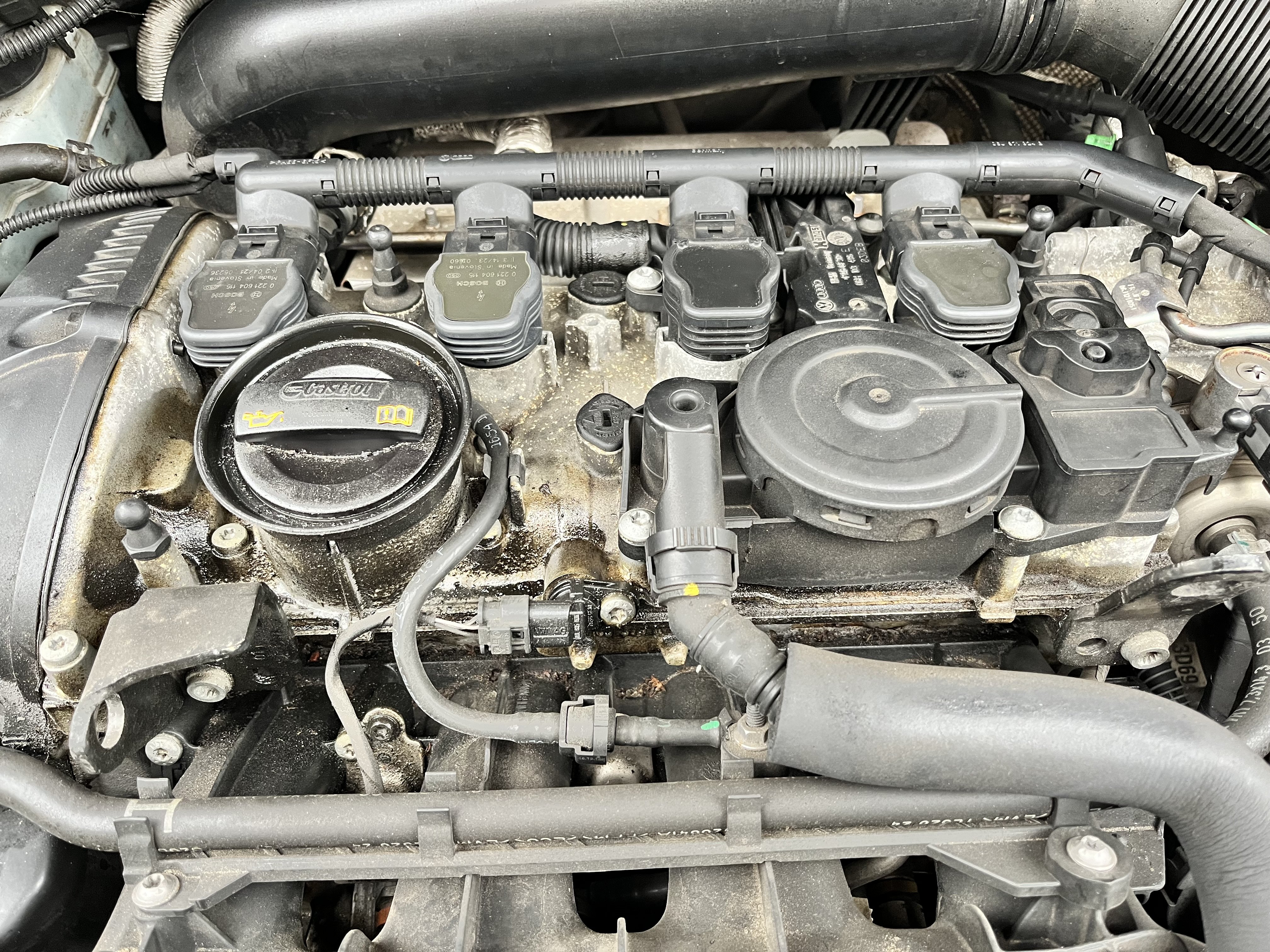

Back to the Engine Issues In Summary - 1.8 TSi 4x4 2010 (118kW) Engine Number CDA 18**** Oil is 5w-40 Synthentic Oil Consumed is 2 litres every 400miles If asking for a quote on an engine rebuild what exactly am I asking for? Rings/Conrods/Pistons? New Chain? What am I looking these days? £2.5 - 3k? This is the current state with the cover off - looks like there's lots of oil leakage?

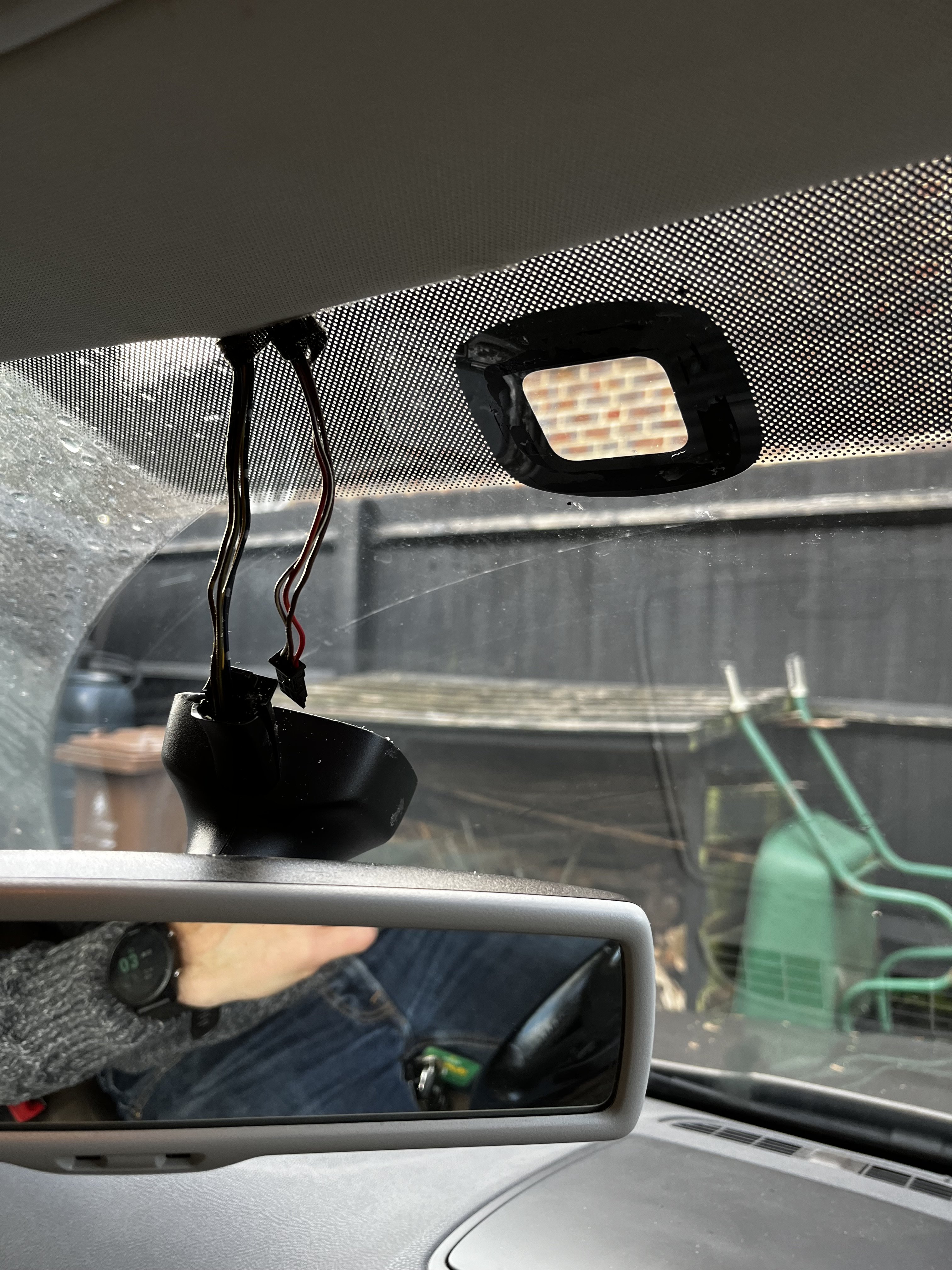

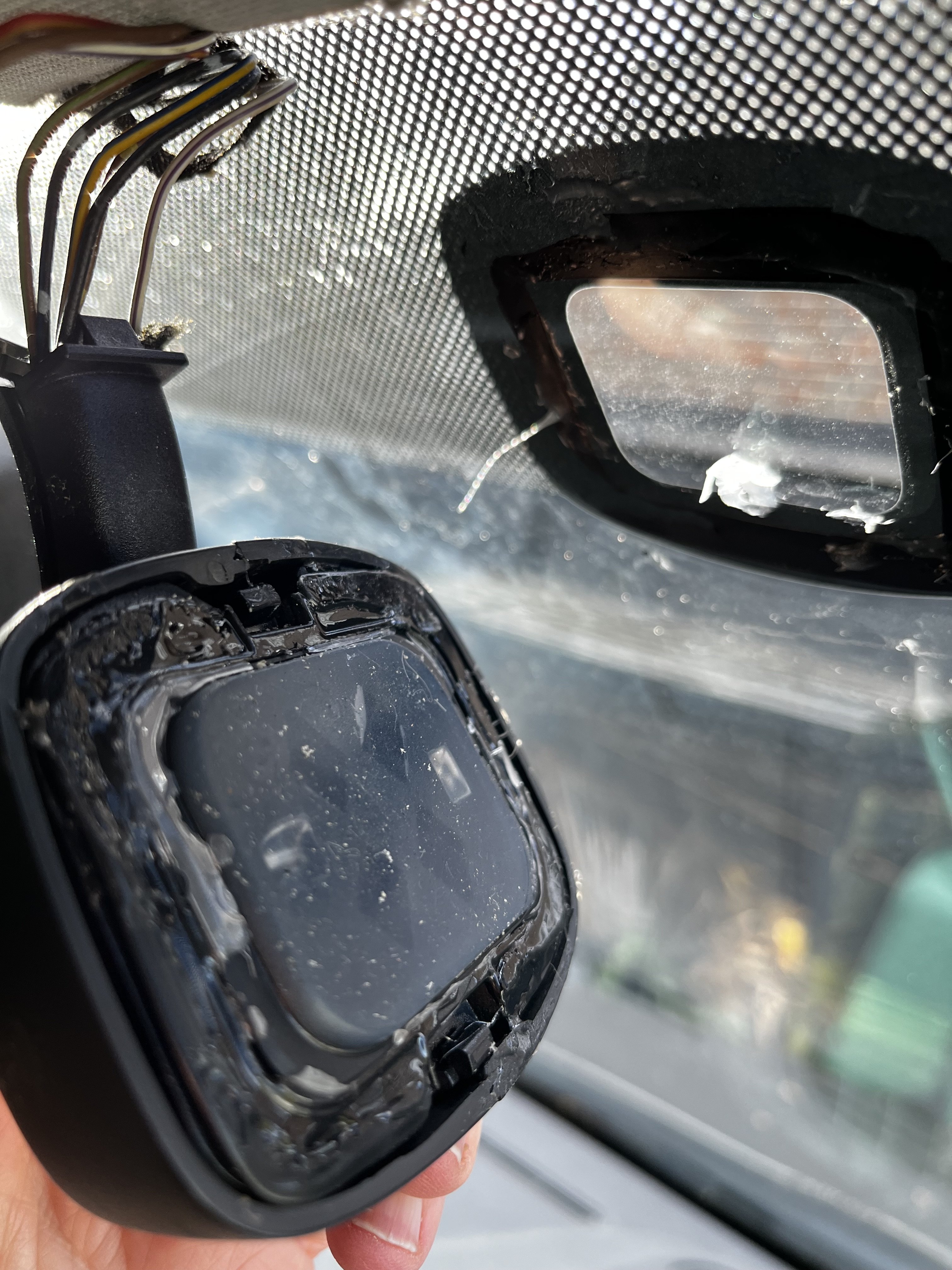

Update: Not a lot as happened as been busy with work but the time has now come to get this all sorted once and for all - compounded by the fact that Autoglass replaced the windscreen for a chip last summer and the rear view mirror was found to be hanging by its cables yesterday morning 🥵 So as well starting to get new engine rebuilding quotes I now have find someone who can reconnect the rear view mirror Ive disconnected the mirror from the loom but wondering who could stick it back on??
