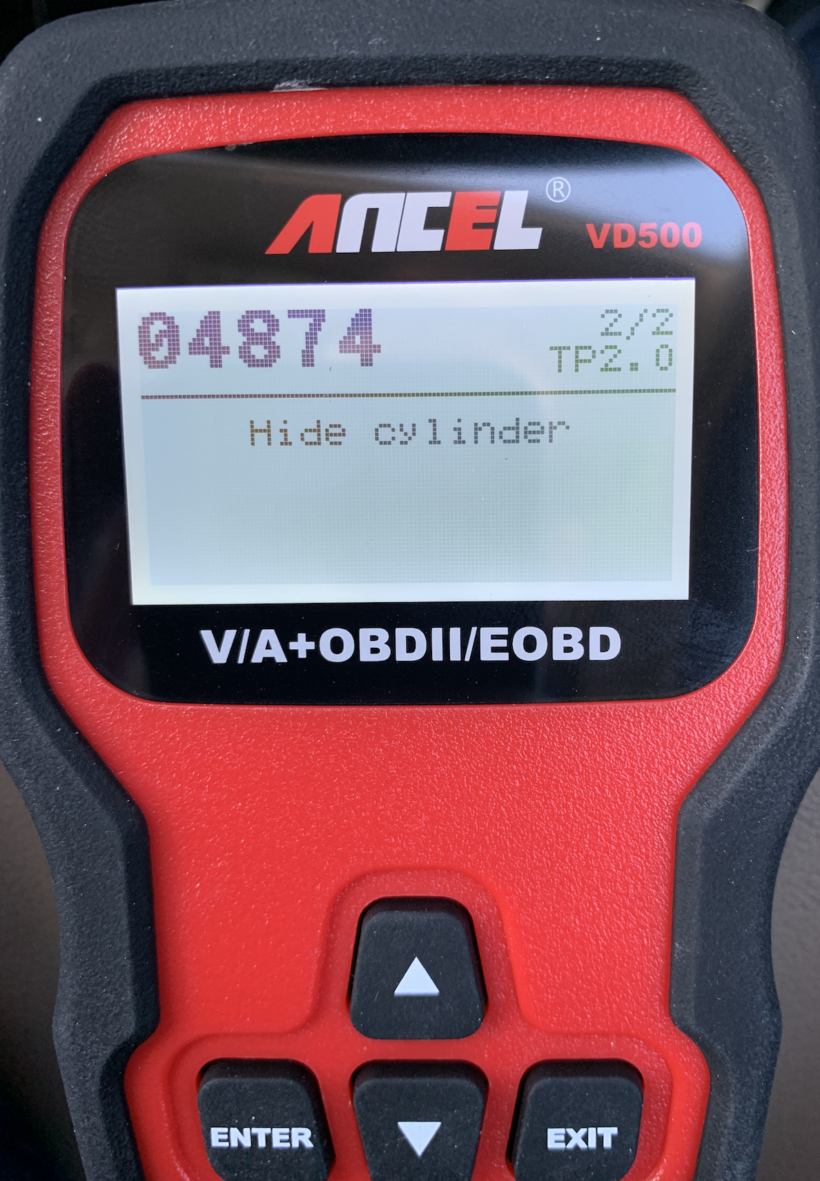

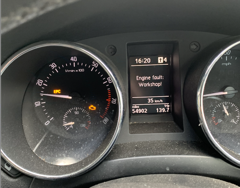

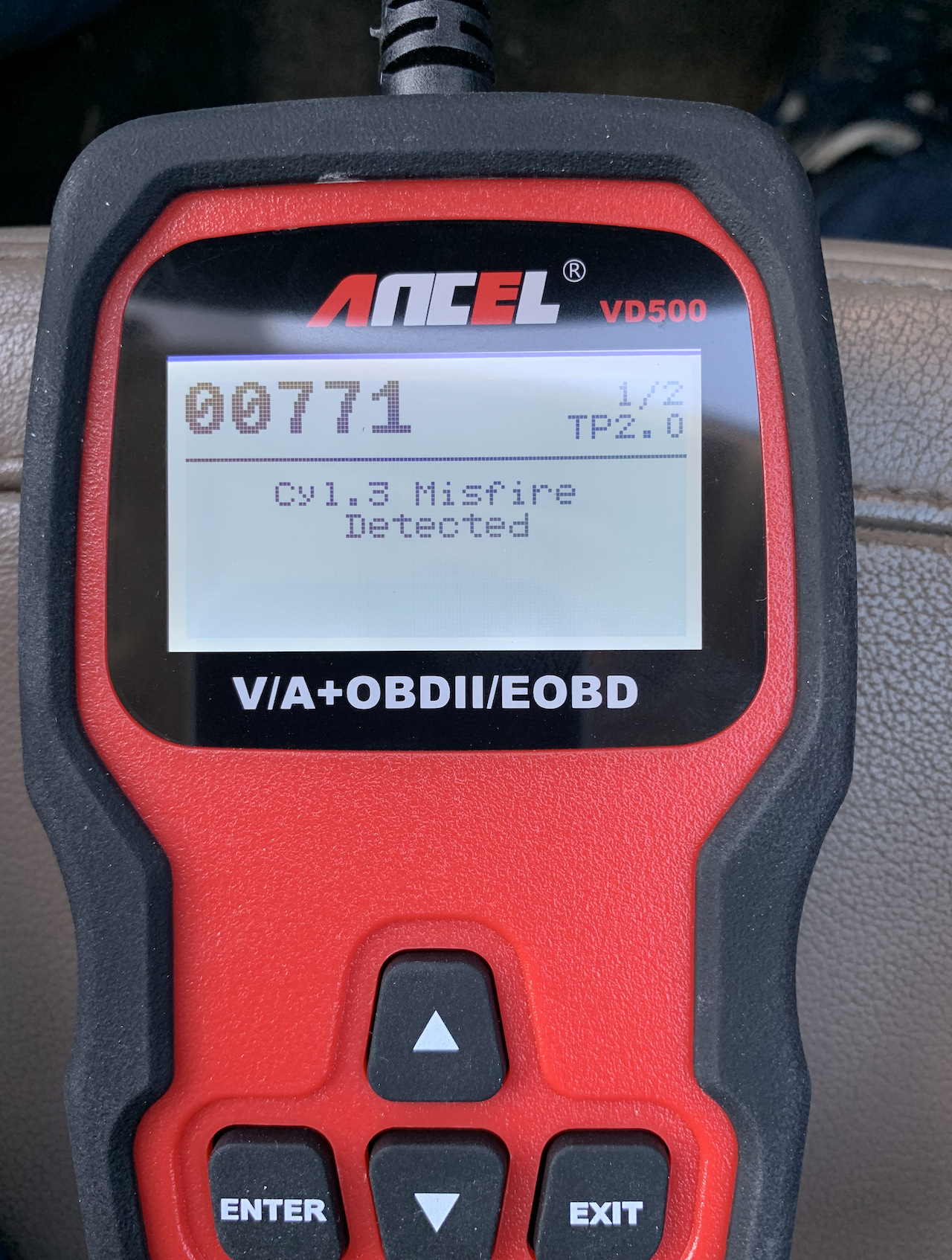

Hi All,
 I've diagnosed these two codes on my Yeti, reading around it looks like it could be anything from the ignition coil packs to spark plugs - before I call up my local garage and can anyone advise please?
The car starts but the engine shudders and the EPC light comes on - Engine Fault - Workshop!
Thanks

Coil pack and spark plug replaced on Cylinder 3 - £150 all in
to say i am relieved is an understatement - going to book into Allam's of Epsom next to get that tensioner checked out
