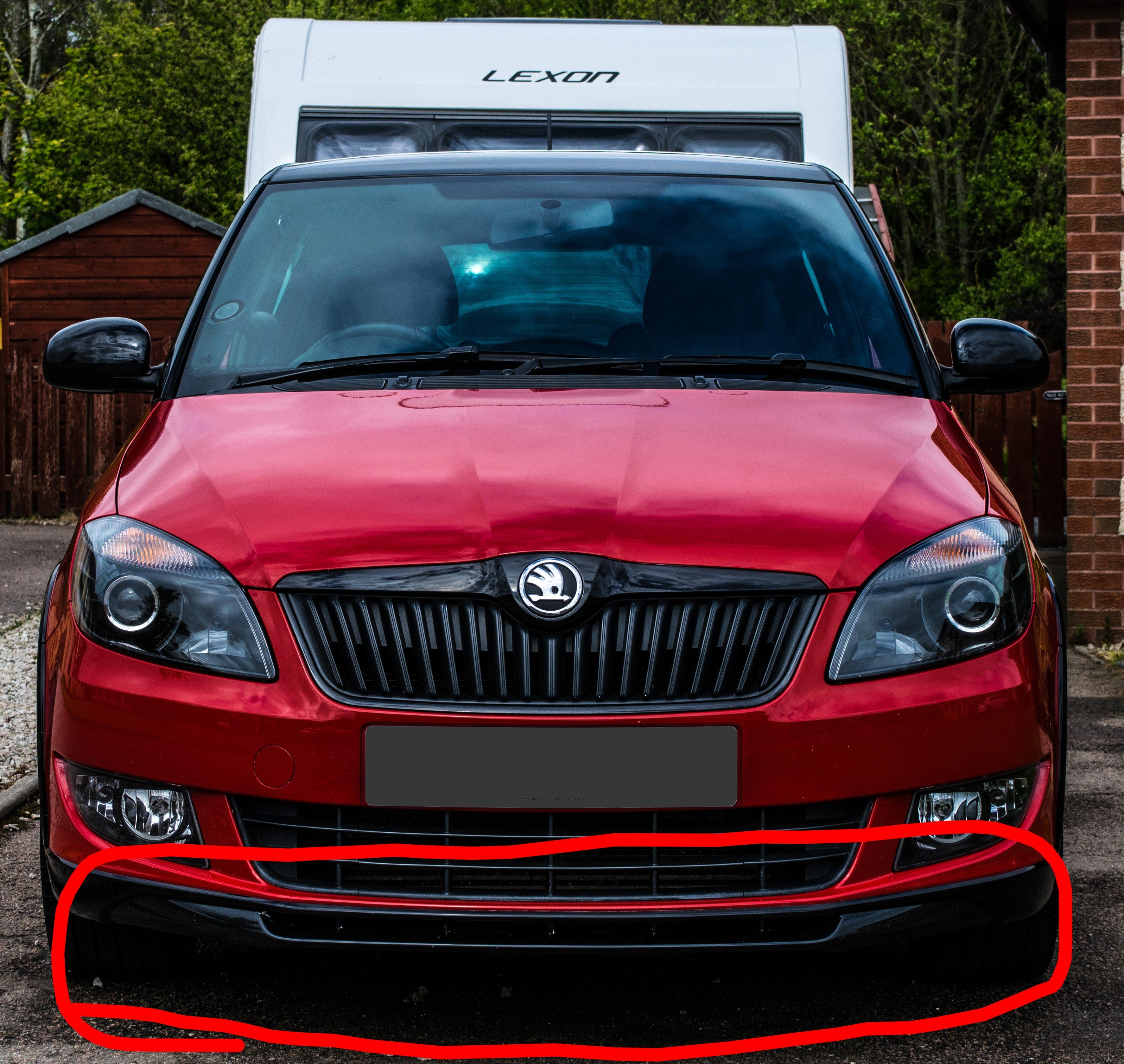

  1. Has anyone changed a front spoiler/lip on a Monte Carlo? I've purchased a replacement (new part) and have a quote for a local body shop to paint it. I've asked if the quote includes fitting and they're going to let me know. It looks like 4 screws and the sides clip into the wheel arches. How hard would it be to change myself if they won't include the swapping of parts over in the quote? I've added a picture of another random Monte Carlo to highlight the part.

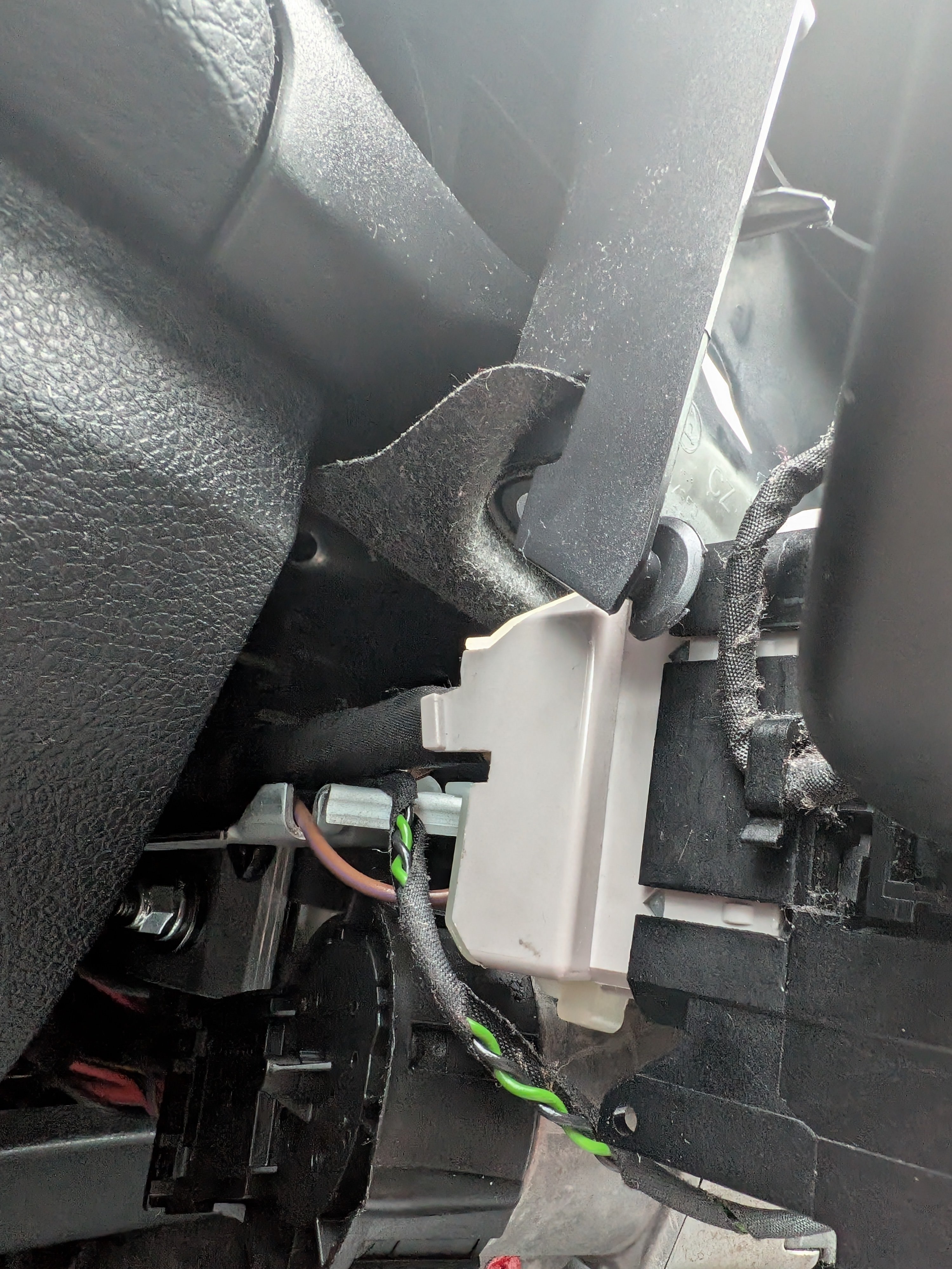

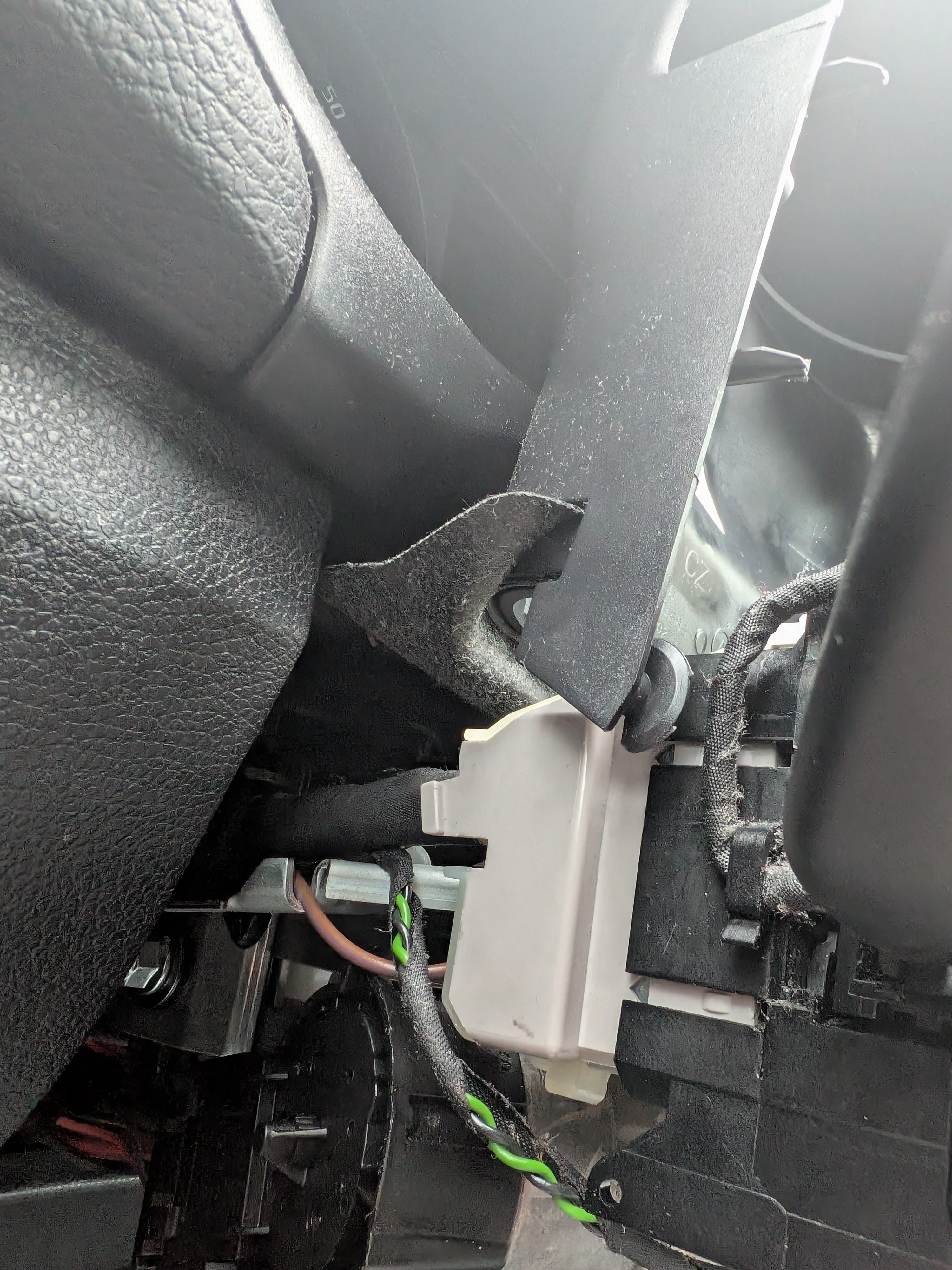

  5. Ignore... I figured it out! Had to pull the white tab upwards and then the plug came out.

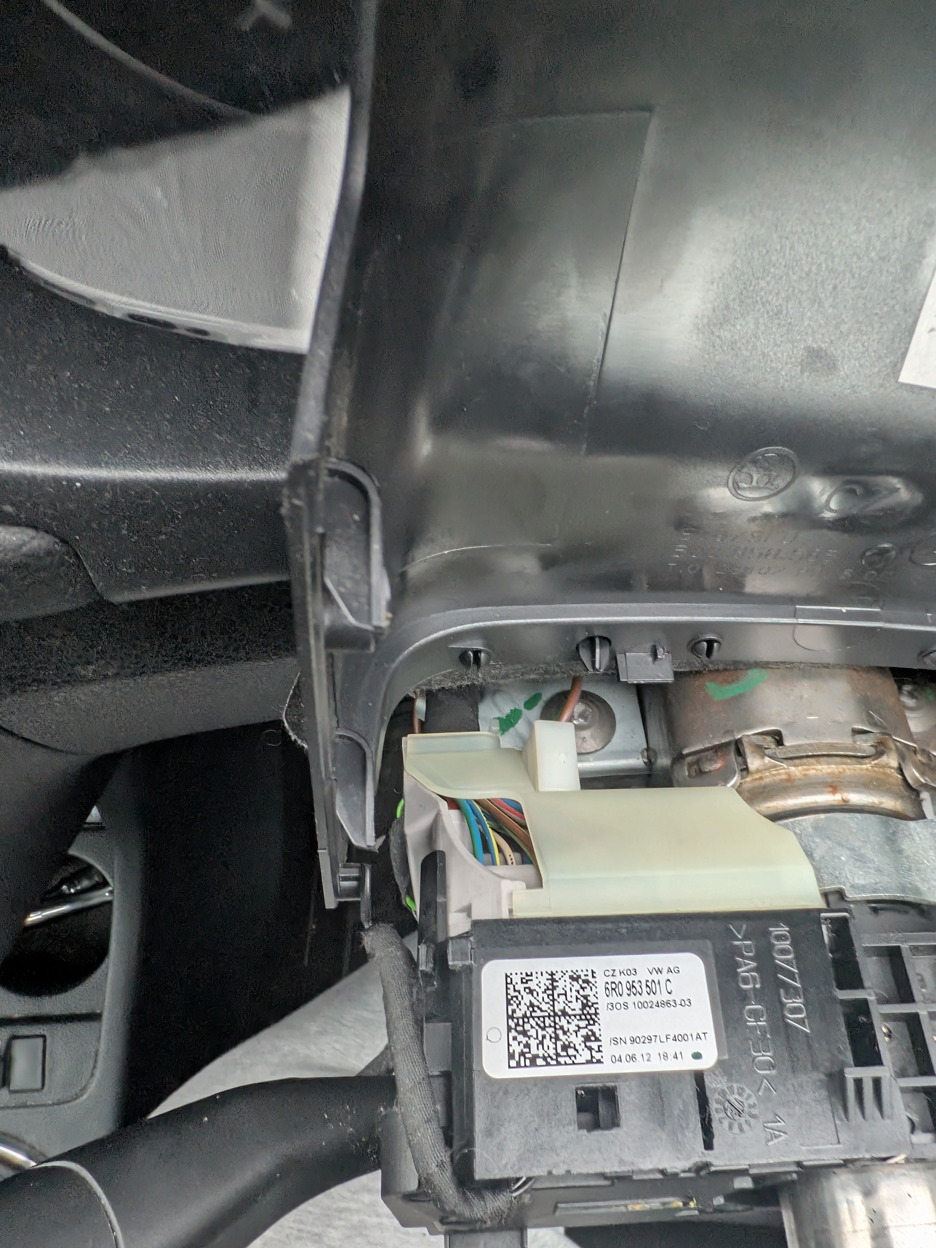

  6. Hi all, my sons full beam stopped working (I checked/replaced the bulbs and checked/replaced the fuses). I ordered a replacement part but have got stuck trying to remove the big connecting block connected to the wiper/indicator stalk. Has anyone got any advice on how you remove it please?

  10. Ah... I hadn't thought of that thank you, I'll go and have a look in a bit and will report back.

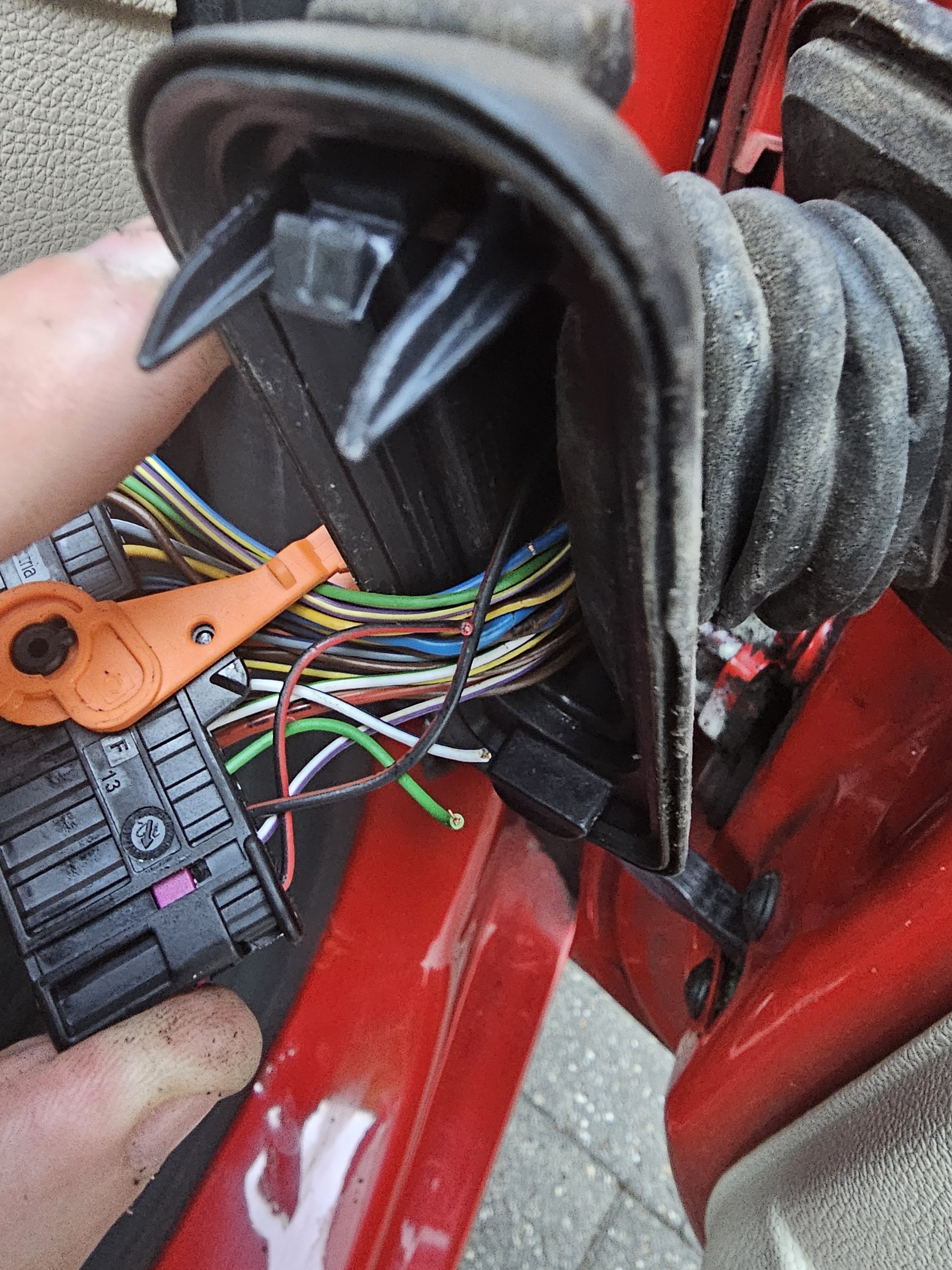

  11. Hi all, I picked up a 2013 Skoda fabia Elegance a few weeks ago to use as my sons first car. It was a private sale and at a very good price. On inspection I noticed that the powered passenger wing mirror was not working when using the mirror adjuster on the drivers side. The drivers wing mirror works fine. I purchased anyway as its a very clean example with a full service history at a very competitive price. I figured I'd factor in the savings to fix the wing mirror. I've searched and looked at lots of posts on here and the common reason is broken cables in thr door loom. I took the door panel off this afternoon and check all the wiring in the look and all the wires are fine (no obvious breaks or Splits. I unplugged the connector into the car itself and inspected all the pins etc. I then removed all the insulation tape and inspected all of the wiring behind the door panel (through the rubber grommet) again it was all good. In anticipation I had purchased a pre-owned wing mirror from ebay and plugged it in, again it didn't work. I even swapped out the original fuse for a brand new one (just covering all bases) again it didn't work. The electric window, speaker, etc all work fine on the passenger side, it's just the mirror. My next point of call would be the actual joystick that controls the mirror, I guess there's a small chance it could be faulty? I may need to end up getting an auto electrician to have a look, but would prefer if possible to remedy myself. Has anyone else had this issue where the wires and loom appear to be fine?
