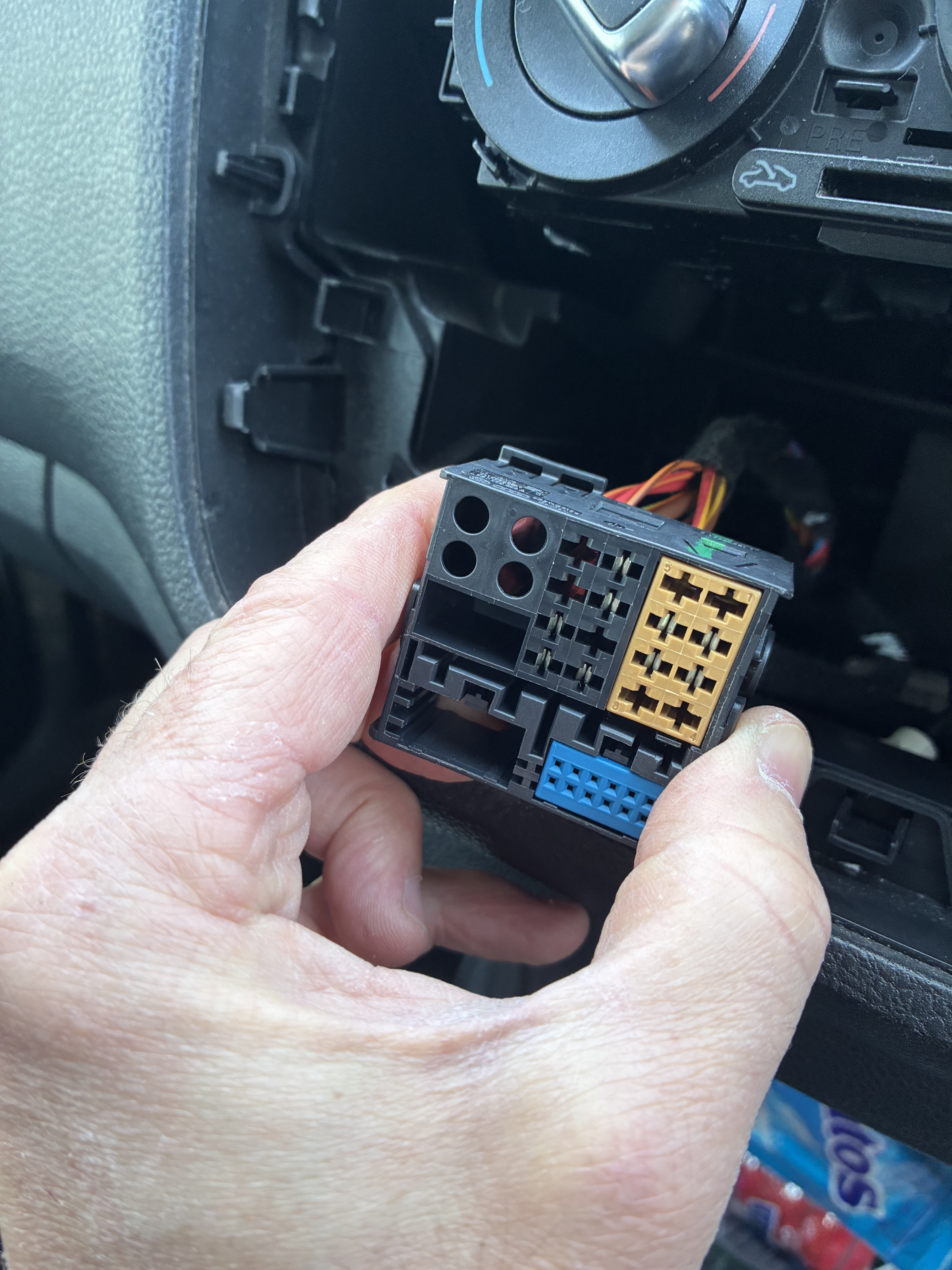

  1. I have some 6.5inch Alpine Speakers that I was thinking of using to upgrade my daughters Citigo. The speakers have a protruding part which means they are not completely flat fronted. Will they fit? Secondly I have a sub which I was goining to fit under the passenger seat. This either connects to the speaker outputs or via RCA plugs. The factory stereo only had front speakers so I was going to plug into the rear outputs to save splicing wires. Does anyone know the type of plug and connector I need to go into the factory plug? Thanks in advance Chris
  2. I had the radio etc out to check on the aerial cable at the rear of the head unit but now it doesnt seem to want to go in all the way? Any insight on how to solve this?
