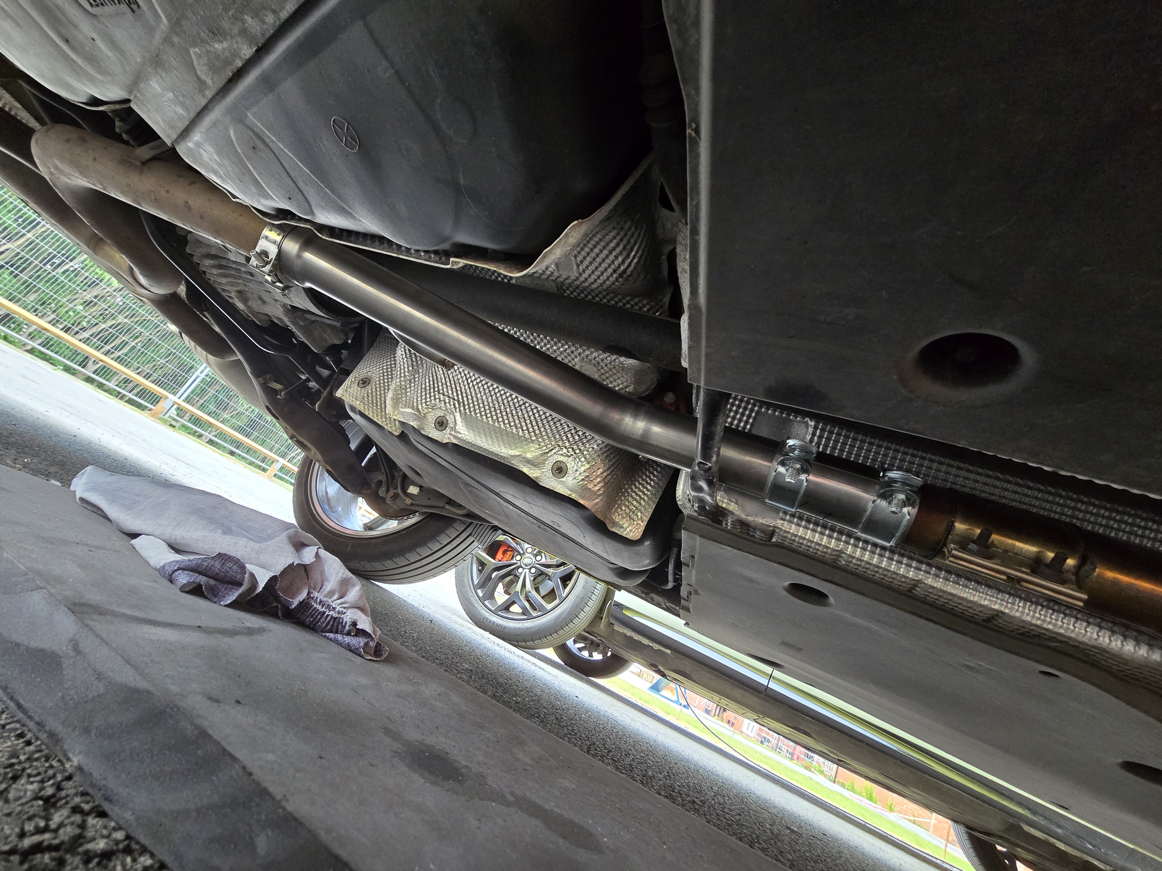

  6. Sounds decent for the price to be fair, a bit louder in general with a hint of drone when cruising, full throttle is a blast with the "DSG farts"!

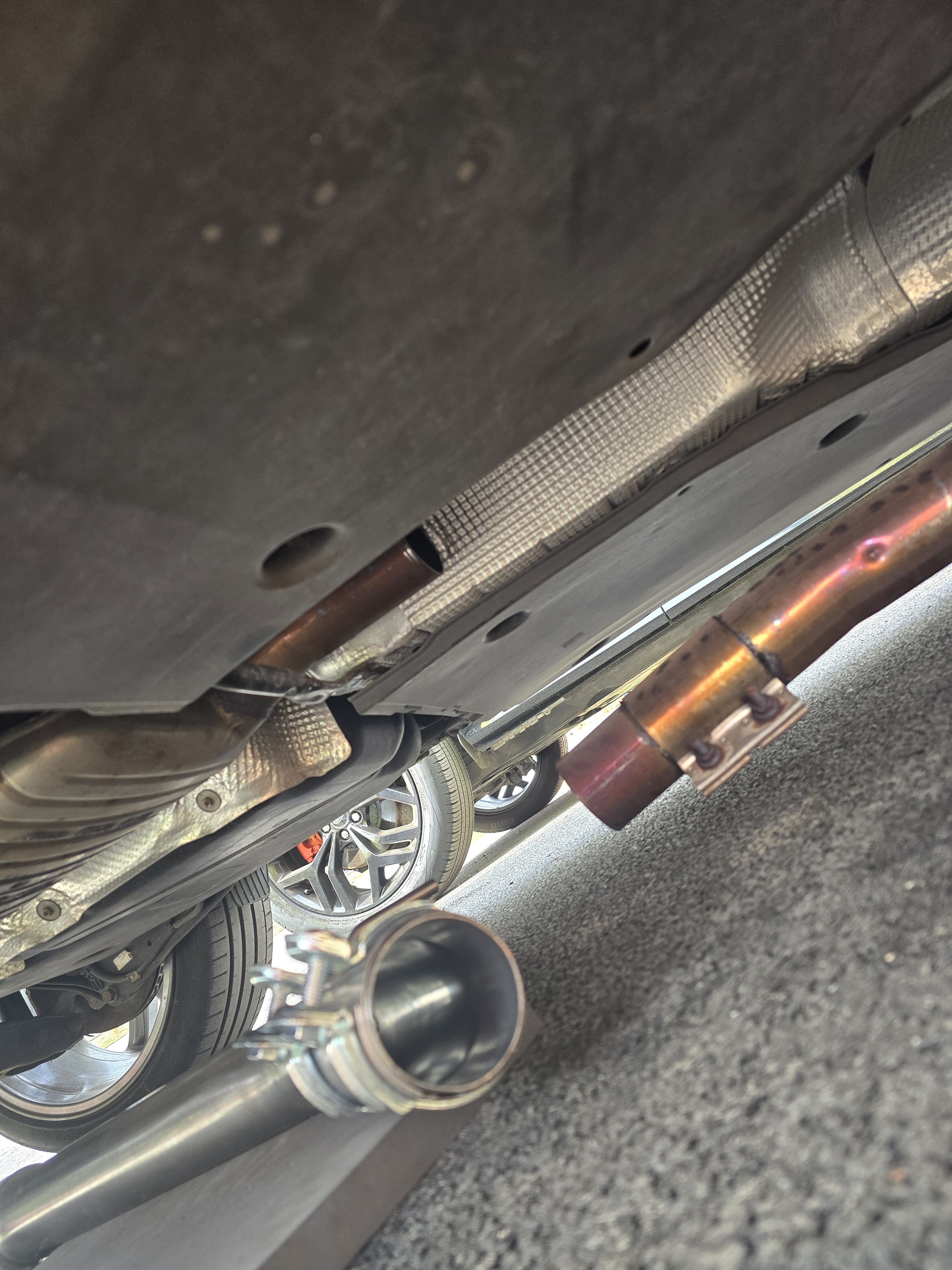

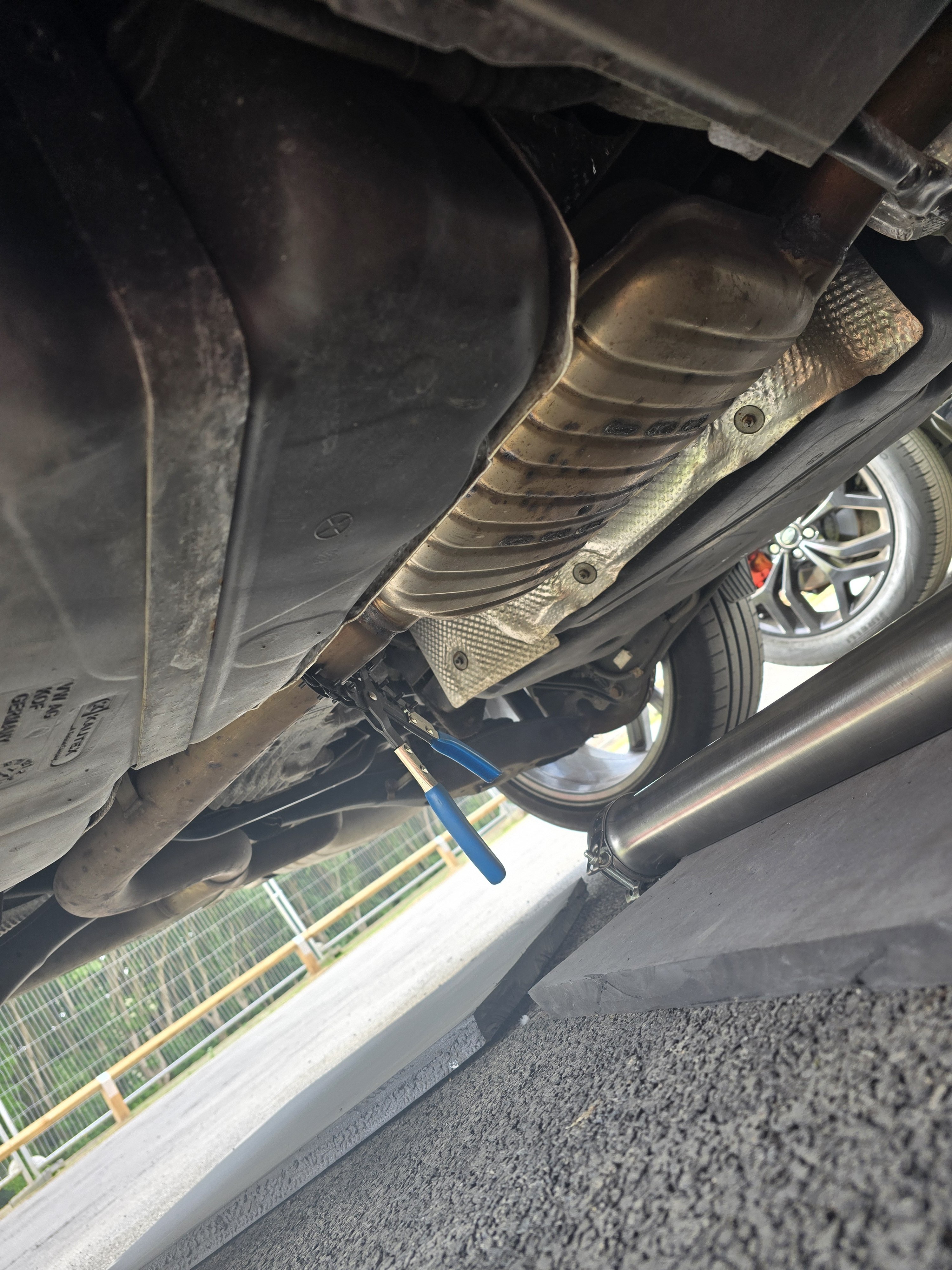

  7. Done it... 2nd cut was an absolute pig, cheap exhaust cutter blunted really quick! Fits well, sounds a little better at idle,with a bit more burble under load. Will do a proper listen tomorrow on the way to work.

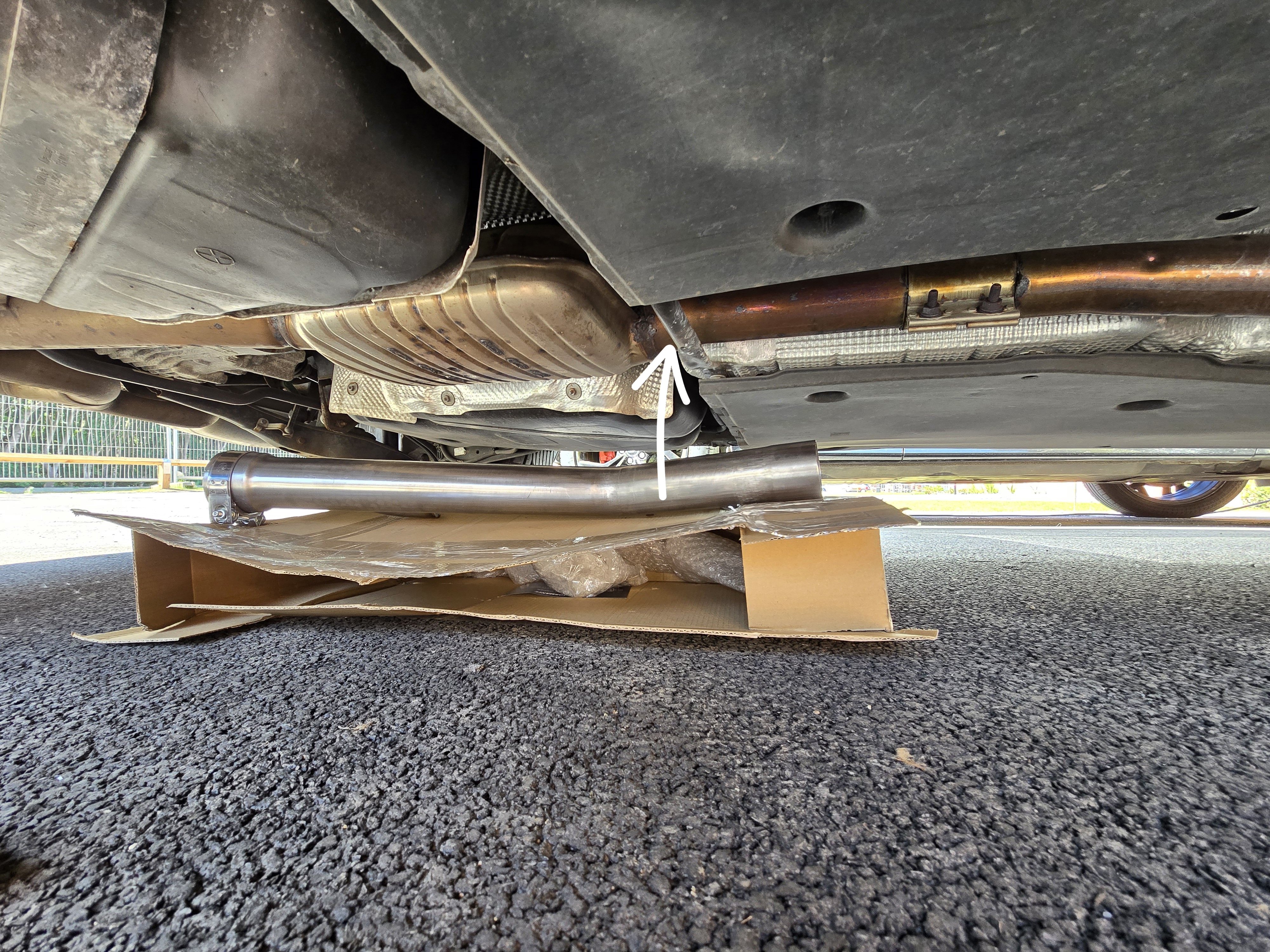

  8. Yes it will fit, just the natural break forward of the box is a bit further forward here so you have to make 2 cuts rather than 1, then rejoin it behind the existing clamp on the right of the pic.
  9. My mistake, missed your post on previous page and concentrated on the pipe you linked! Thanks for your reply though. I'm confident it will fit, I'll do it tomorrow when the extra clamp arrives.
  10. Did you have to cut behind the clamp forward of the resonator and use an additional clamp? I've just mocked mine up (Cupra Formentor pipe) and it sits some way behind the natural break with the hangar in the correct position. Guessing OEM has a bit of extra length due to the size of the car compared to the smaller hatch's...
