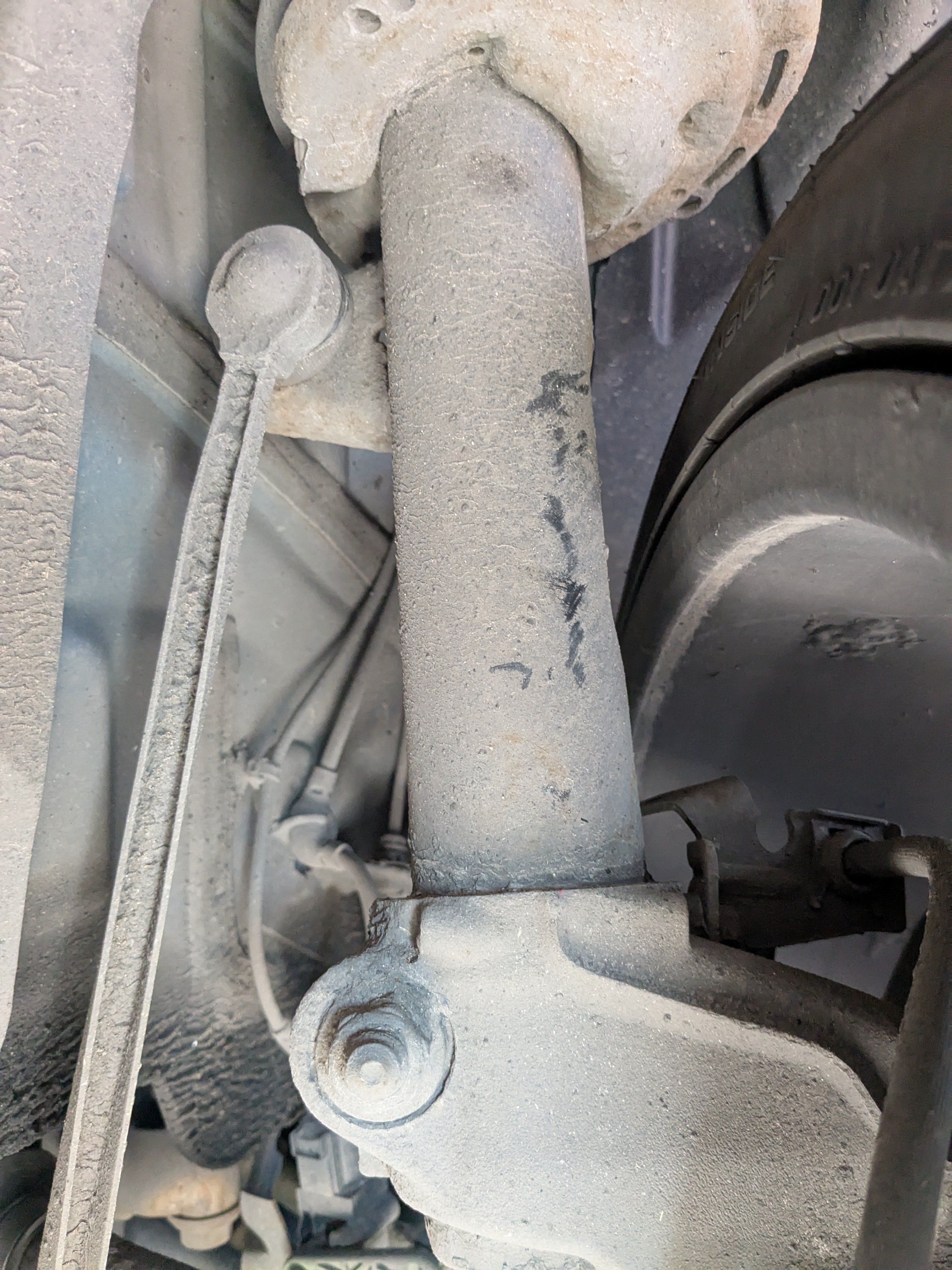

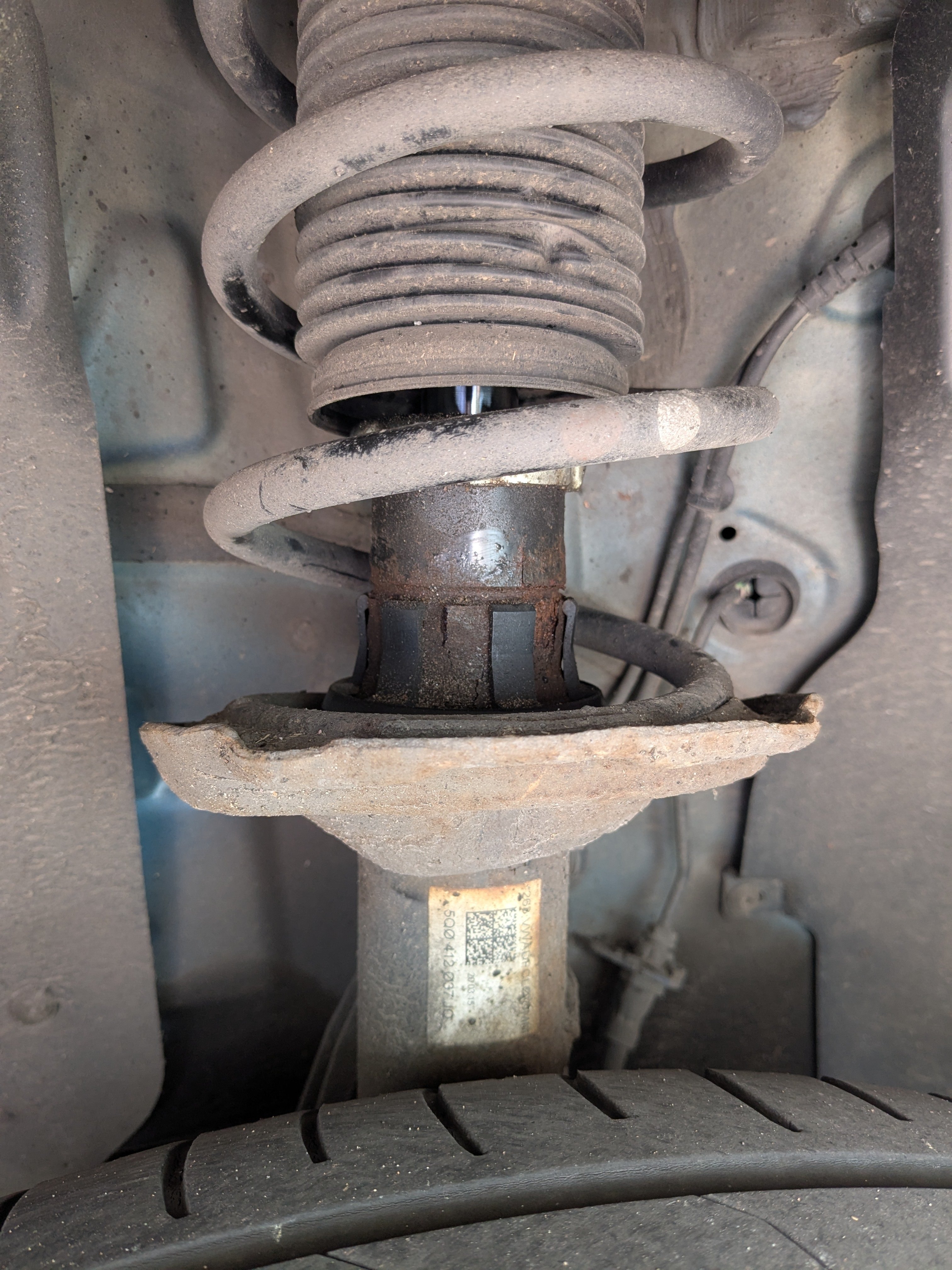

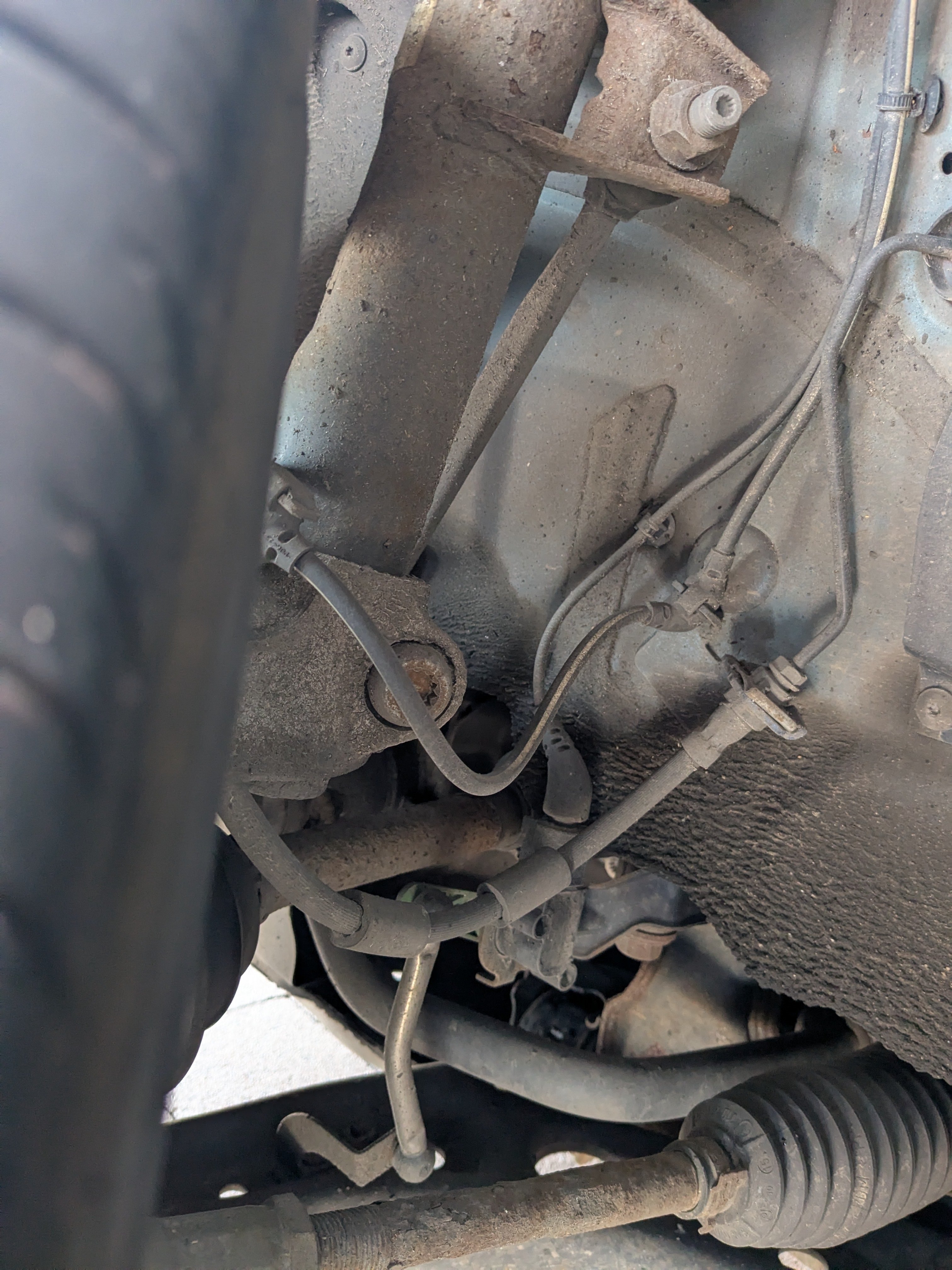

- Does this shock need replacing ?
Hi all. Got car serviced today. Mechanic advised that front offside shock needs replacing due to a leak so recommending both fronts be replaced. I took a look myself. It seems bone dry with the exception of what's in the pics below. Would this fail an MOT/NCT? It looks as if it's only a few small marks - I was expecting an oil stained mess. Any advice/opinions? Skoda Octavia RS Diesel 2015

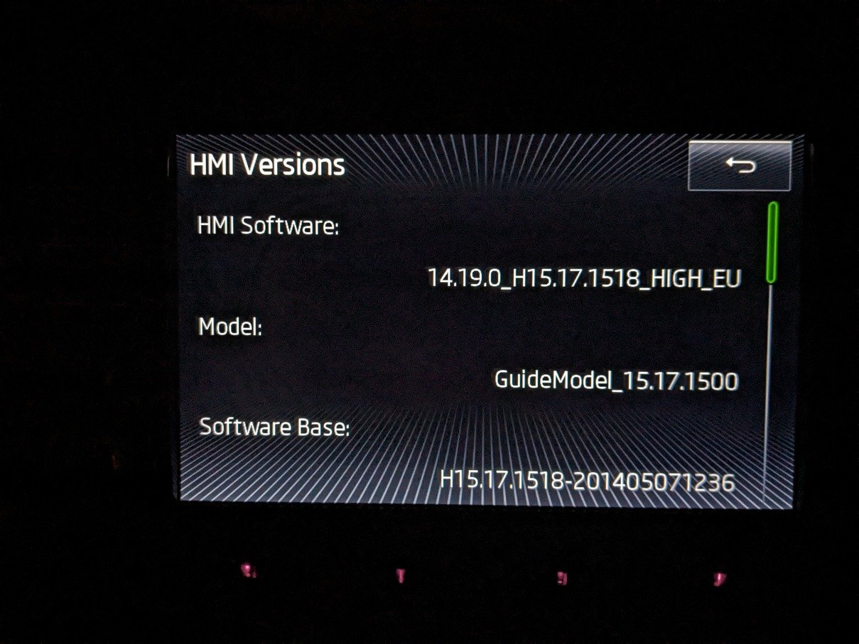

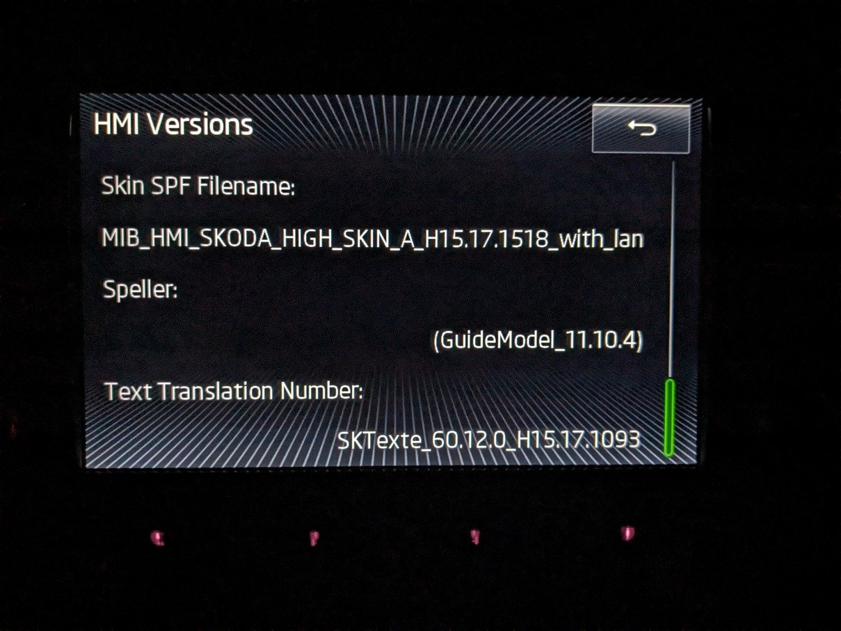

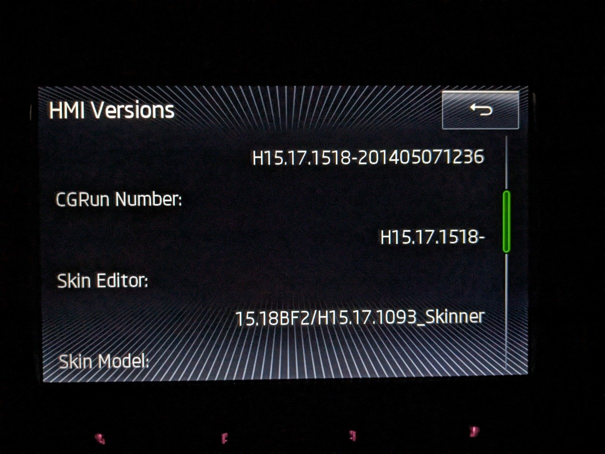

Help needed with updating the Sat-Nav maps on Columbus system
I have an MIB1 Columbus system (MIB1 High) - I think last year was the final year updates were released for this model but I'll leave it to my learned colleagues here at Briskoda to clarify. Wouldn't mind being able to update the maps again. Previously I've only ever updated the entire EU pack as I didn't want to disturb anything but I do agree that we should have the ability to update specific countries alone for ease of use.

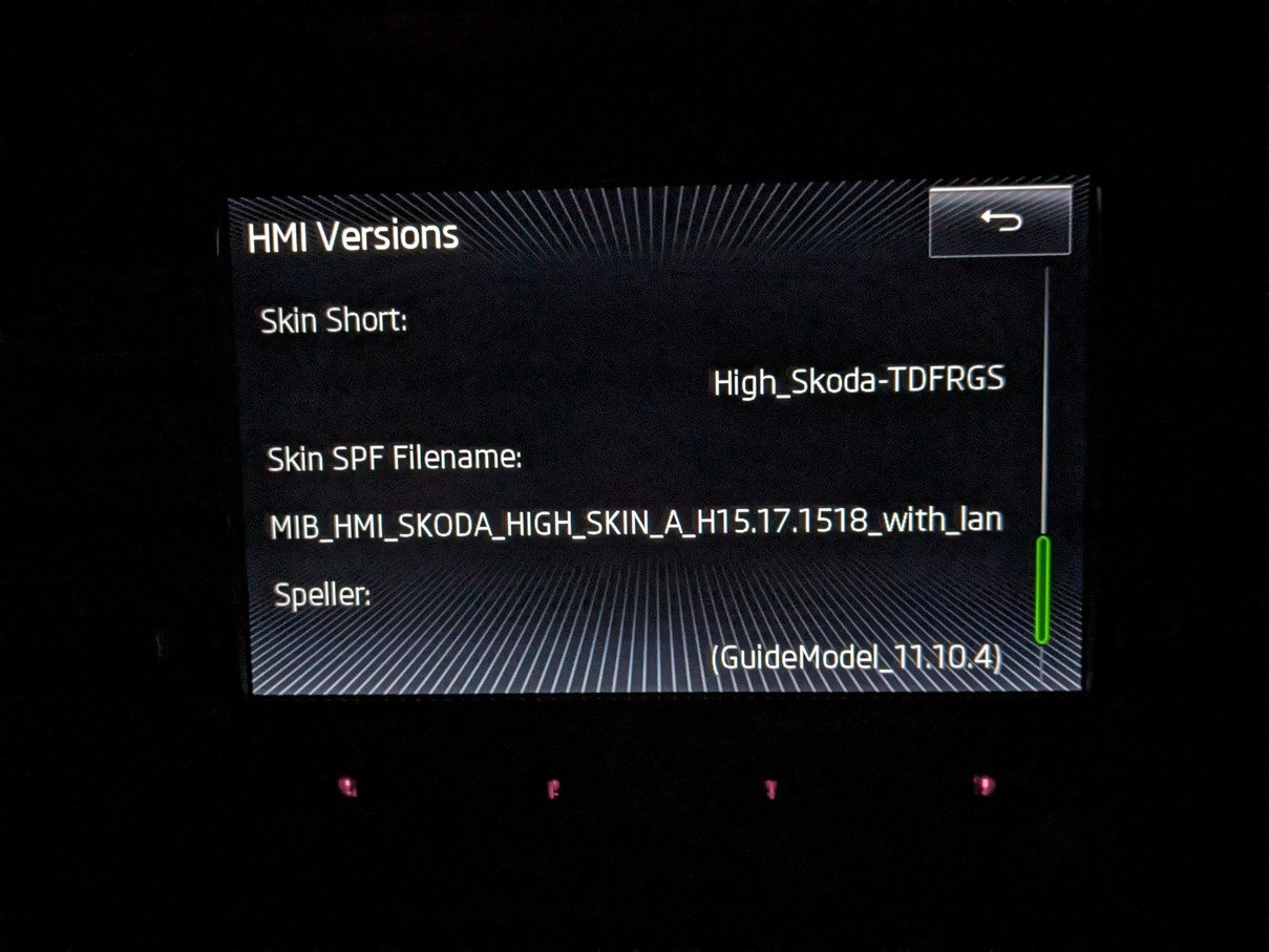

Columbus mib1 0409 firmware
Hi all, Just wondering if it's possible to downgrade my firmware - I updated to 411 on my MIB1 Columbus and Canton but now there's an active static or analogue hiss when the radio is muted. I'm concerned the update could have done it - and whether downgrading might fix it. Thanks!

Hi all, I hope I haven't dug myself into an expensive hole so I'm hoping you can help - Earlier today I took it upon myself to install the latest firmware 0411 on my Columbus MIB1 with Canton. When returning to the car this evening I couldn't help but notice that, when muted or on a low volume, I can hear a static like 'hiss' sound. I don't know if it's related to the firmware; but after hearing this issue I scanned with OBDeleven and got the error 'B201A00: Checking software version management' which apparently relates to the Canton AMP - I followed the process on mib-helper and cleared it via OBDeleven and unfortunately, even though the car no longer reports any errors/issues on rescan, the hiss is still there. Is there something I need to do to readjust the Canton system given that I've updated the firmware? Can I even revert it back to what it was previously on? I literally have to turn off the radio to get the noise to stop. Thanks for your help as always guys - I'm pretty annoyed at myself and should not have gone near the system as errors/glitches were rare on it before this. @pab567 @varooom - would you have heard about this?

Another question to Tell and others in the know - Having installed 0411 on my Columbus MIB1 with Canton I couldn't help but notice this evening that, when muted, I can hear a static like 'hiss' sound. I don't know if it's related to the firmware; but after hearing this issue I went about fixing the B201A error and cleared it via OBDeleven and unfortunately, even though the car no longer reports any errors/issues on rescan, the hiss is still there. Is there something I need to do to readjust the Canton system given that I've updated the firmware? I literally have to turn off the radio to get the noise to stop.
