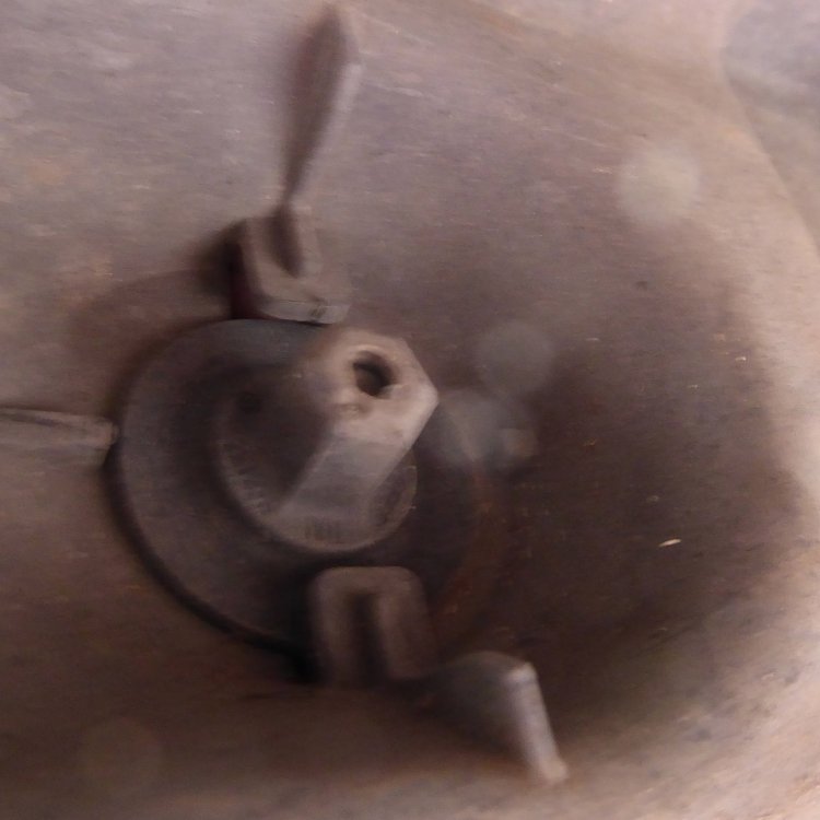

There is an annoying noise from under my Karoq floor. It sound like a stone is trapped between the metal floor and the underfloor cladding, so that when I go around a corner, or accelerate or brake sharply then I can hear it rolling around. I've lived with this for quite a while but it's now getting irritating. The underfloor cladding appears to be held on by some plastic nuts (see photograph). Any idea on how to remove them without breaking them? Indeed, any hints on how to remove the underfloor cladding? Next project is to track down the dashboard resonance at about 2,000 rpm, but one noise at a time......!
