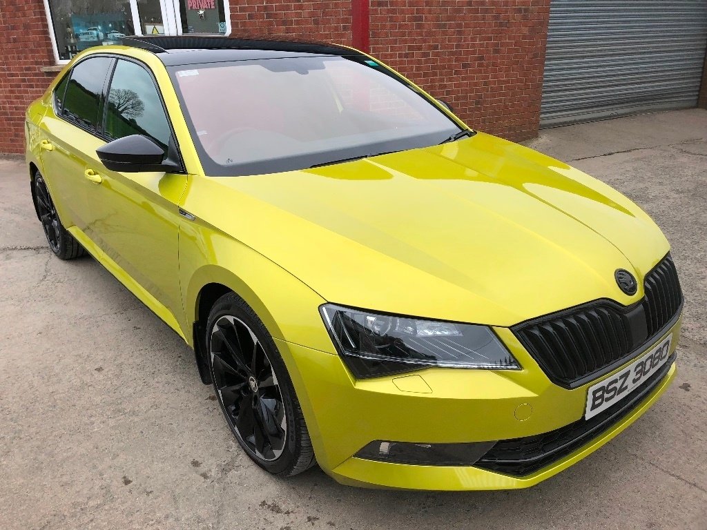

  6. Hi, I really like most aspects of my 2017 2.0 DSG Superb Sportline, which I've had 5 years now , except for the ride and the road noise. I 've already replaced the front Adaptive shocks with Bilstein one's (cost 850Euro ) after only 100,000 KM, that has helped for sure, they are well better than the Monroe's. But I find even in comfort setting its, too noisy and too rough a ride, very v bump sensitive. I had a standard superb on loan recently and it was way better. Comfort is king! I was thinking to replace the rims with 18s (or even 17s prob not as they looks poor) but then was wondering if I could go to a 45 tyre to give a bit more tyre between car and road on the 19s. Has anyone put a larger depth tyre/tire on the 19inch rim (not larger in the tyre wide - 235 size), I'd be happy to go 225/ 45/ R19 - would that fit? Seems to be lots of clearance around the wheel. The 40 to 45 difference would be marginal but it might just make it a bit better which would do me, for a zero outlay. Rim replacement involves messing with the tyre sensors etc. Any help would be greatly appreciated thanks. BenG.
