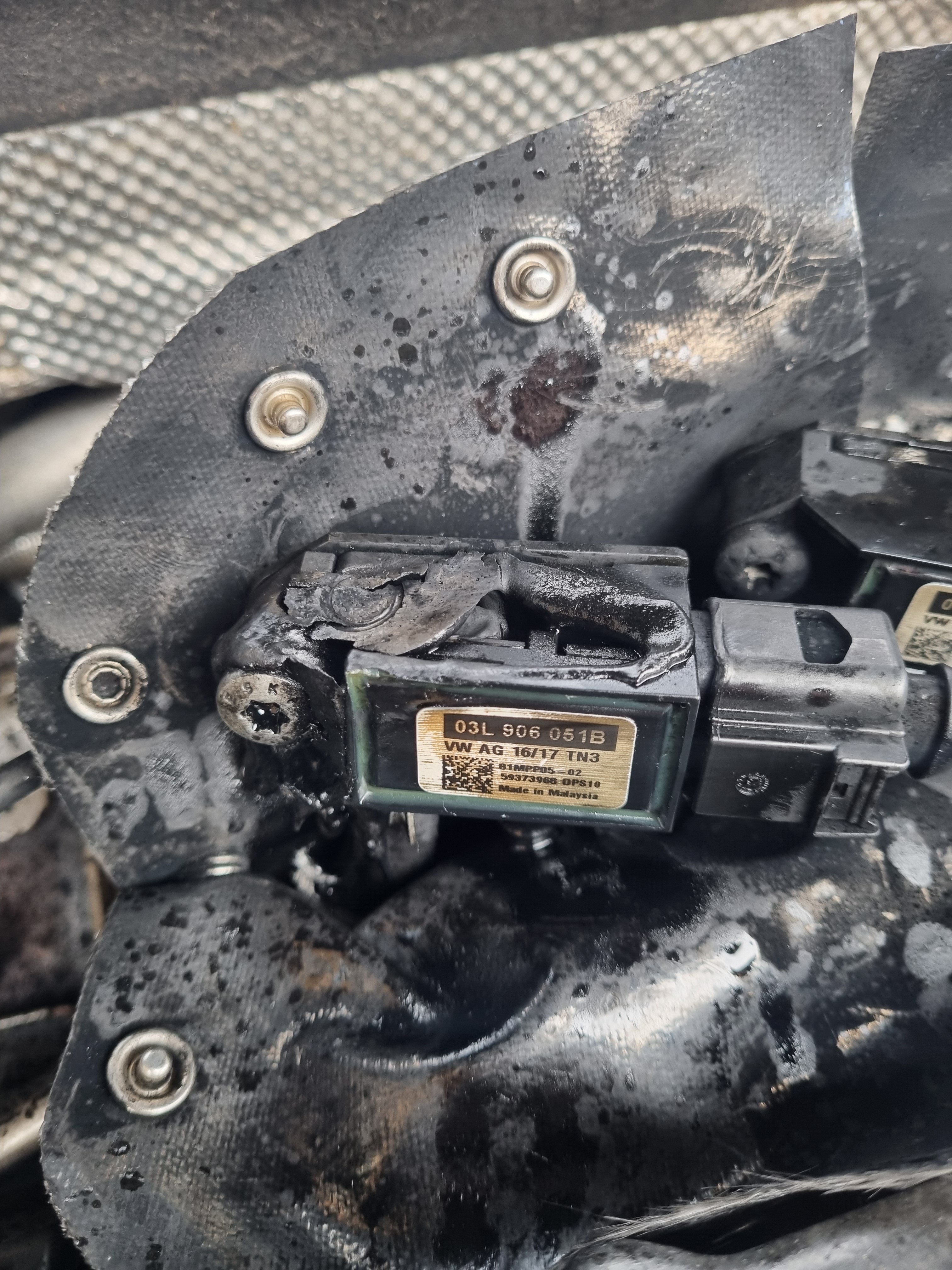

  4. Update: I rang around a few dealers today to enquire about this part. The latest revision now is D so the code now reads 03L 906 051D £104.76 ea. but apparently it doesn't require any coding/adaptation with your vehicle.

  6. Hi I cleared the fault easily with OBD11 and curiously it hasn't come back despite the state of the sensor. My concern is more about the ECU losing track of the DPF status if I just go ahead and swap sensor. Some say that not only does it need adaptation but if you don't do this before you start your car you have to buy a new sensor. I'm hoping none of that applies but need to be sure before I attempt a DIY sensor change. £70 for the part from ECP but it'll probably be double that at Skoda, fitted.

  8. Hi I have a 2017 Superb Diesel LK and I had a cam belt change at a dealer about a month ago. 2 weeks later I get a engine light on the dash and after using OBD11 it pointed me to the DPF particle filter pressure sensor. Semi melted mess as you can see in the picture. If I changed this sensor do I need to do anything else? I can't see a setting in OBD11>Engine>Basic Settings>Adaptation of diff pressure sensor particulate..... Others have seen this but after some research I conclude one of the following is true 1. My car is 2017 and therefore the above doesn't apply 2. I need to fit the new sensor first then perhaps the item shows up on the app TIA. I don't really want to take it to a dealer as its a simple part to change but will if I have to.

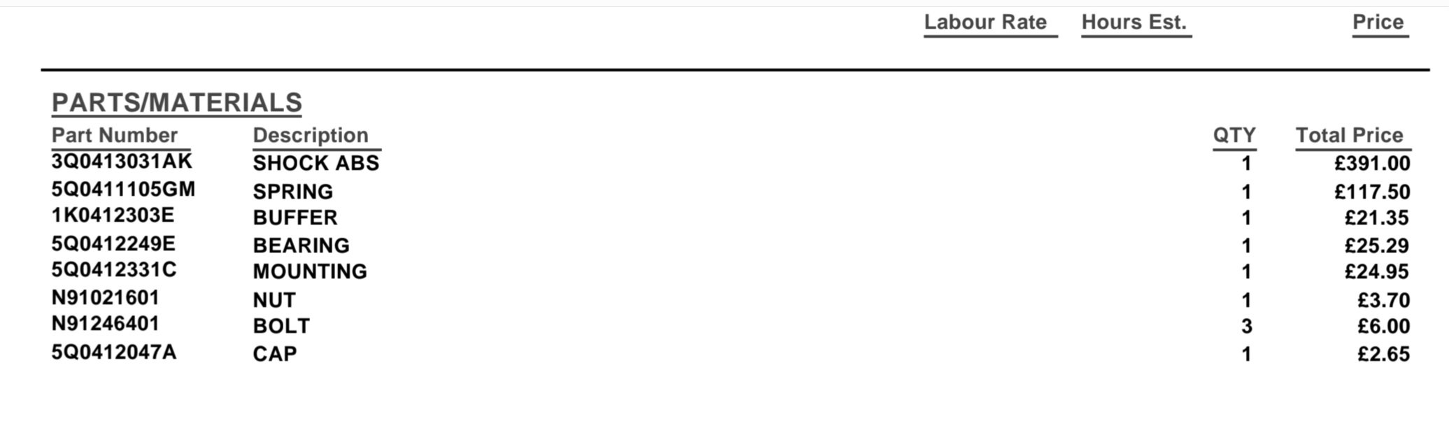

  10. I forgot to mention the stabilising rods that were recommended to change , that was part of the Eurocar part bill
  11. Monroe DCC Shocks were £130 each from GSF, (£260 total) Springs, top mount, bearings, dust covers, came to about £330 from Eurocar parts. I couldn't see how I could do it much cheaper tbh, I think it must be inflation since you did yours last.
  12. Do you have a description or part number for the Allen key? I have the spreader tool to get the shock out of the strut ( unless you mean something else)? I got this list from my local dealer but sourced the parts from elsewhere for obvious reasons. Actually not everything, I got top strut mount with bearing, springs, shocks, dust covers, and stabilising bars, think about £600 so far , plus about £200 worth of new tools. I assume the buffer is the foam stop you mentioned
