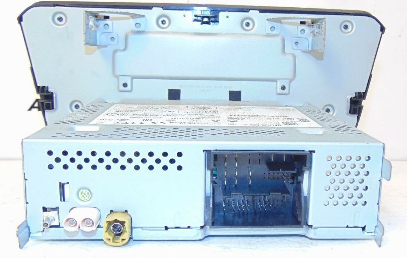

  6. Thanks for your input @MarkyG82 You are correct - I don't currently have a unit in the glovebox. The cables that would run to the back of the glovebox unit currently run to the back of the big one-piece unit (attached image) which correlate with lots of the connections on the back of the Amundsen glovebox unit I've bought (other attached image) and display unit (last attached image). The big rectangular one is pretty obvious. The yellow one should be the same, as should the double white one. My guess is that the pink connector on the glovebox unit will connect to the back of the display (I need this cable). Not sure about the round blue and black connectors? Presumably one of them is the equivalent of the round metal connector on the back of the L53SK2 unit I currently have (bottom left of the first picture) I can see that there are some extra black rectangular connections on the back of the Amundsen unit - not sure what they're for? GPS?

  8. I've got a 2017 1.6 TDi S, which has a combined display and head unit (L53SK2 - I think it's called Swing in Skoda Speak). I've bought an upgraded head unit and display (Amundsen) which came without any cables. Whilst the main harness that connects to the back of the Swing should just connect into the back of the new head unit, I don't have the cable that runs from the head unit to the display (because the L53SK2 is just a one-piece unit). It's the one in the attached pic, and I'm struggling to find a part number for this cable (the parts catalog that this picture came from does not have the part number listed - it's just labelled "array") and Skoda are being very slow in getting back to me... Any help appreciated!
