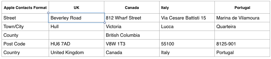

  1. Thanks for the idea, it sounded plausible so tried it with an address in France that I have that has an all number postcode - 46220 - the result was “invalid”. Any ideas if there is anywhere that could answer Amundsen problems, not necessarily VAG group?
  2. iPhone 13 links to Infotainment via ApplePlay no problem. Press Contacts button to navigate to the address and the alphabetical list appears. Scrolling down to desired address and pressing gets "Invalid Address". Apple Contacts address format is identical to Amundsen so why won't it work? Yesterday I sat for an hour with the 'Techy" at local main dealer playing about because it looks as though it should work. I have a few overseas addresss in my Contacts and we found that Italian addresses worked but English, Portuguese and Canadian addresses were "invalid"?????? Has anyone any ideas?
