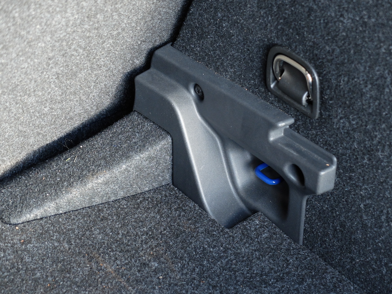

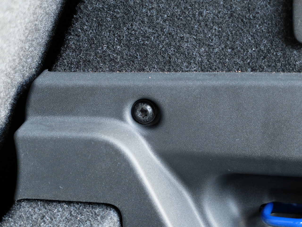

Here we are.   There appear to be no fixings to the boot floor, so there are just the four fixings all old, two through each of the "rests", one at each side.
Max weight for the floor to take is 75kg if I remember right.
Hope these help.

"Rest", one per side
Attachment method, two per rest

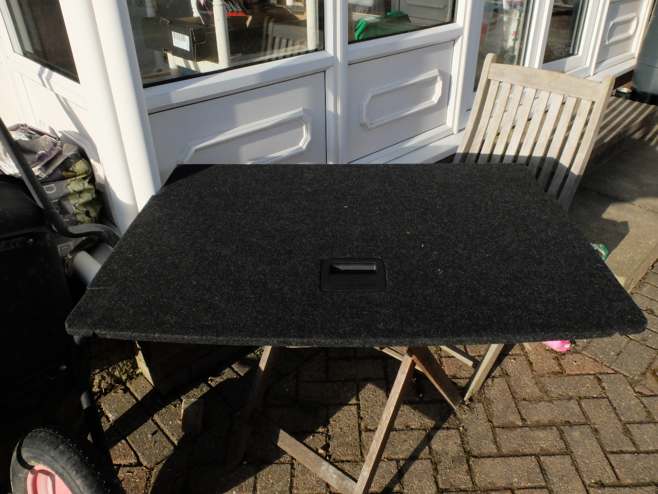

Right, here are some measurements.  I've done them in Imperial as they are easier to read for me than metric.  I hope that doesn't pose any problems.
It would be sensible to check my measurements for yourself before you start measuring out or cutting materials.
The photos I included in the thread earlier on may help you understand the measurements.
The area you are wanting to cover is not square, so some fine tuning of shape will be needed.
Here we go.
Front to back: centre - 27 9/16ths; edge - 26 3/4s.
Side to side: front - 39 5/16ths; back 39 1/8th
There is a hinge 6 1/2 inches from the rear edge of the raised floor to allow you to lift it up for access to the space below.
For the height of your supports at the rear, measure up to the bottom of the lip behind the hatchback catch.
I hope this helps.  Let me know if you need any more info.
