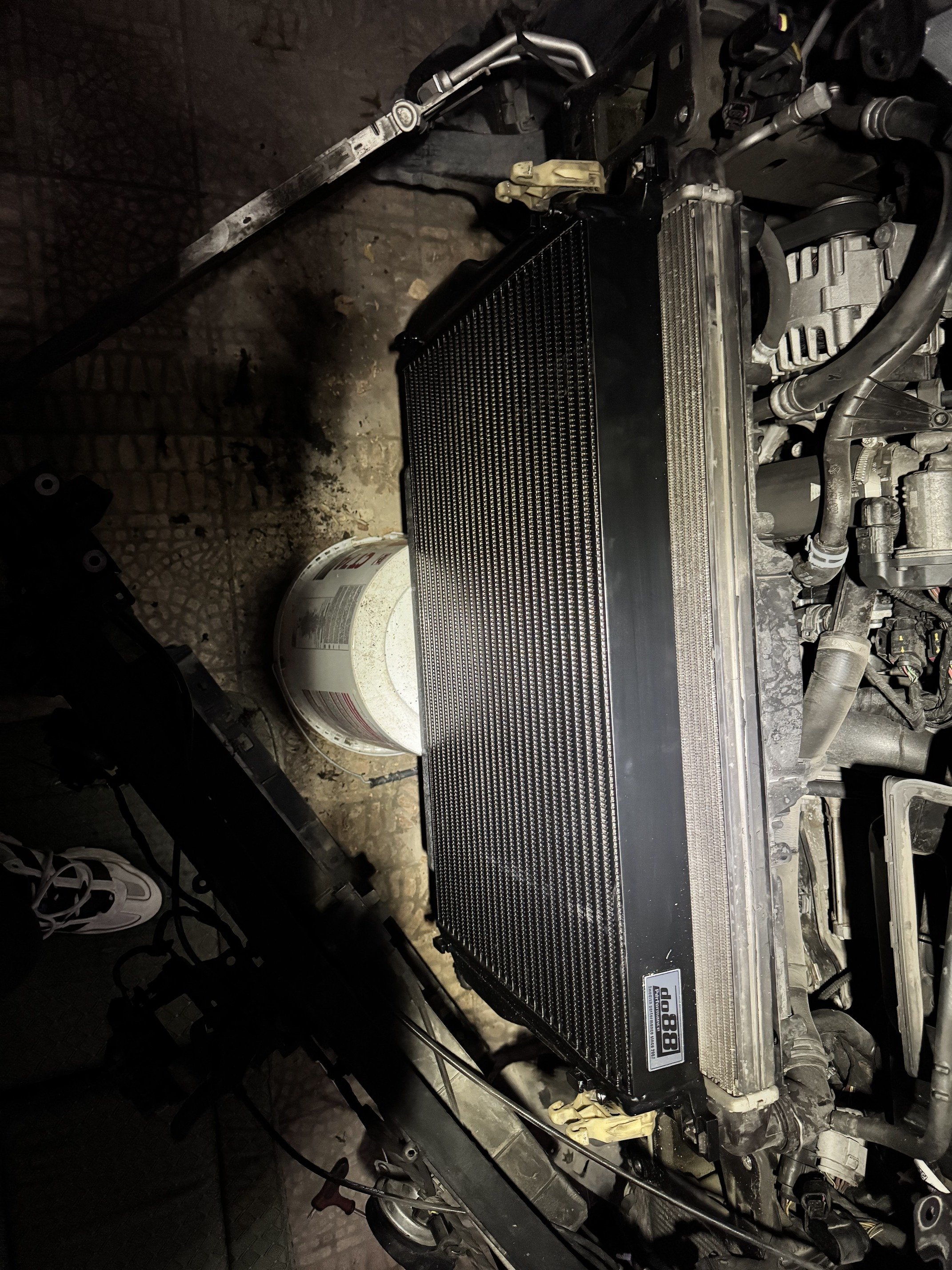

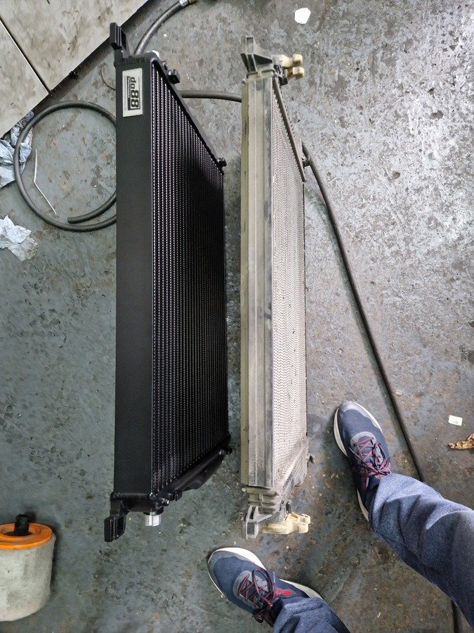

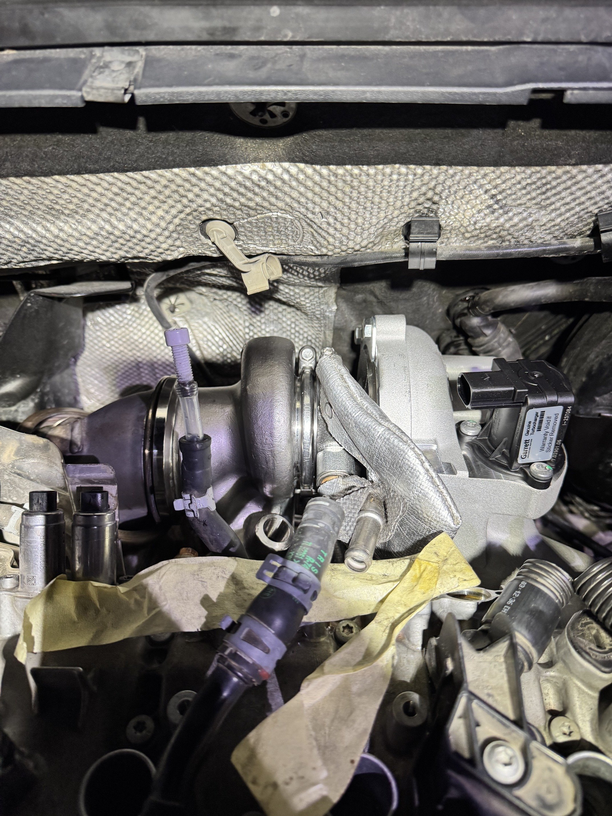

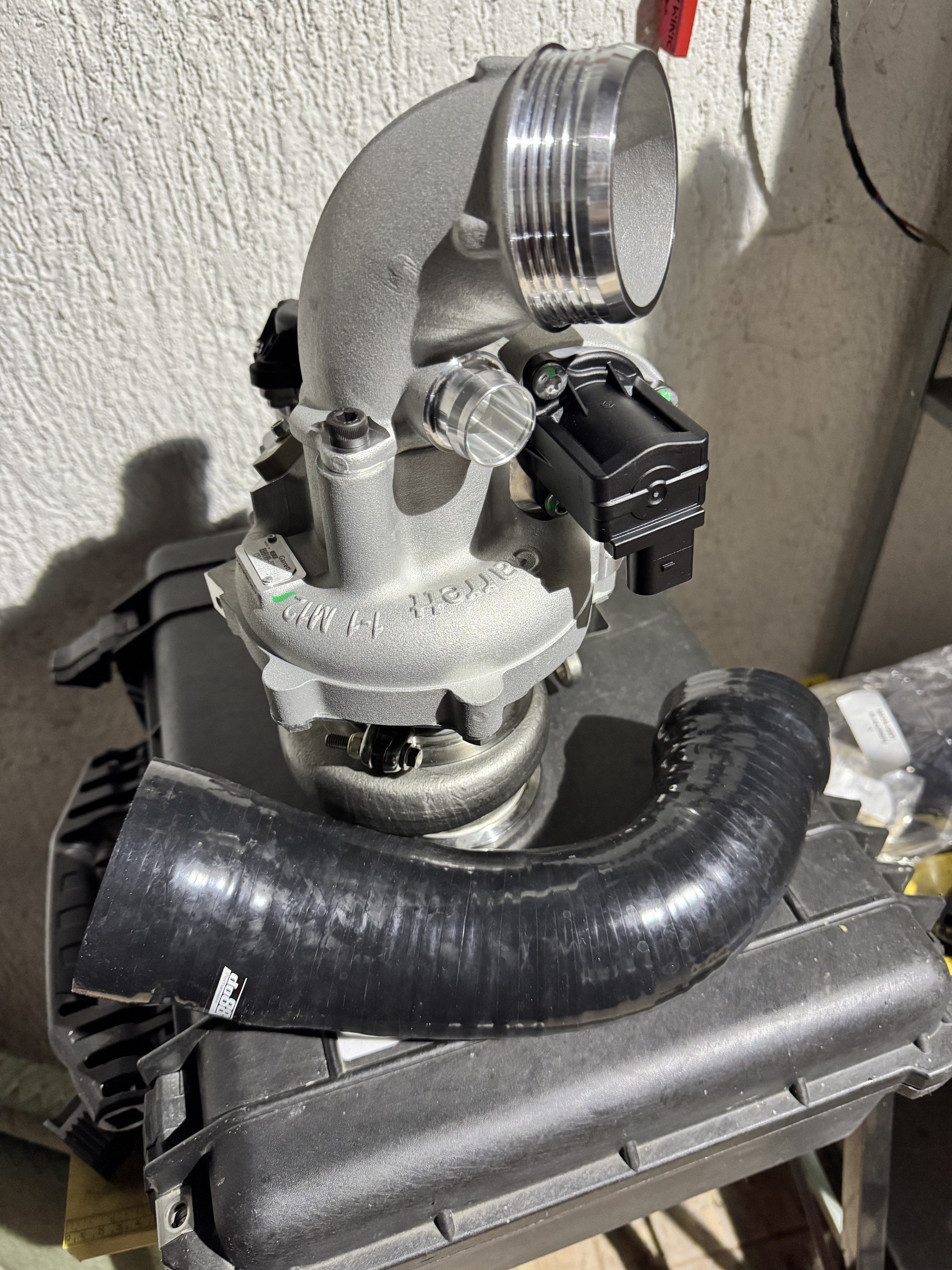

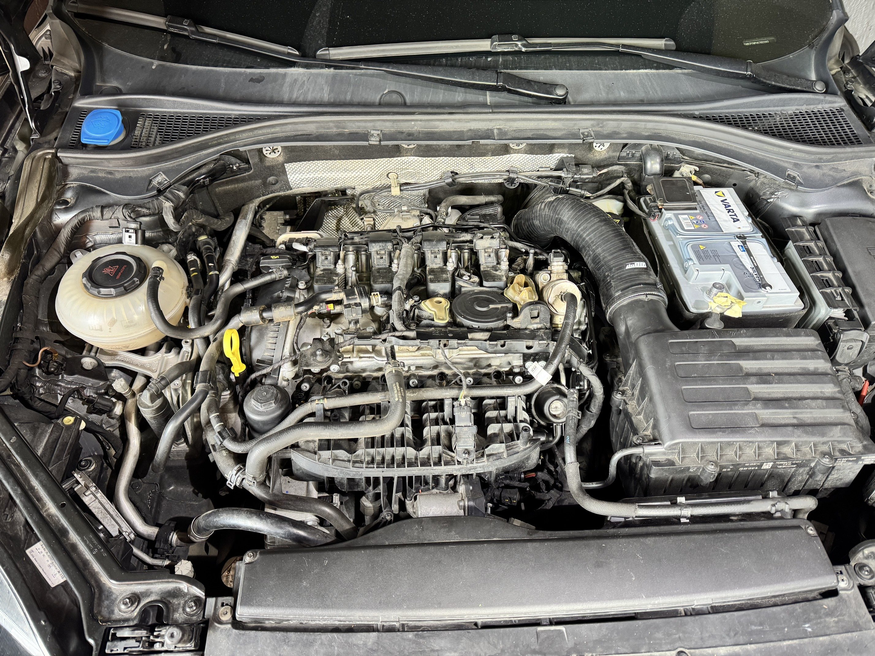

  2. For those who had their doubts about stock fueling, this is the current situation. I think this is 400+ hp at the moment, tune still in progress.
