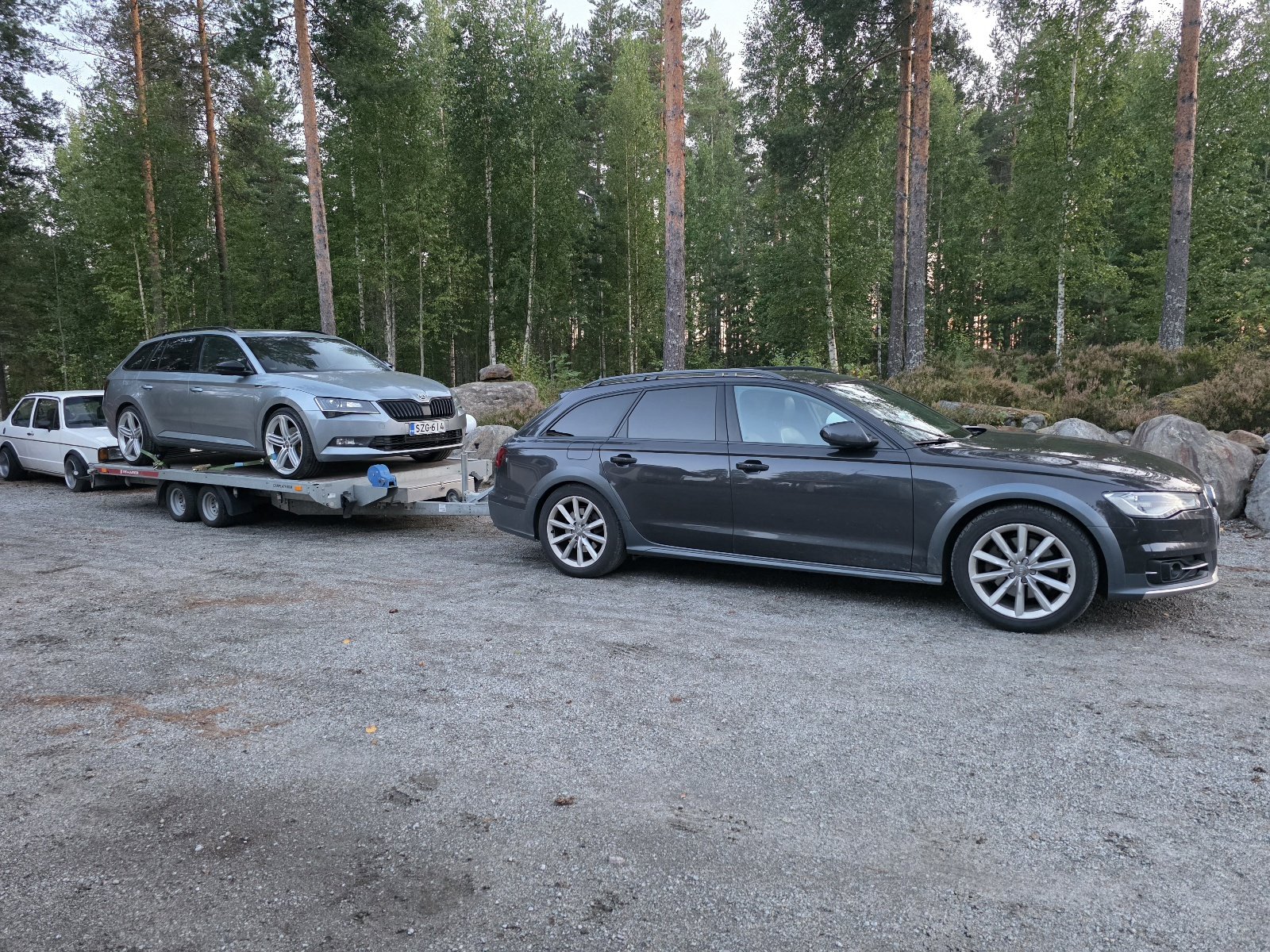

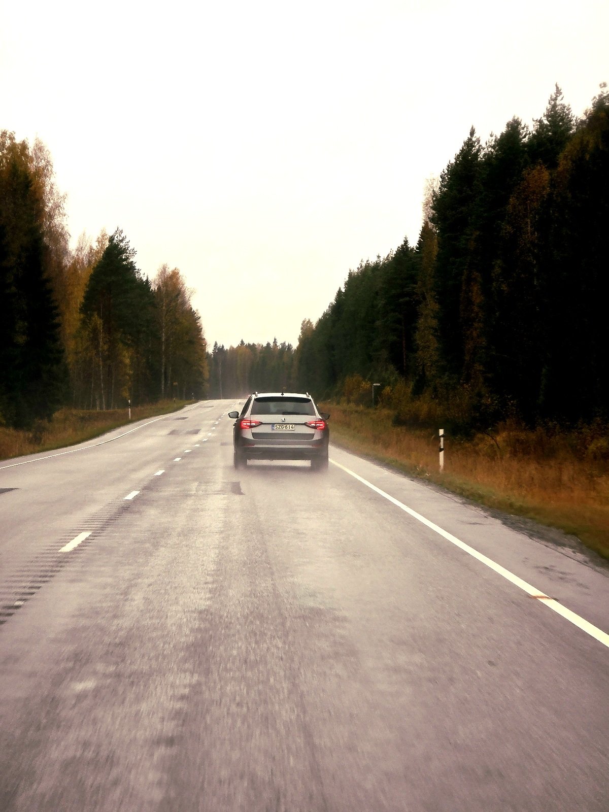

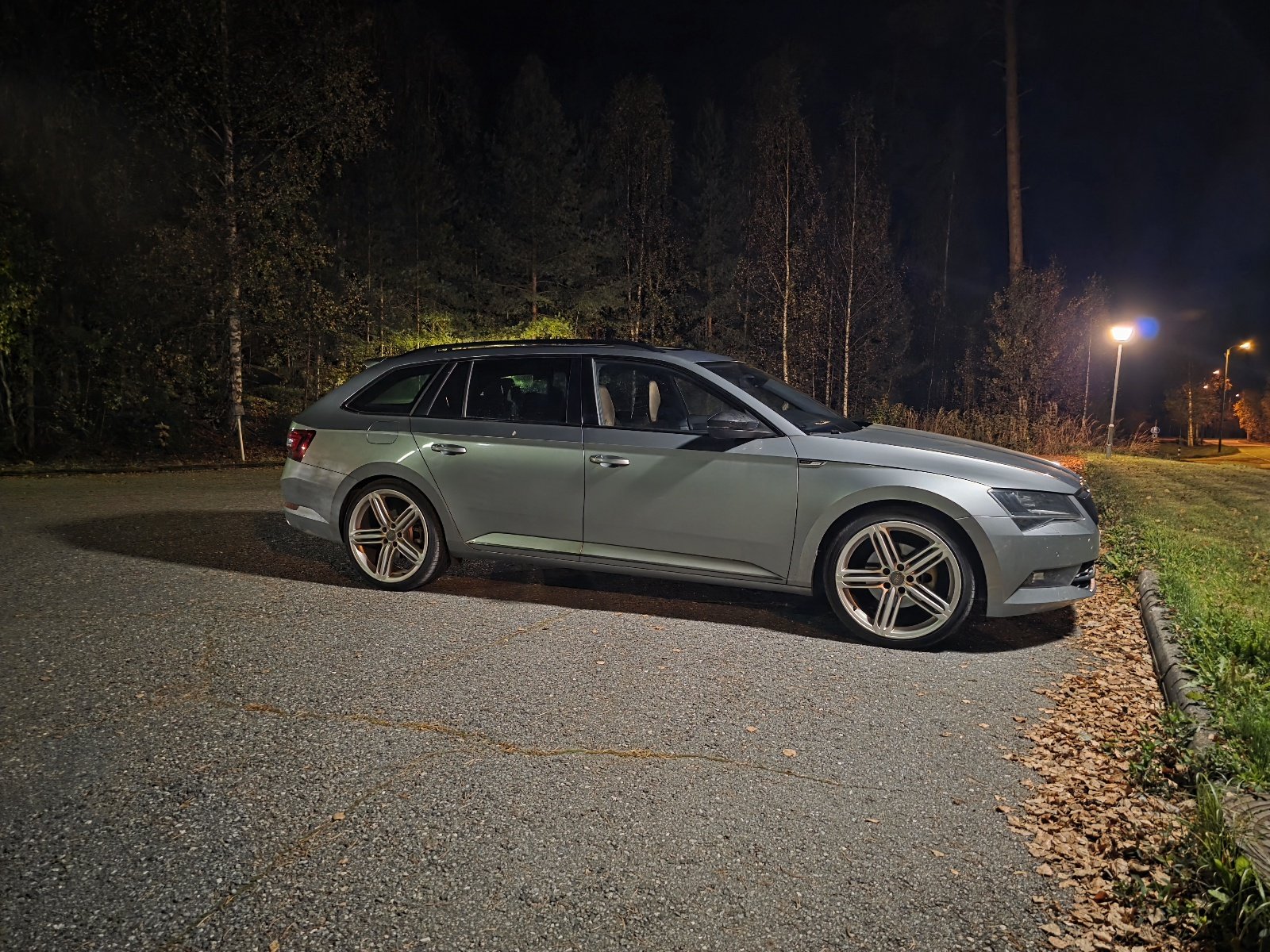

  1. Sorry guys for late late reply, but as I promised here are my results; I went with Sailun Atrezzo zsr2 245/35R20. I drove with this setup couple thousand kilometers without any scrubbing with the standard sportline dcc suspension. Highways, windy roads, gravel roads, by my self and with my family of five, no problems. Unfortunately time to depart came before I had time to try the lowering springs. Car was undriveable for three months due to sensor failure in the machatronics, eventually the whole mechatronics needed to be changed. After it was fixed I (read wife) decided that it was time to move away from estate cars. Couple pictures from the final days.
  2. Nice, But the hardest part is to keep it looking like that, especially with three kids. Ask me how I know it 😉
  3. @JR RS Thanks! I was sure that there will be no problems with the rears. Need to swap the wheels to rear tomorrow. During this evening (in Finland) I have read some German forums and they suggesting to go with 235/35R20 if there are plans to lower the car. Just wouldn't like to have that much stretch on tires.
  4. I see our point and understand it complitely. Still for some weird way I'm really facinated to to try them 😉 Ride quality has always been a sencondary thing for me, but still wouldn't like run 30 profile tires.. And haven't made up mind that if I can't have both, lowering and those wheels, which one should I choose.
  5. Had to try them on. Unfortunately only two of the wheels had tires on, so I was only able to fit them to the front axle. Driving around the yard I couldn't make them rub, even when I tried to turn on top of pumps etc. Ofcourse the car is currently sitting on standard sport line DCC. With Eibach or H&R kowering springs it could be a different story.

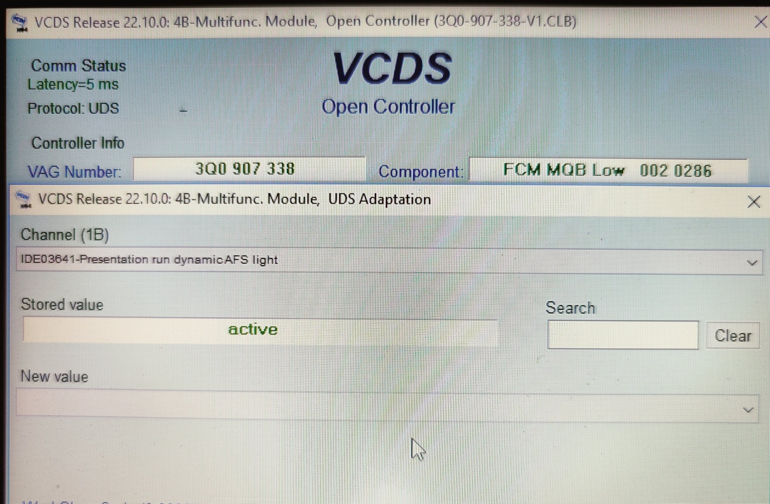

  9. And a video of the new "dance". Ps. Corner of my garage was not the best place for presentation. VID_20221203005704.mp4
  10. I think I got this! On vcds go to Multifunc. Module -> Adaptstion and change "presentation run dynamics..." stored value to "active".
  11. Interesting, maybe I should ask about this from Skoda. To me the lights are functioning as they should while driving. All though they could be a little bit better overall. But my opinion is that all of my VAG concern cars have not had the best lights. Just for the look of the full start up sequence, I would like to have it on my car 😎
  12. Hi Folks, I am facing the same problem. Only partial dance on my -18 sportline with SLA. Did anyone get this mystery solved?
